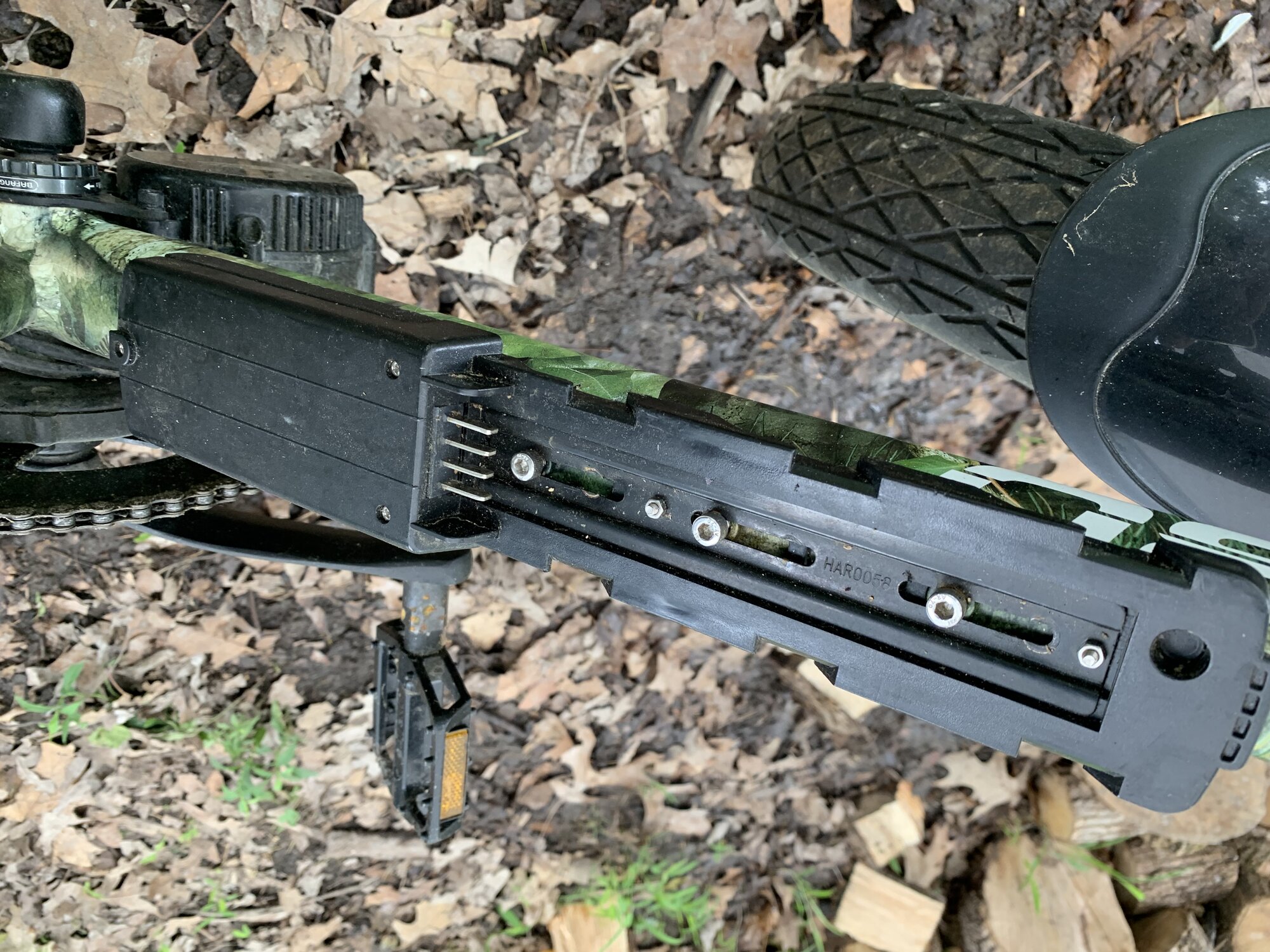

I picked up the battery from the archery shop this morning, brought it home, opened it up, and immediately realized the spare battery Rambo sent my archery shop for my e bike last summer is the wrong style battery.

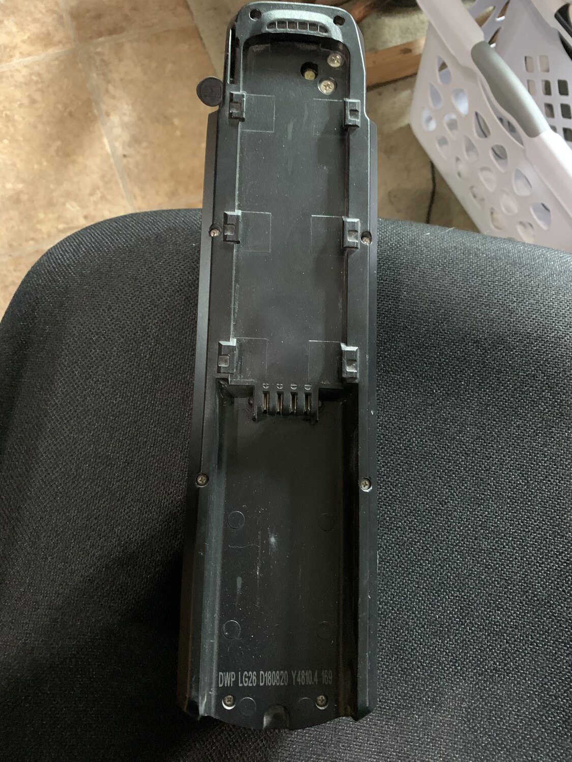

This is my original s039 type battery and mounting plate:

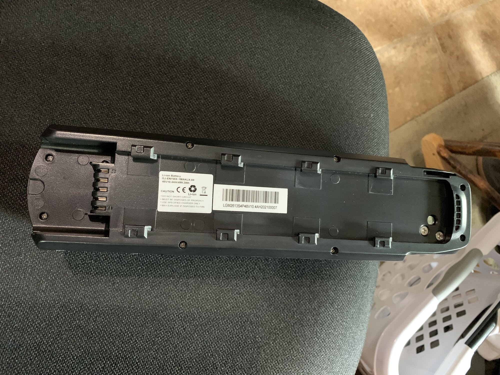

This is the battery I just picked up. It’s a r049-2 (or YW 5 pin) type and obviously won’t fit my current mounting plate.

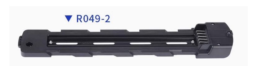

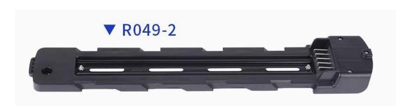

Neither did it include the correct r049-2 type mounting plate, which looks like this:
The batteries are the exact same external dimensions.
How hard would it be to swap the internals of the new battery into the original battery case so it would work with my current mounting plate?

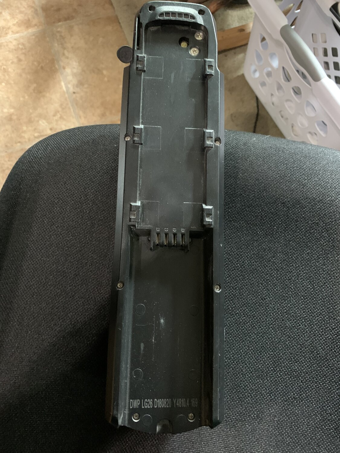

This is my original s039 type battery and mounting plate:View attachment 91044View attachment 91045

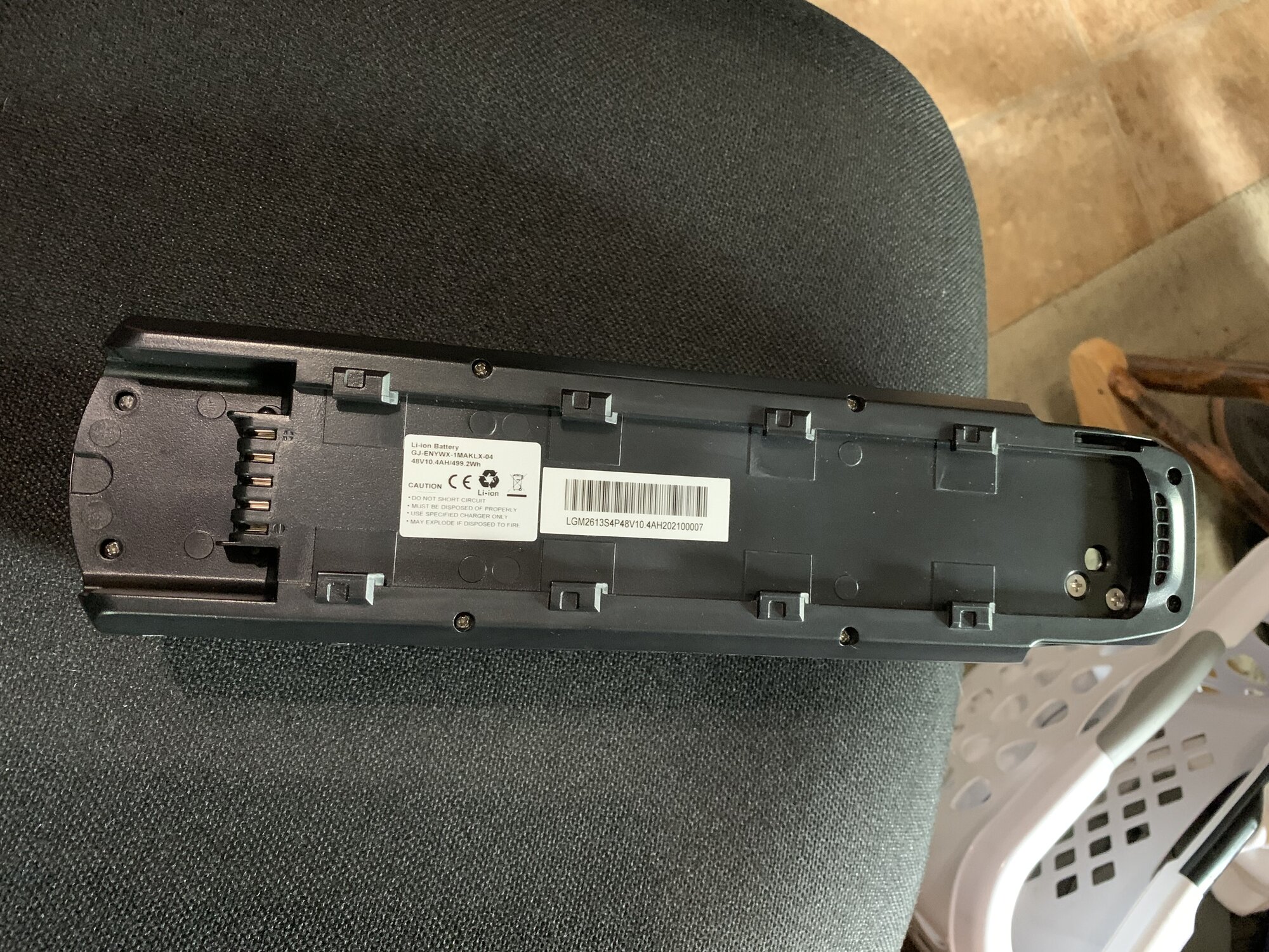

This is the battery I just picked up. It’s a r049-2 (or YW 5 pin) type and obviously won’t fit my current mounting plate. View attachment 91046
Neither did it include the correct r049-2 type mounting plate, which looks like this:View attachment 91047
Much harder than buying the correct mounting plate 🙃
Yeah, I finally found the correct mounting plate on eBay. Of course I could also buy that spare battery I’ve been talking about and it will come with the correct mounting plate
Then I could try to revive the old battery Ibarra later.
All is possible.. at least to try.
But I'd get a new mounting plate way before I tried to swap battery internals. If you ever opened one up, everything is neatly and tightly packed in there.
