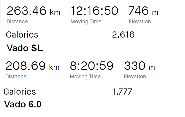

@miscon1618:
Not sure what you are doing wrong.
I ride:
  • A Specialized Turbo Vado 6.0
  • A Specialized Turbo Vado SL
I use a Wahoo Roam 2 paired with either e-bike. Although I owned a Polar wrist HRM (and it worked perfectly), I stopped using it because my medication control my HR (cap it).
Here are two metrics I'm getting from e-bike -> Wahoo -> Strava:
I was using a solid electric assistance for both rides, so the kcal figures make sense.

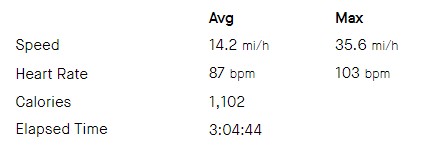

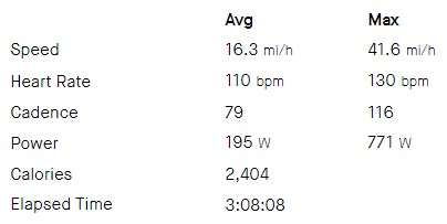

a strava summary from a data file with power looks like this :
the calories is very simply the result of the time and average power. it does not matter how fast your heart beat, really, what matters is the amount of work you did in turning the pedals.
a summary which doesn't have power, like this one, estimates the calories from heart rate and speed. you can see in this case that although the ride was the same length, and a couple mph slower, and the average heart rate around 20% slower, the calorie estimate is way less than half which is simply not correct. no power meter on that ride.

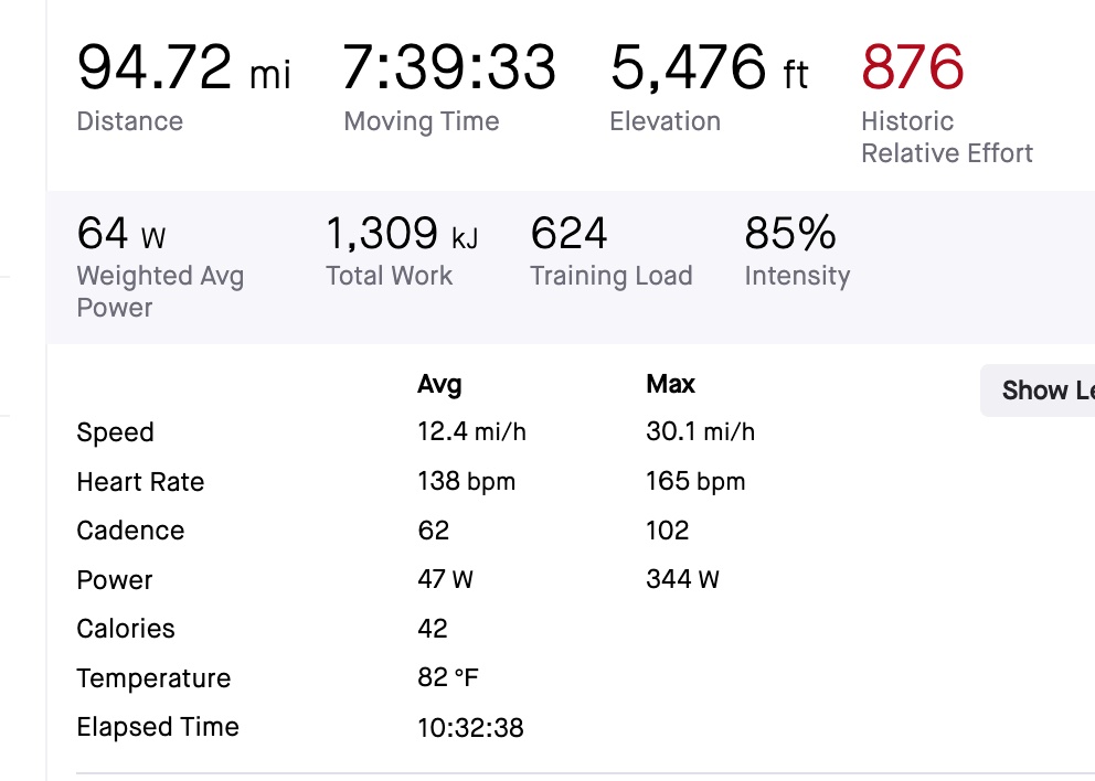

I really appreciate the insight you provide. I took a look at my Strava data and here is what it shows:
Based on 47w x 7.6hr x 4 = The calories should be near 1429. I'm still baffled about what 42 shows up.

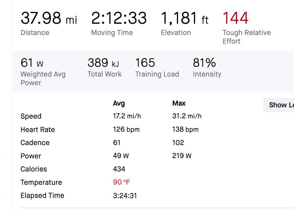

Here is the data from the ride the next day.... no equipment change.
Again.... 49w x 2.2hr x 4 = results in 431 Calories. Very close to the 434 reported in Strava.
I don't know if we will resolve this, but I am learning more!
definitely something awry with the 7+ hour one. in the second one the moving time is 2.25 hours, so 2.25 x 49 x 4 is pretty close to 434. average power is averaged over moving time, not elapsed time.
the fact that the work (kilojoules) is correct in the first one but the calories are not is really odd, some sort of strava bug. a kilojoule is .239 kilocalories, so when you add the 4x factor for the body efficiency the two numbers (work and calories burned) are close to the same. your first ride burned around 1500 calories.
incidentally, if the HR data is accurate, you were pushing too hard or too long on that long ride. the relationship of power to heart rate remains fairly fixed for a given level of fitness until you really get fatigued, dehydrated, etc at which point heart rate starts going up without your legs producing much more power. 96 miles is a big ride, even on an eBike.
