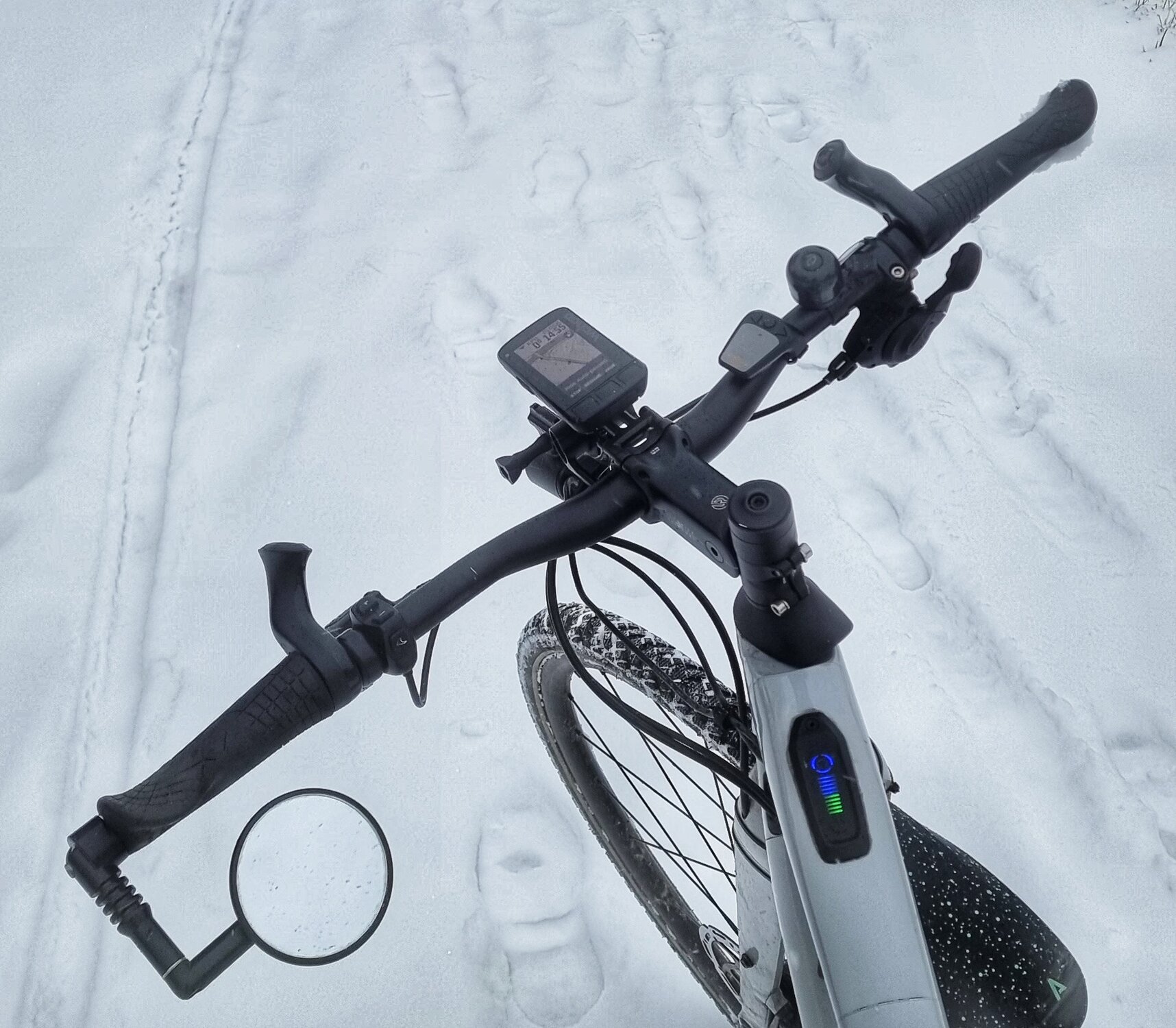

I see no reason in trimming the Vado SL handlebars. They form a valuable real estate for accessories. Why not just install Innerbarends that allow the arm spread of 44 cm, that is, same as for an average drop-bar hoods?
I have an old 10 spd steel frame bike from the early 80s I just rehabbed. After I fixed it up I took it for a ride and noticed the really narrow handlebars, don't remember them being that narrow. Measured and they were 16"! Just measured the Sequoia with drop bars and they were 20" which seems comfortable. Hopping on the Vado or Como now feels like a double wide, they are 27-28" wide!
My traditional bike of 2013 had 610 mm handlebars (24"). I stopped ridding it after two years because of my ailments.
My first e-bike came with 680 mm (26.8") handlebars. Two other e-bikes sport the same bar width. My Giant Trance E+ had 780 mm (30.7") bars. As e-bikes meant a brand new adventure for me, I even did not notice the bars could be "too wide". They seemed to be "as they should" and gave me a plenty of space for accessories as well as excellent steering capabilities. The wide bars belonged to the same new exciting category as thru-axles, 1x drivetrain, hydraulic disk brakes and other modern stuff. I embraced the modern cycling technology totally.
With Innerbarends, the hand spread became 440 mm (17.3"), same as with a drop-bar. And I often ride keeping my hands on Ergon GP2 bar-ends, with the full handlebar width at my disposal.
I simply cannot understand someone wanted to trim their flat handlebars but it is me.

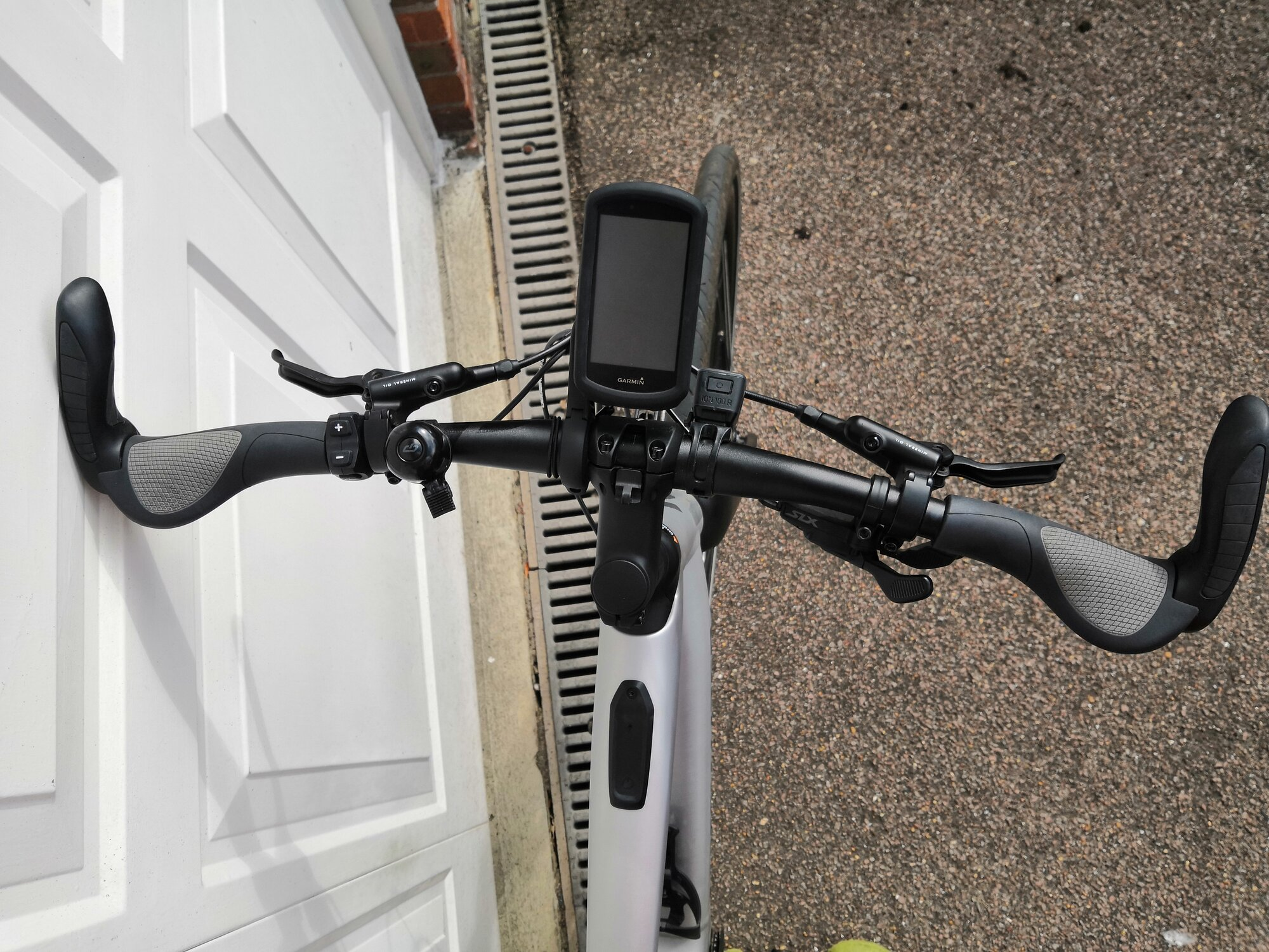

Cut 25mm from each end of mine, they are now 66cm with ergon 3 grips fitted. Find it far more comfortable and feels a more sporty ride. Before I cut them off, with a hacksaw, a friend who had a short ride of my bike, said it seemed like riding a mountain bike because of the really wide bars.
