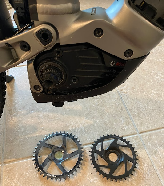

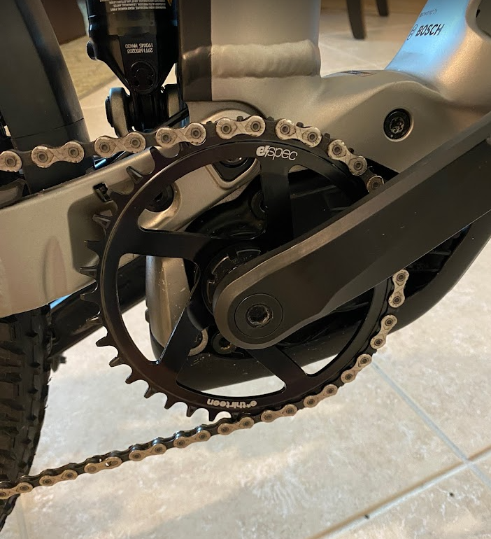

Today I swapped out the stock 36 (steel) tooth chainring for a 38 Chainring (steel) on the PF4. Looking for a little better speed per gear. 4th-11mph, 5th-13mph, 6th-15mph, 7th-17mph these are max sustained cadence speeds. Most of the trail riding is 9-13mph and paved is 15-20mph. I am seeing about a 2 mph difference over the stock 36 tooth chainring. Next ride is this weekend.

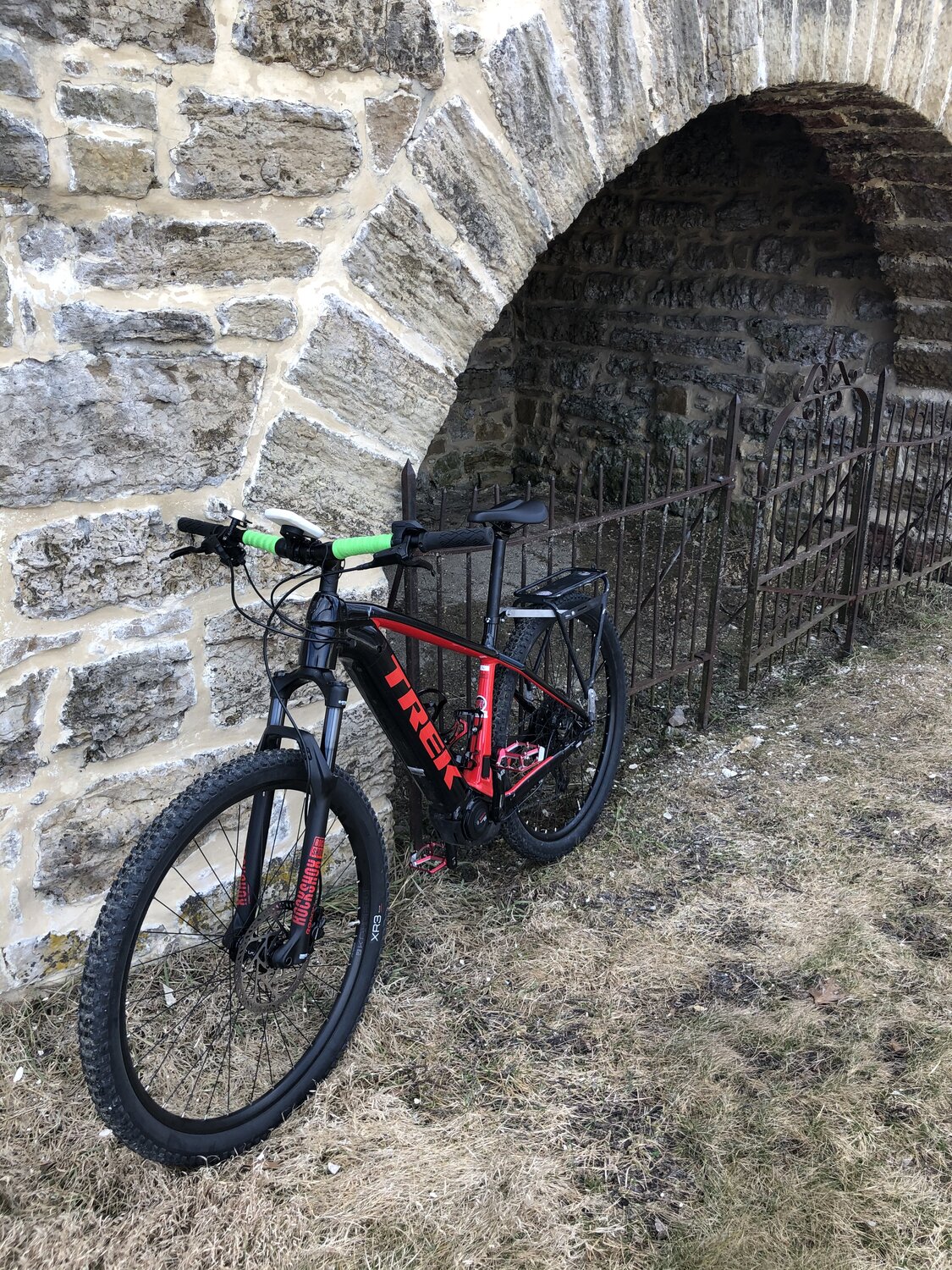

I hope you powerfly owners can help me validate your head angle. Can PF9 owners verify what their fork angle is?
I was checking the fork angle on the PF4 FS. Trek web site say 66.5 degrees head angle for all PS4 FS sizes which have 100mm forks.
PF4 FS: SR Suntour XCR 34, air spring, LO R damper, hydraulic lockout, tapered steerer, 41mm offset, oversized crown for eMTB, Boost110, 15mm bolt-on thru axle, 100mm travel
PF9 FS: SR Suntour Zeron 35, air spring, LO R damper, hydraulic lockout, tapered steerer, 44mm offset, Boost110, 15mm bolt-on thru axle, 120mm travel
I have replaced the 100mm Suntour fork with a 120mm Rockshox fork (44mm offset) so I expect it to be slacker. Trek is listing the Powerfly 9 FS which comes with a 120mm fork as 66.5 degrees head angle.
I measured the fork on my PF4 and it is 65 degrees which I expected with the longer travel. Every 20mm of fork length you gain about 1 degree slacker head angle.
I also went to a 27.5x2.6 tire which slackened the angle too.

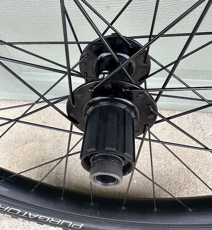

After a year the Powerfly 4 rear hub has had to be rebuilt for a second time. Water get's inside and the cassette bearings starts to rust. The hub makes grinding noises and starts to freeze up. Trek rebuilt the hub both times and it cost me $87. No more games this is BS. I had a set of DT Swiss XM481 with DT Swiss 350 hubs built. Switched the Specialized Purgatory tires for a set of Schwalbe Nobby NIC. Trek wheels and Purgetory tires are now on ebay.
Trek hub
that sucks make me worry about my allant 8. they are Shimano hubs so I wonder what's going on? I love my dt swiss hubs.
I've gone through 3 Freehubs and many hub bearings. I've also snapped the inner axle and had one made (way better)
I bought a 'compatible' rear wheel only to discover that Trek fcuks you over by changing the measurement from the end of the end cap to the rotor mounts
19 mm as opposed to 'industry standard' 15 mm. Anyone need a rear wheel?

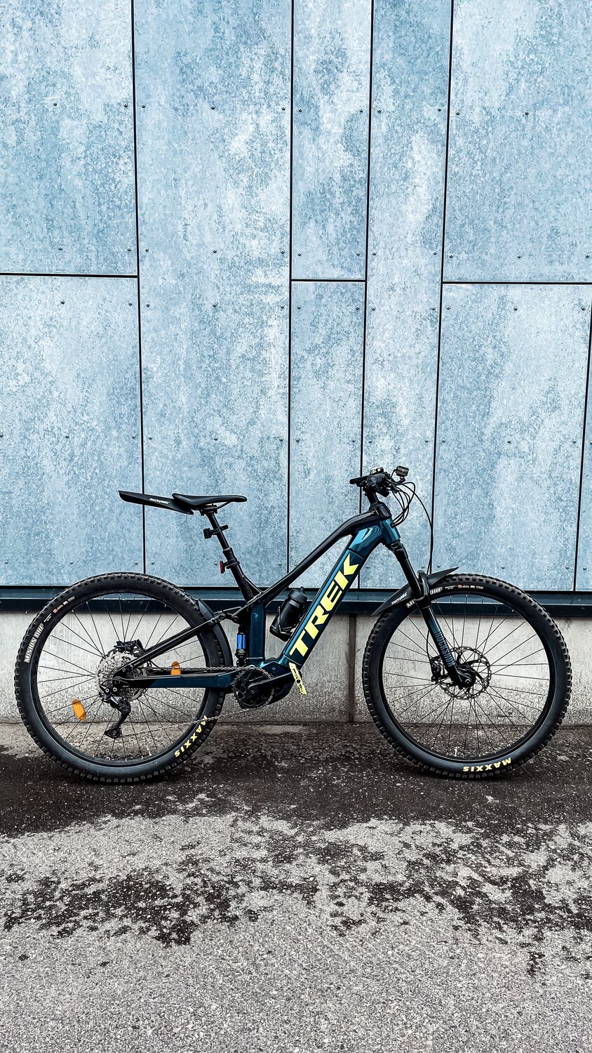

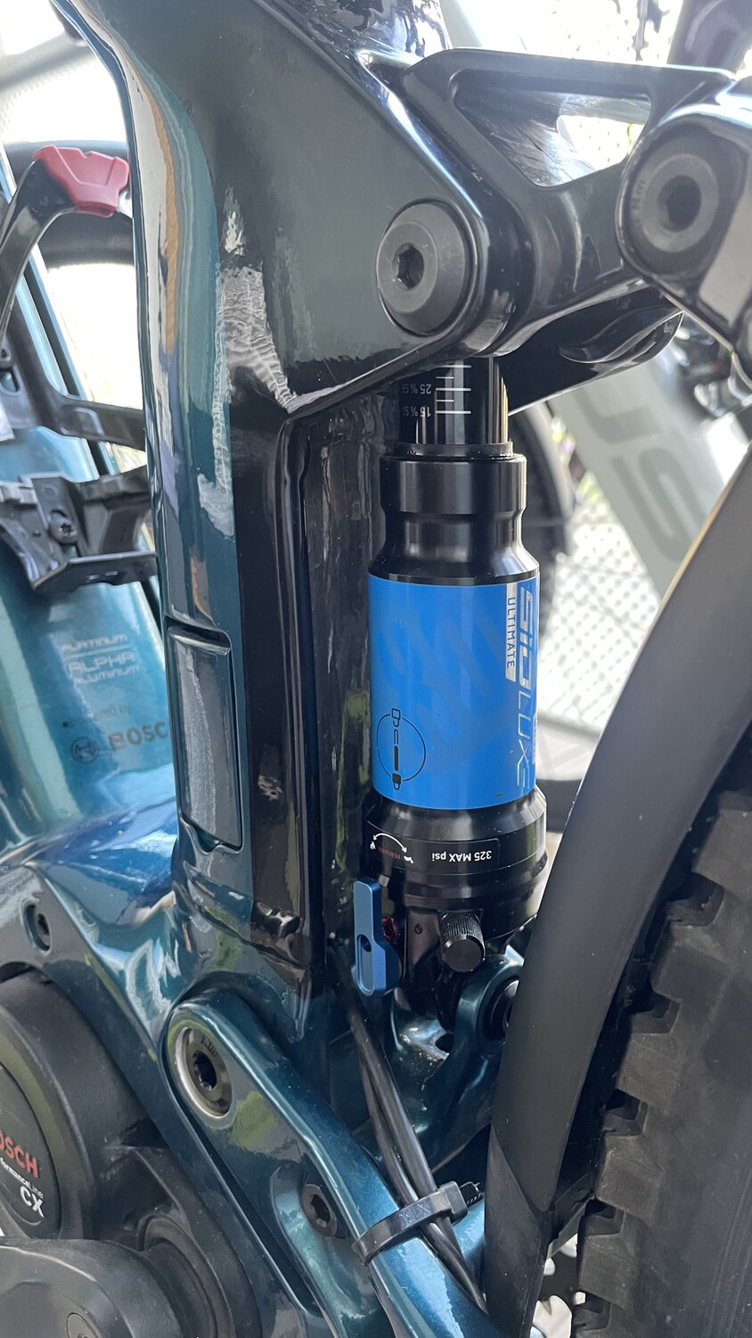

I've been really happy with my powerfly fs4 but wanted some upgrades after awhile, so heres what I've upgraded to my powerfly fs4 so far:
Front suspension: rockshox 35 gold, 150mm
Rear suspension: rockshox sidluxe ultimate, 190x45
Brakes: Shimano SLX BR-M7120, 4 piston back and front
Rotors: Shimano sm-rt86, 203mm
Tyres: maxxis minion dhf 2,6"
Front light: LEZYNE ebike Macro Drive 1000
Pedals: bontrager color matching :D
Still left for upgrade:
Wheels: mavic e-deemax
Shifter: sram axs 1x12
Cassette: sram eagle axs compatible
