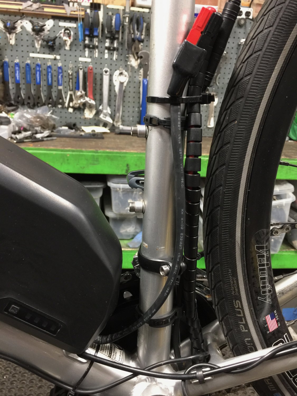

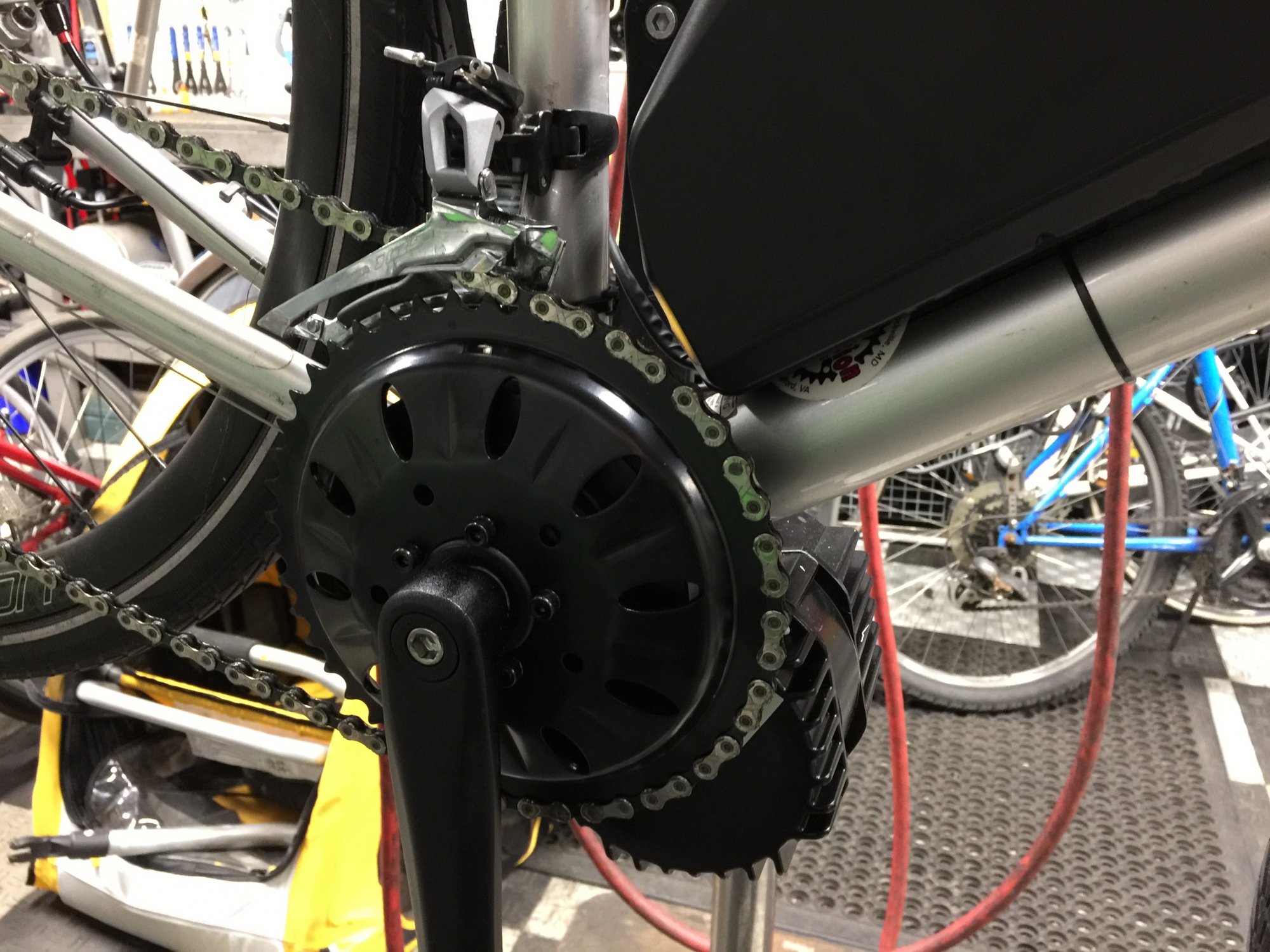

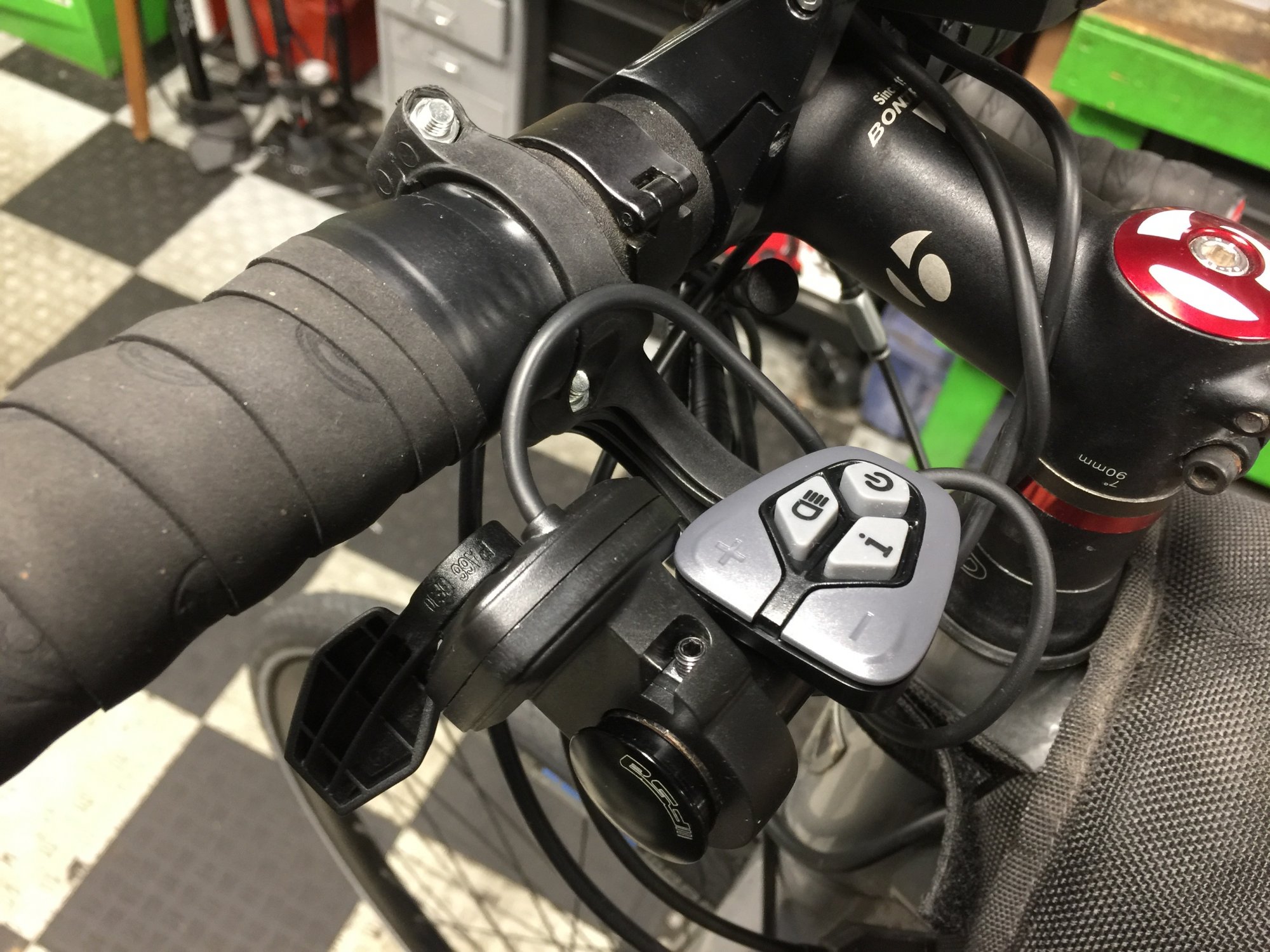

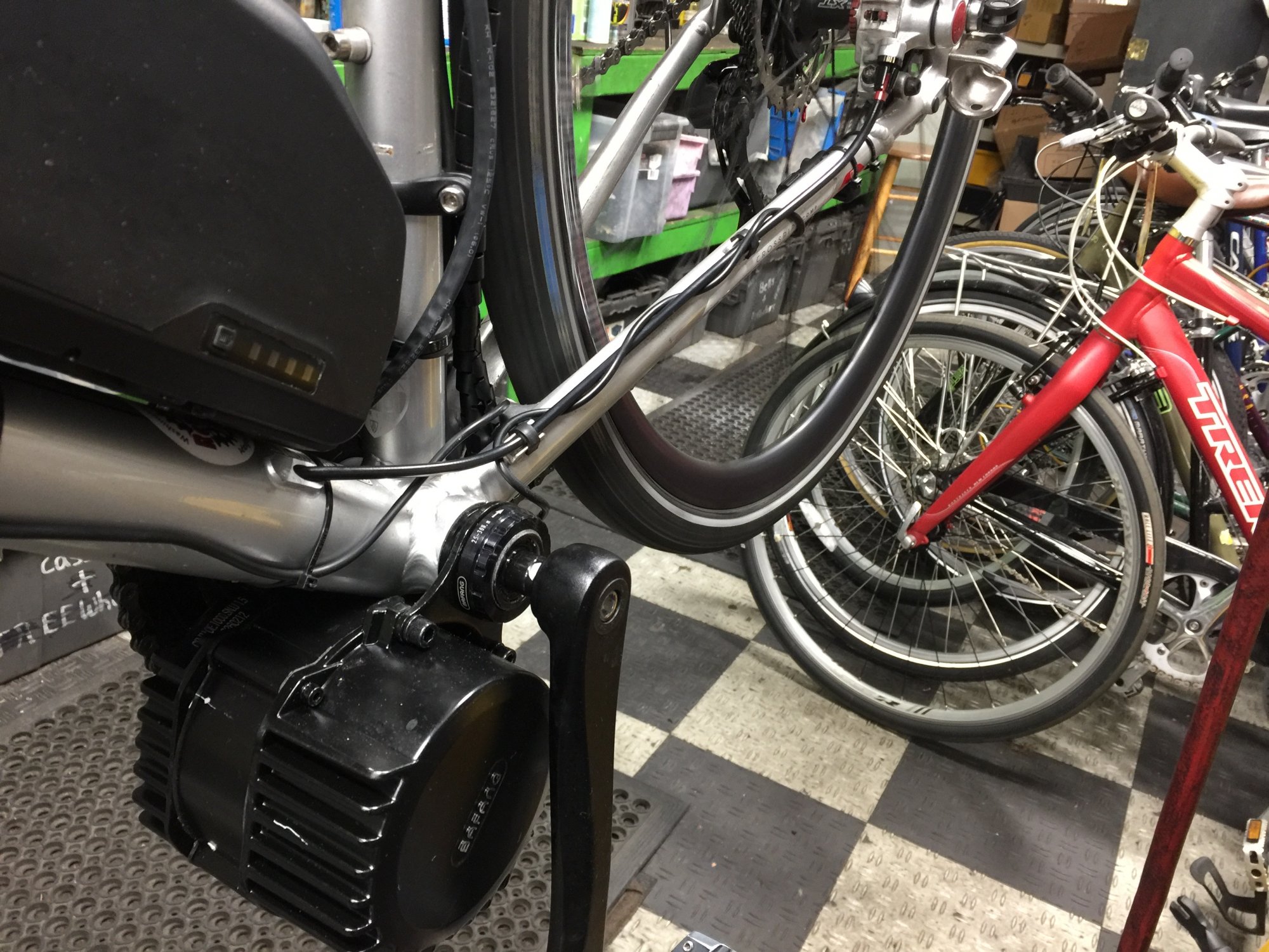

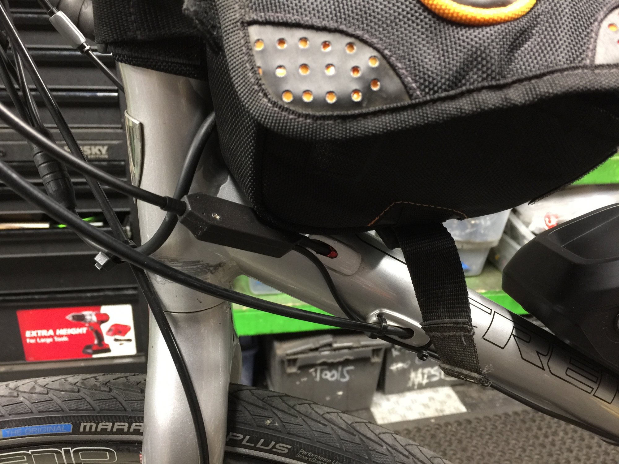

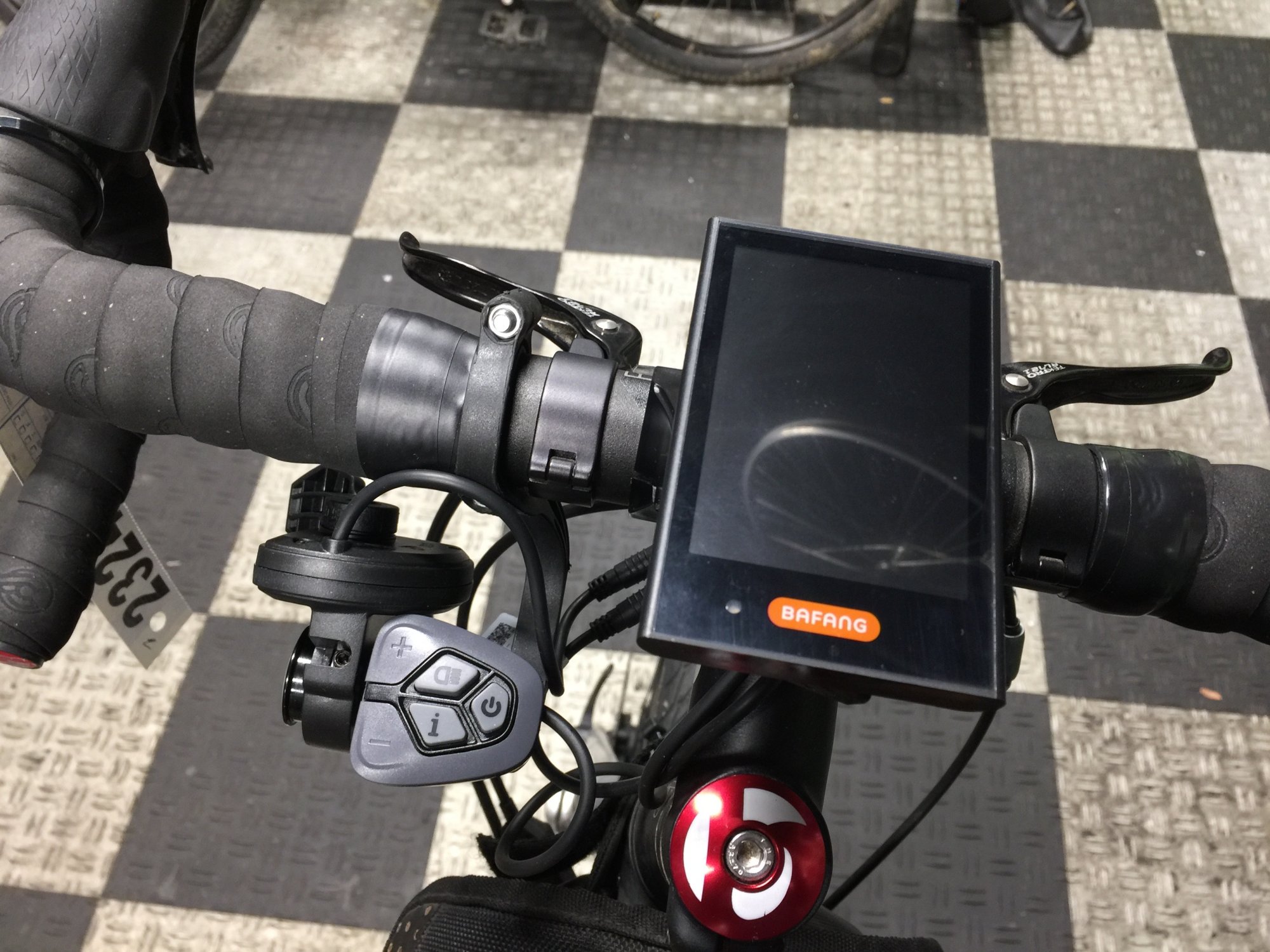

Not my bike, but the owner said I should post pictures of the work I did for him. So here is his Trek road bike with a Bafang mid-drive kit installed. He ordered the optional ebrake and gear sensors. I couldn't find an elegant or workable way to mount the ebrake sensors on either the main or cross levers so I left those off. Installing the gear sensor was no problem, other than trying to sneak a new gear cable through without having to pull the motor off. I opted to leave the front derailleur on; locking it out to act as a chain guide. I used Cobra Flexroute cable guides to tidy up the wire going to the head unit. Lastly, I modified an accessory mount to place the control pad and throttle just behind the handlebar; the throttle can be activated using the index finger. The kit is not difficult to install...I have done it before...but trying to keep the wiring from looking messy, and in this case, figuring out a solution for the button pad and throttle (which won't fit on road bike handlebars) took some time.
