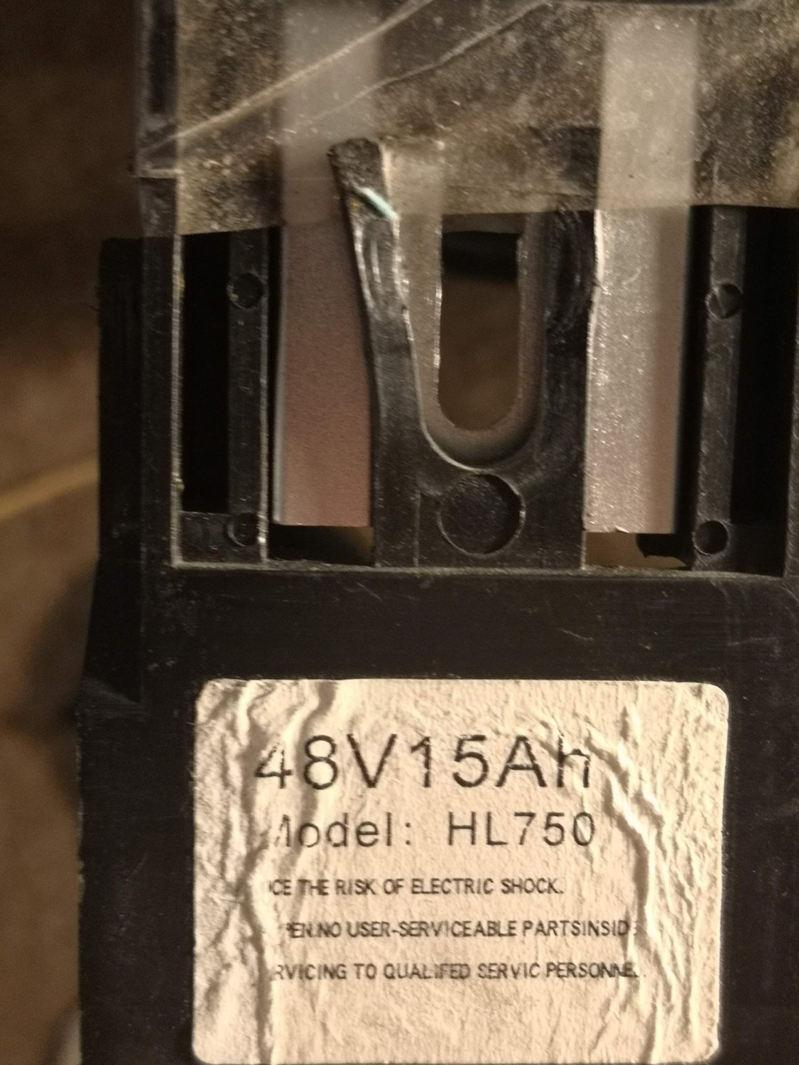

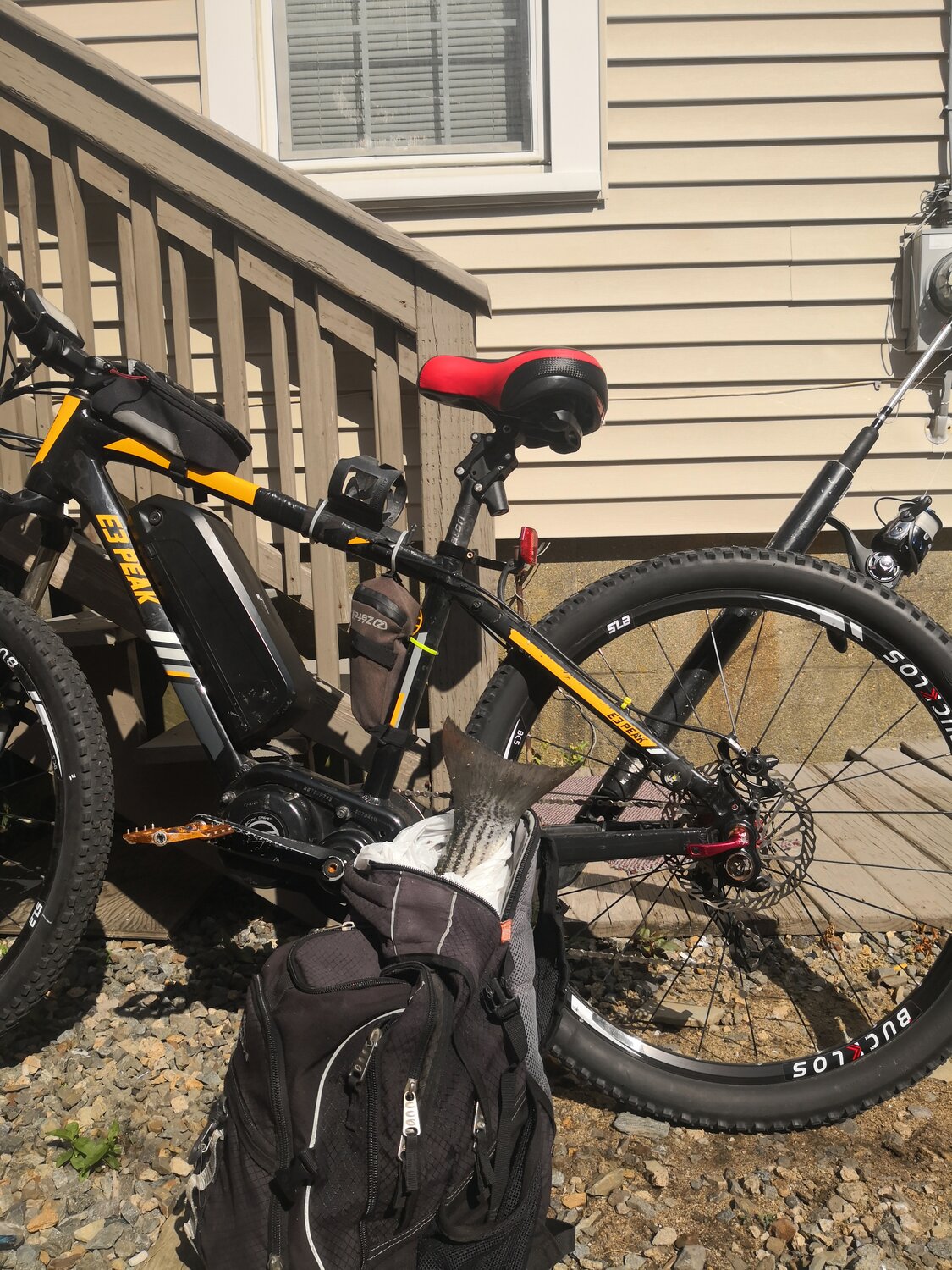

I ended up getting a 48v 17.5ah hailing for 275$. I purchased it 4/21 and it's still going strong. The mounting was super easy and so was the wiring (except I lost the ability to track battery life on the display.
Looks great, and much cheaper than the battery I just bought off Amazon. I paid $414, but maybe I paid for the LG cells I've supposedly got inside.

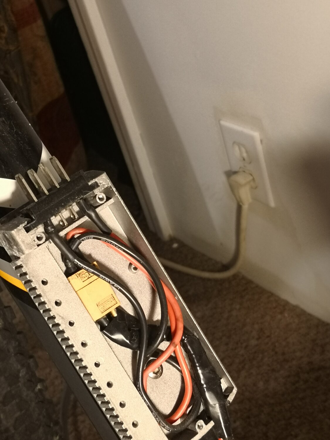

So, can you tell me anything about the wires? I've just left it partway dis-assembled but stopped because the bike-to-TransX BL17 harness has what looks like four wires, and I don't know if I need to connect just the main + and -, or if the smaller ones are essential, too.
Any pointers at all are appreciated. Seems to be no good hacker info online about our bikes or batteries. Gonna finish this tomorrow one way or the other.

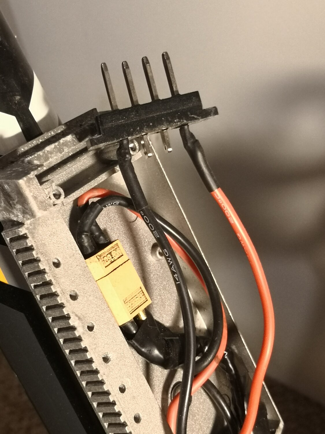

I hooked up the two main wires (plus and negative) wires and just left the smaller two wires hanging. I couldn't get the schematics to the battery to tell if what leads to hook the other two wires onto. I didn't want to chance hooking them up and frying the bms or battery.
Ha! Yep, that's EXACTLY where I am right now: Do I hook these two smaller wires up to V-, and risk frying something...or let them hang.
The only additional info I have is that, I put my voltmeter on the BL17, hit the power button, and measured the four connectors. There's v+, 54v-, then the two other connectors are 50v-, 48v-. So...I might give it a try to just hook the two smalls up to new battery V- and see what smokes.
What bugs me is that I ordered a 48V battery instead of a 52 because I'd lose the capacity display with 52. Oh well, I'll have 960 MWh of range to cry it out this weekend.

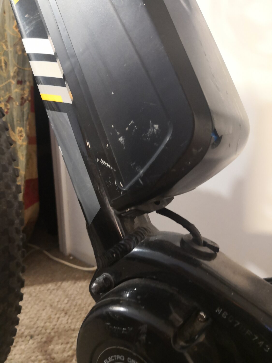

I chickened out and just hooked up the + and - wires. No display on dash of battery fill. I guess I'll have to stop, push the battery indicator button, and look at how many LEDs are lit whenever I need to check it.
However, (and I know this isn't supposed to be the case) my BIKE RIDES a few mph FASTER on the same roads as before. I suppose the new battery is able to sustain a higher voltage under load.
Here are pictures of the newly installed battery and wiring.

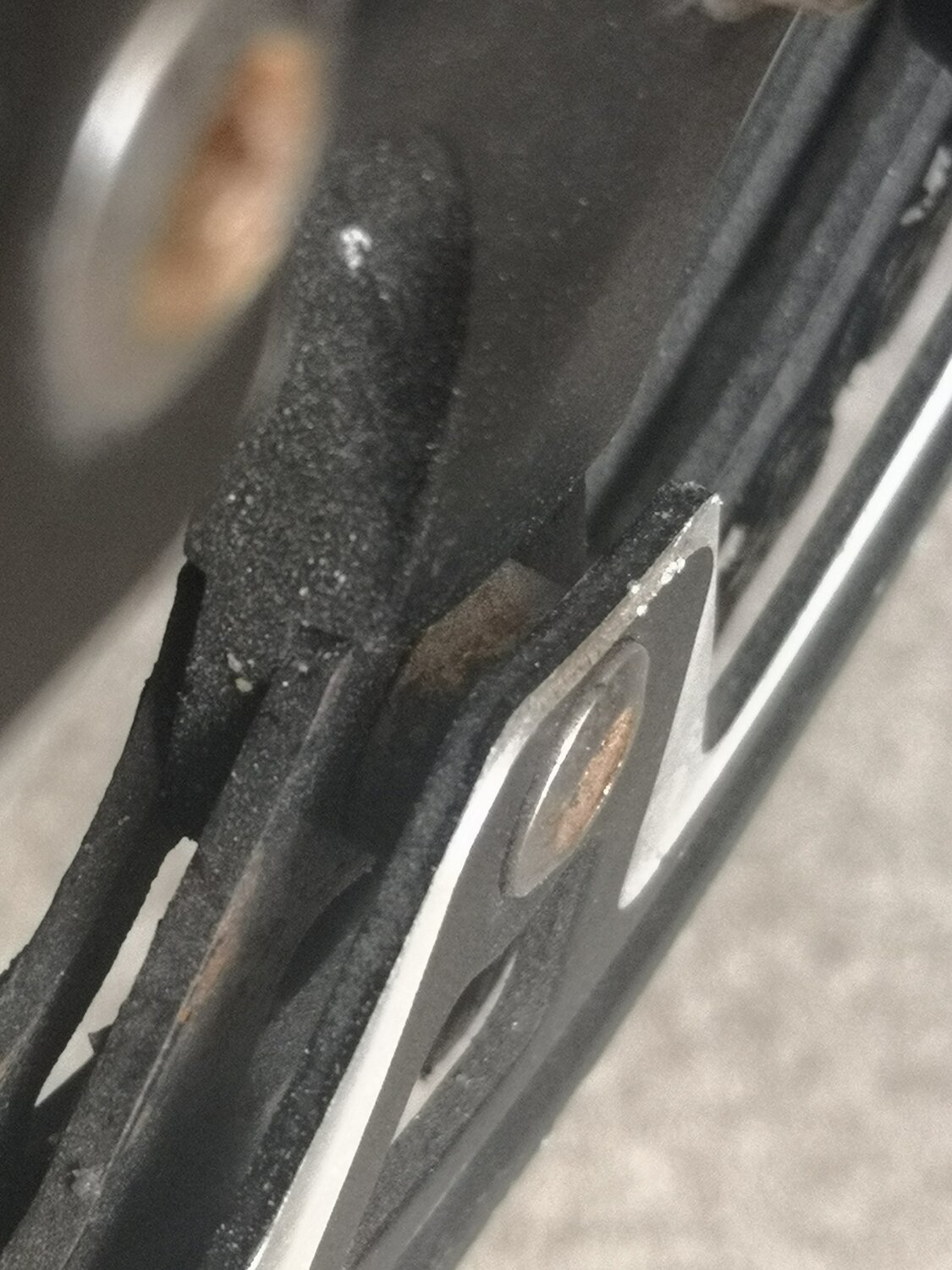

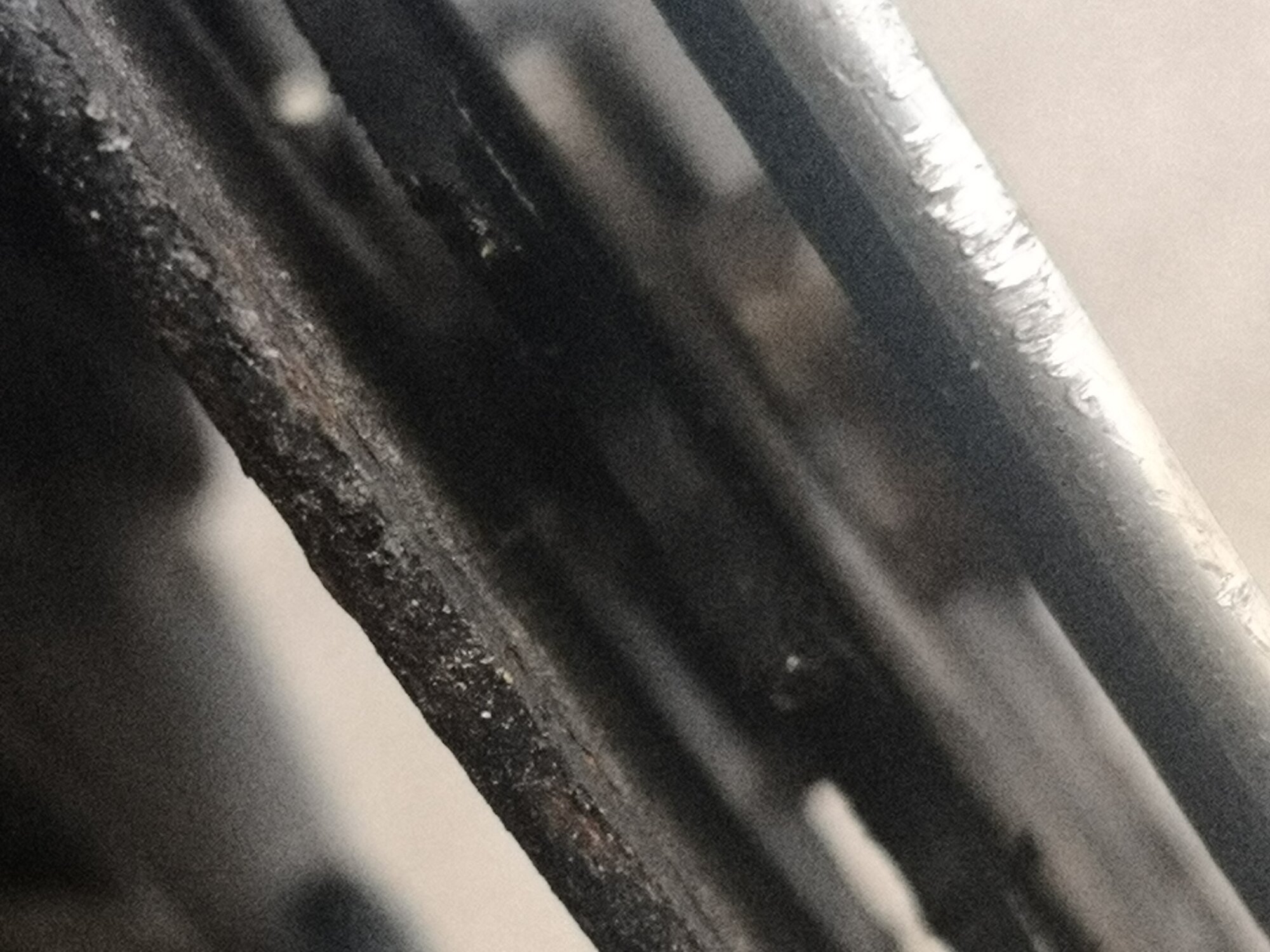

I was wondering if you could do me a huge favor. I took apart the front chainring. It has the 2 bash guards and sprocket in the center. In between there are spacers and washers and for the life of me I can't figure out the order the spacers and washers go. Its hard to see in the pictures, but I have it set up in this order.
Inner bashguard, sprocket, spacer, washer and outer bashguard.
Could you take a picture so I can see the correct order and get this fixed?

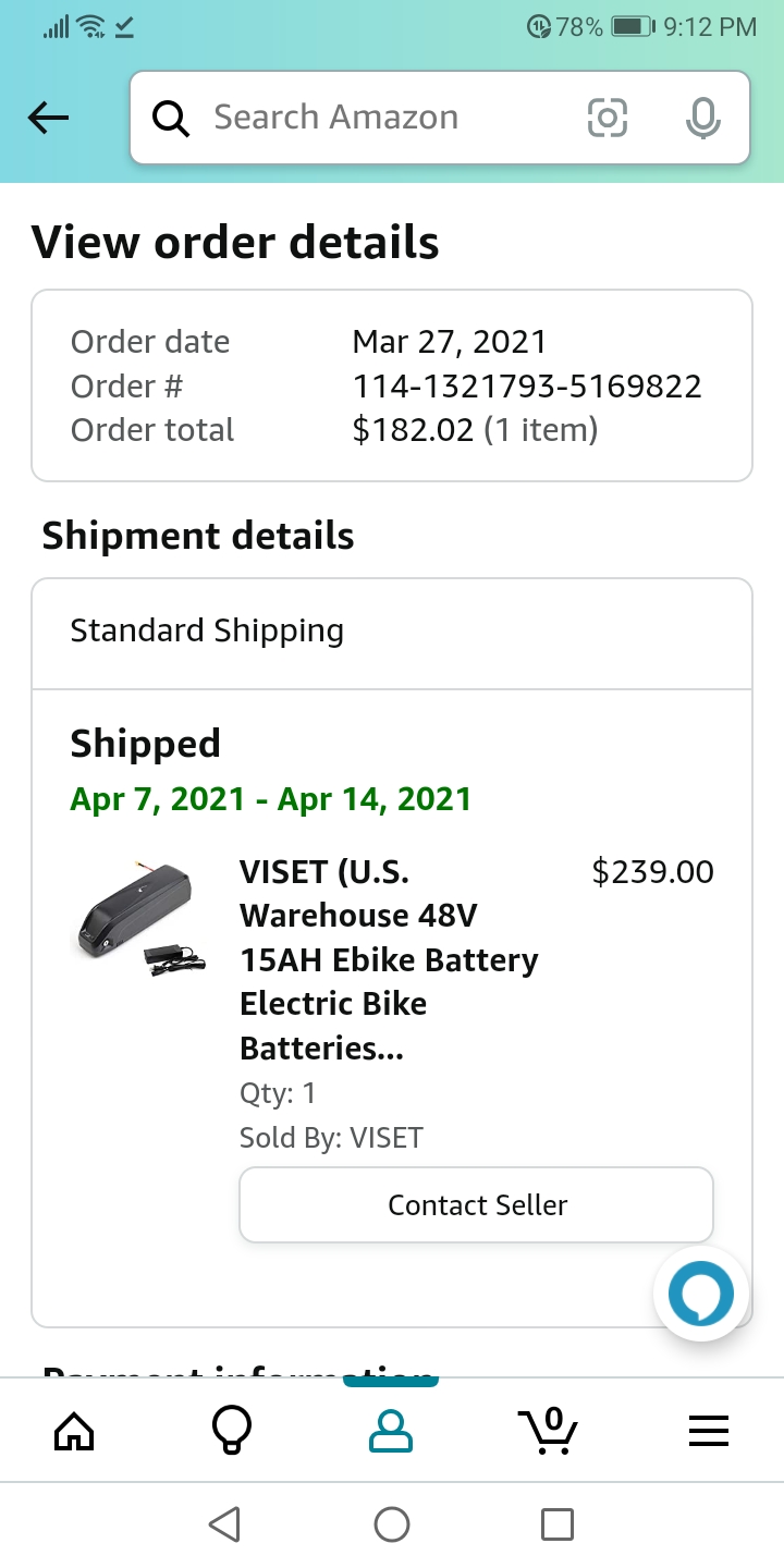

We've discussed the installation in great detail above. I've included a Pic of the order. Due to the time this is the only info left on my purchase.
The seller said it was 48v, but a multimeter said it was a 52v (so who knows) both will work.
48 V is the nominal voltage, and 52.4 V is the proper voltage for the fully charged battery. Just to make you less worried :)
Thanks for letting me know. I had no idea and will never understand why a 48v battery registers as 52v. Please don't explain cause I'm so done trying to figure this battery crap out lol
