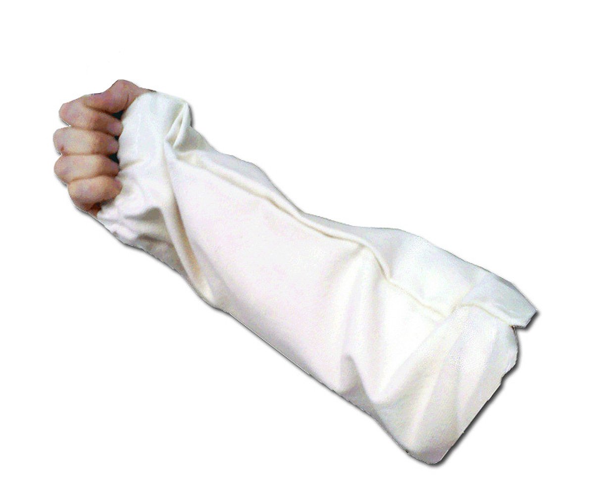

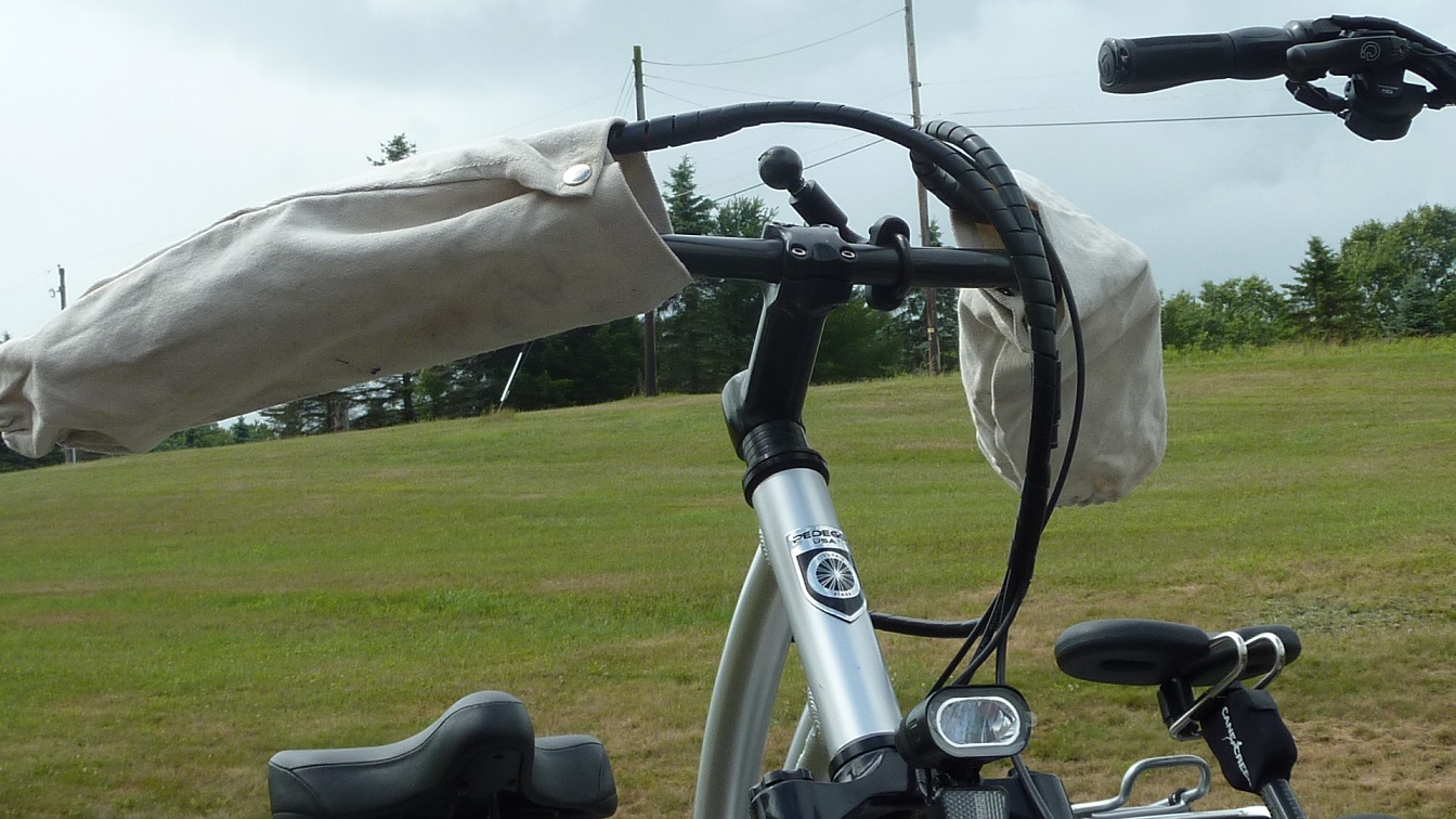

I cover my bar ends with these:
They are heavy canvas fruit picker sleeves with elastic on one end and snaps on the other.
I tried using plastic coverings but they trap moisture & condensation which causes the display to fog. The cotton canvas fabric breathes and allows moisture to escape. It's amazing how dirty they get from bugs and debris that could foul the control cables. I just throw them in the washer when they get too gross looking.
Yeah Man! Best post so far in this thread. Perfect solution.
