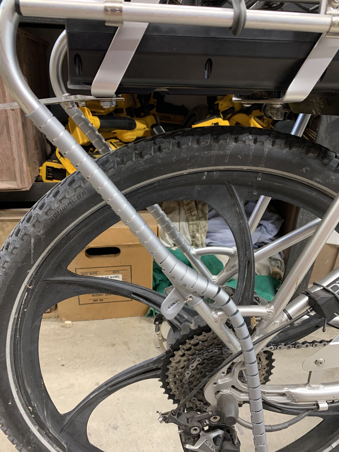

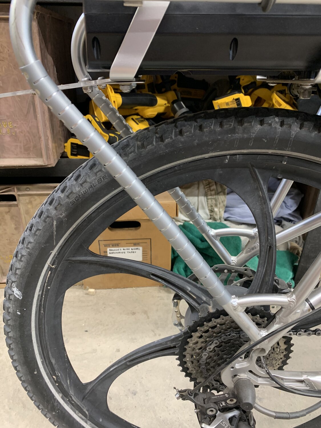

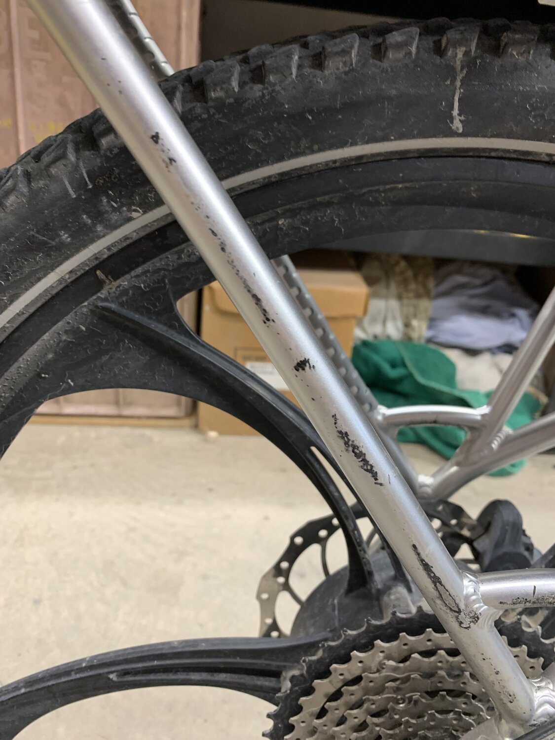

Late to the party here.
I haven't had much luck touching up the paint on the frame rails where the panniers rub against them. It has to be redone every season. I tried tape, but it doesn't last long and looks shabby. Spiral wrap works but it's hard to keep in place and looks ugly.
I came across this product, which is similar to spiral wrap, but it's actually split wire loom tubing. It looks much cleaner and stays in place with no variation in the space between the wraps. I chose silver to match the bike paint but it is available in other colors as well:

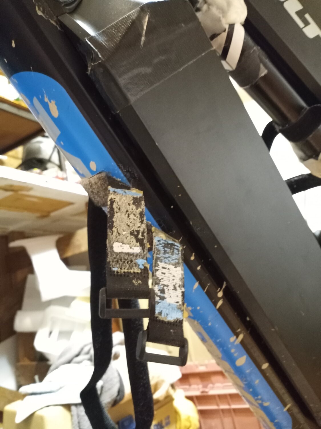

I glued velcro straps to my frame to help hold down the battery.
I peeled them off to readjust them and they took all the paint off. 😂
Luckily I don't care. I'm 100% function over form.
The only reason that I used to care (with my car, motorcycle or bicycles) was because the bare metal would rust, but that isn't an issue with an aluminum frame.
