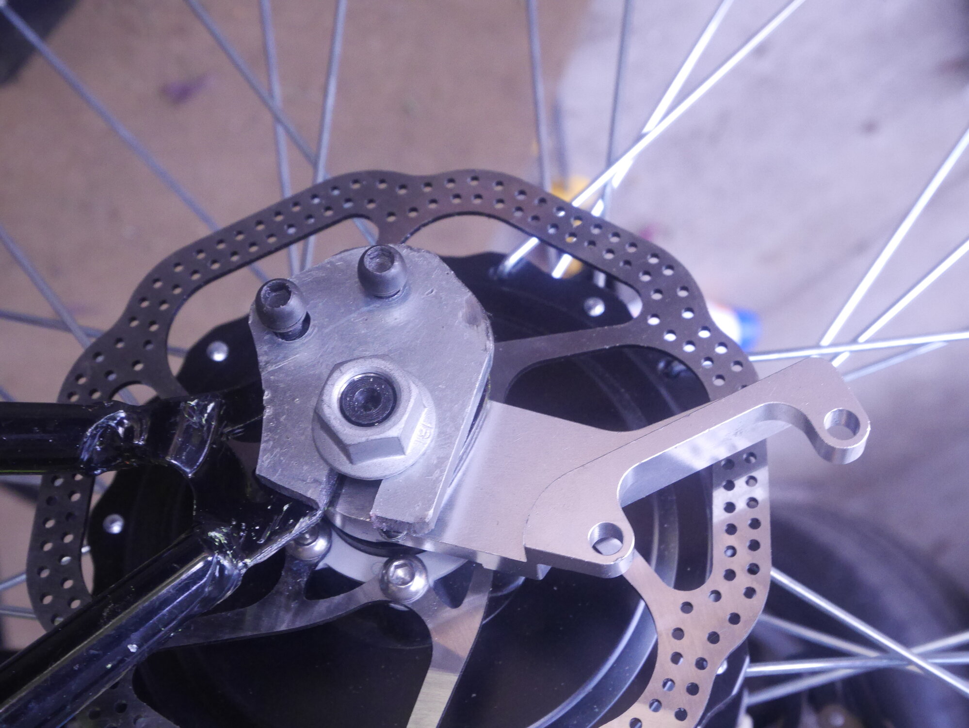

I've made most of mine. I got two that came with motor kits, but I avoid the hose clamps. I'll make a short arm to fasten the arm to a caliper boss, or I'll make a one piece torque plate like this,

I would only use the part that slides over the axle. From there it only takes a minute to fabricate a bracket that's bolted solidly to whatever is available.
