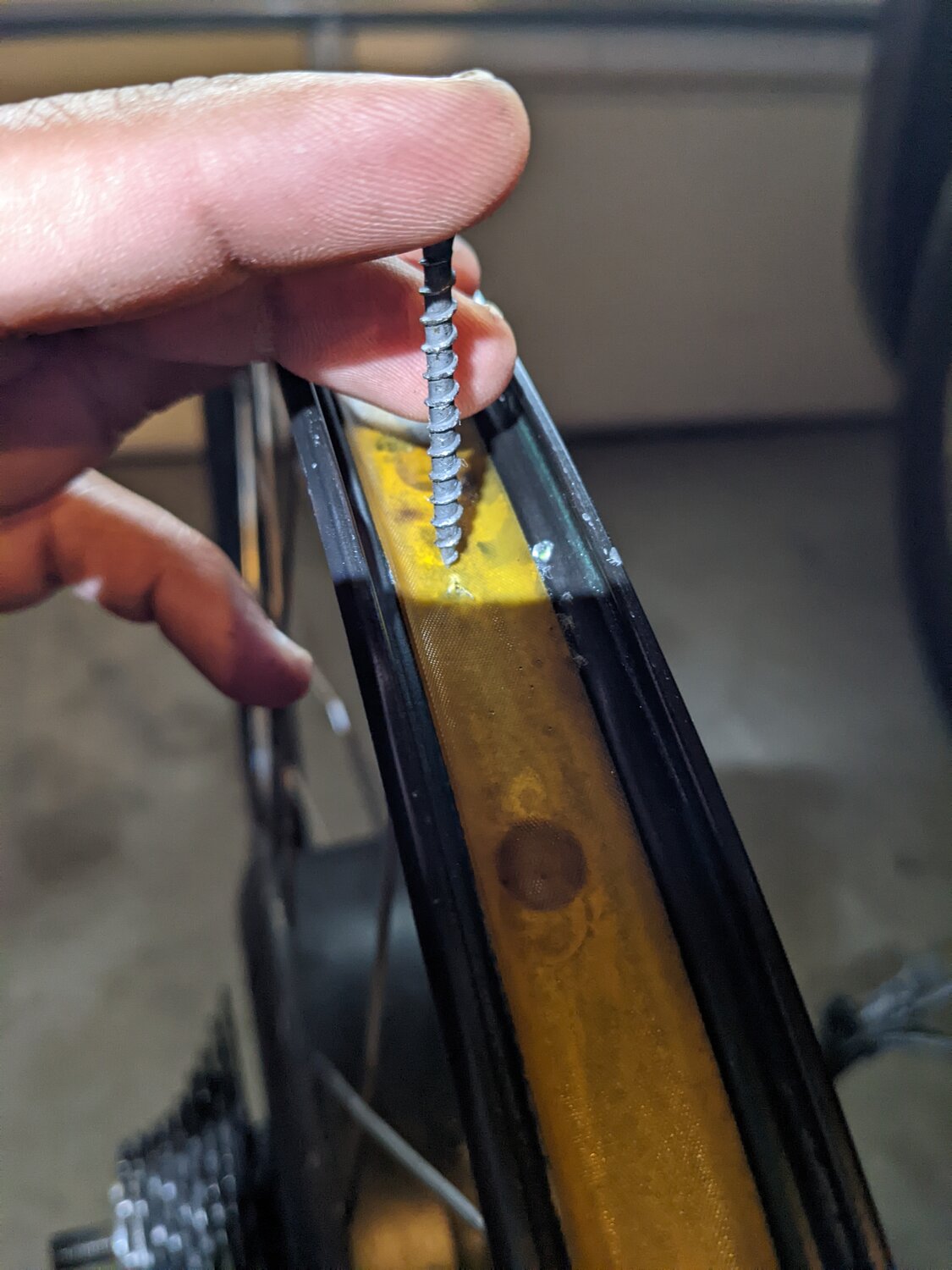

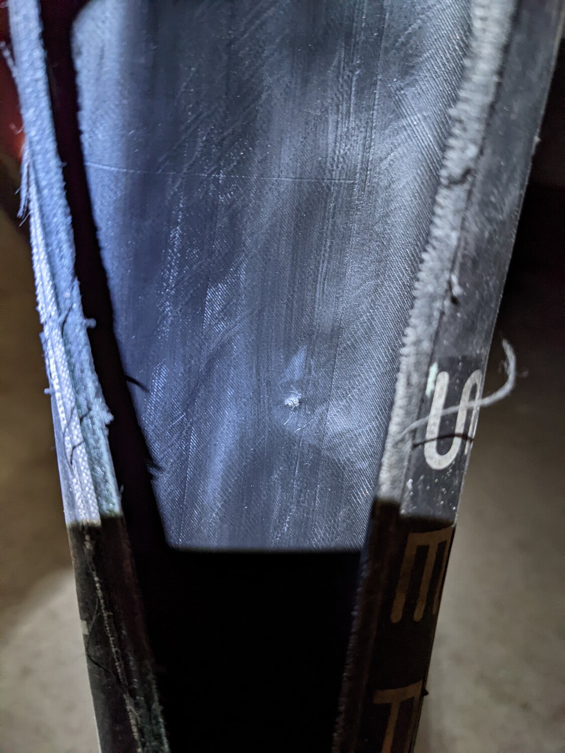

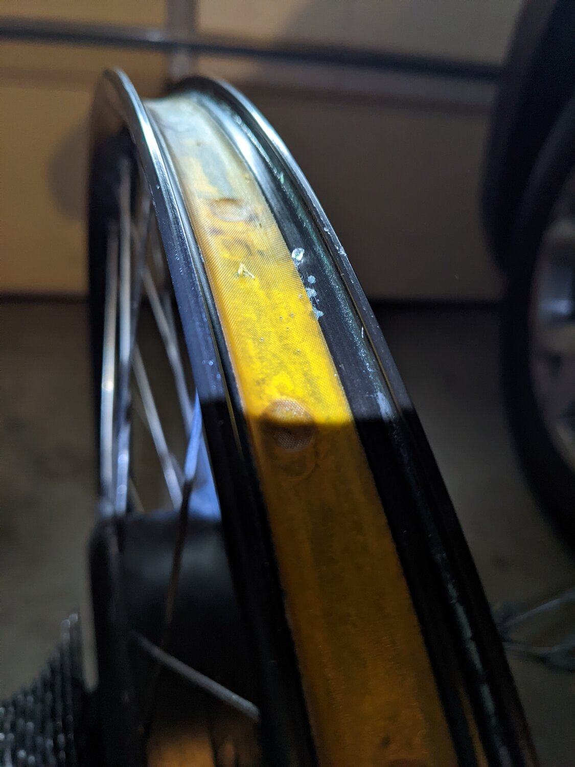

Just got the chance to remove the tube and the tire and without a shadow of doubt discovered the problem. A pretty big screw lodged deep into my tires. It obviously breached the tire itself causing the puncture on the tube, but looks like it also caused damaged to my rims.
I will be replacing the tubes of course but what is the remedy for the damage done to the rim? I see multiple sharp areas which I could easily see causing future flats from the inside. Light sanding / electrical tape ?
Would love to get thoughts here.
Thanks!
Thanks!
Sure... Sand, fine file or even dremel gently with a fine abrasive stone. Then clean everything well and a dab of touch up paint. Replace the yellow rim tape if damaged too.
What Gionni said about the rim. But holy crap! This is almost totally inconsistent with your original description of the problem. And it's very significantly inept to inspect a flat tire and miss something like that. Okay, you missed it, things happen, but it's hard to believe you even looked for the cause! There is always a cause that you should find and remedy, unless your Slime is so effective you don't even realize you had a flat. Sometimes it's a tiny sliver of glass or a broken off bit of thorn, but you almost always have a clue about where to look based on where air is leaving the tube.
Lessons learned, I guess....
TT
Guilty as charged.....but honestly, today is the first time I actually got the time to run a thorough inspection. After the initial discovery of the holes in the tube, I never had the chance to follow through. With 2 yr old twins at home, time comes at a massive premium for me.
Anyways...lessons learned.
