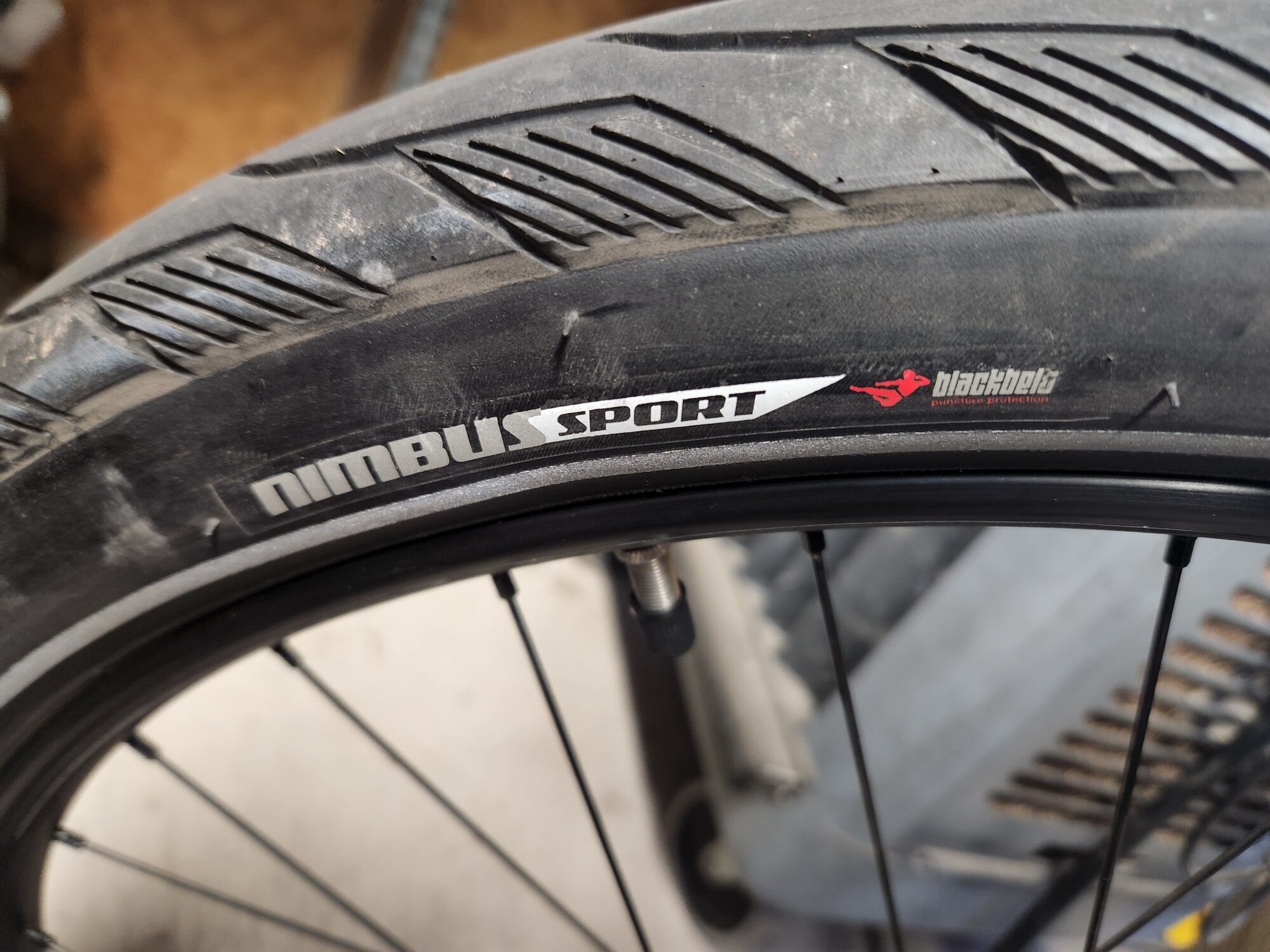

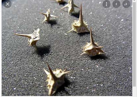

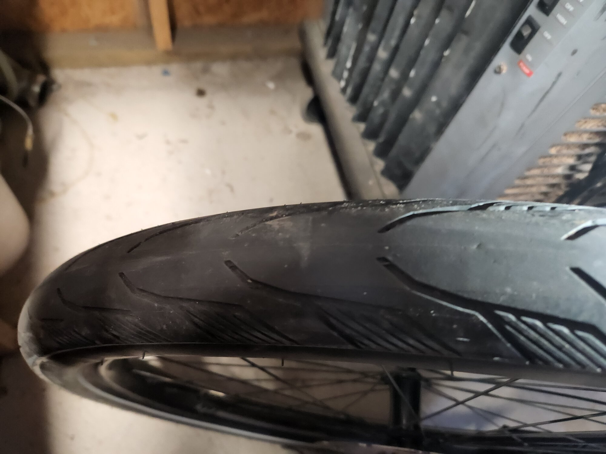

It's the Como. I'm using the tires that came with it for now which are thin, smooth street tires labeled "Specialized" and "Nimbus Sport" and I could swear I saw they were made by Kenda. These tires would be fine in most places for pavement riding only, which is all I do, no dirt, but in the Arizona desert no matter if you stick to the pavement or not you are going to pick up thorns and "Goat heads" which look like little land mines with sharp points
and impossible to see until you find one already embedded in your tire. I just picked up my favorite sealer "True Goo" and will pump some in tomorrow and hit the road to get it swirled around good. I found two Goat heads in the rear tire and patched it all up last night.
View attachment 131108View attachment 131109
I purchased a used bike to keep at my sister's place in Tucson. On the last day of one vacation, yup, goathead. I was pissed and had no time to fuss with it. Figured I'd deal with it the next time I came down!!! She moved to LA and moved the bike there for me. I much preferred riding around Tucson. Sabino Canyon early or Saguaro East and a few other fun rides.
Not goat heads, but I got 3 flats in 4 months from blackberry thorns. Went tubeless and zero flats since (3.5 years).
Those goat heads look nasty though...

Goatheads are VERY common out here near denver. They are the major source of flats most encounter offroad, typical of the southwest US
I tried all sorts of things back in the day...finally settling on Stans sealant inside tubes(tubeless would work as well). Minimal flats in the 15 years I have used it. All my tires have goatheads in them and never leak until I switch out the tube or forget to refresh the sealant. Worst ever was over 15+ in a tire/tube. Other options might work as well but stans works for me
Stefans opinions seems pointless(as usual) since I dont recall him ever encountering goatheads. Last I checked, Denver is closer to AZ than Poland. Has Stefan ever ridden in AZ? Out of all the useless/digusting manboobs/lycra/mileage pics stefan posts, I dont ever recall a goatheads pic
If your really encountering goatheads in your sidewalls as the pics show, perhaps you need to up the tire pressure. I have never encountered goatheads in a sidewall and all my bike tires have goatheads in them
