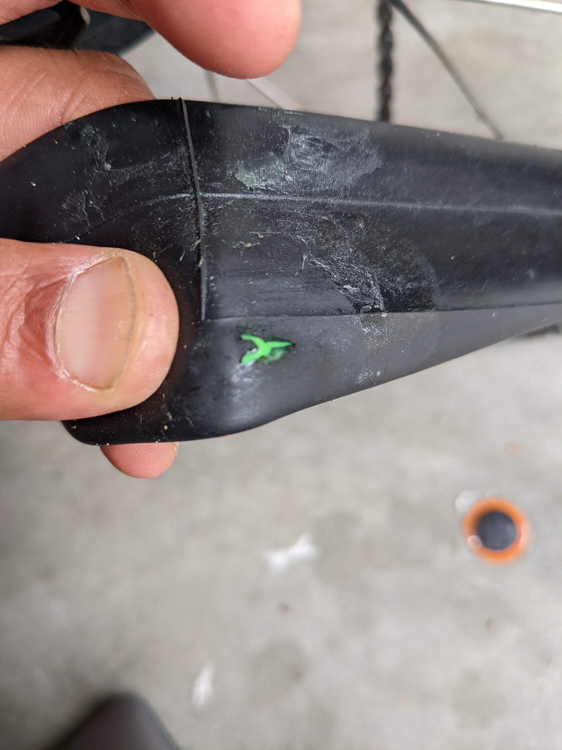

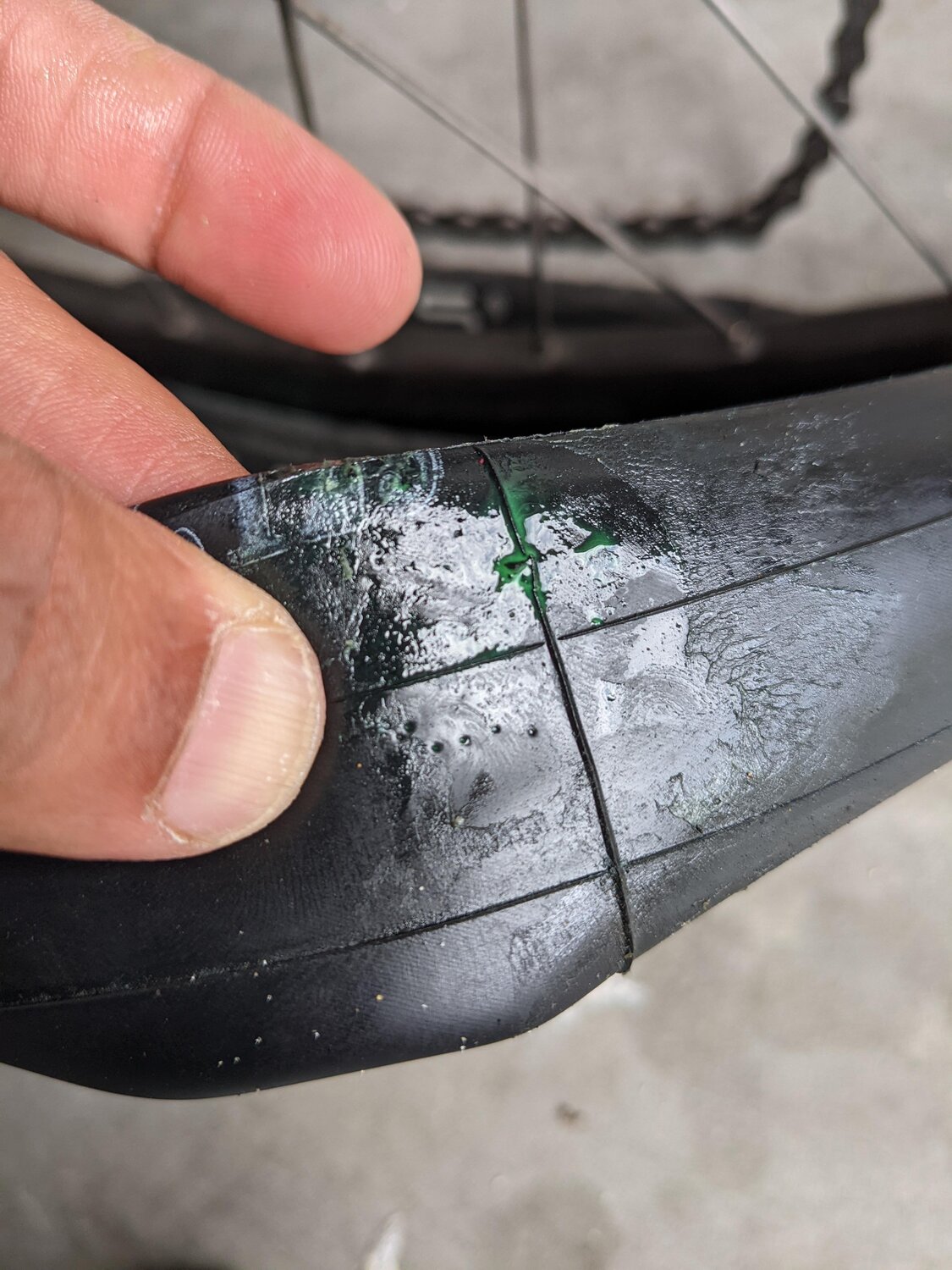

Avi, it's quite possible the thorn that got your first tube is still in the tire! If that's the case, it's going to keep taking out tubes until it's removed. If you have an idea where the hole in the tube is, you can reference that location with the filler valve, and usually locate it in the tire pretty easily by using that reference.
I'm a big fan of Slime, or something like it, inside the tube to help minimize flats....
It's very suspicious that the punctures are in the same area. AHicks has a great point. Also, where are the punctures? Could the spoke nipples be causing the problem? (They are on the wrong side of the tube for best Slime protection.) Inspect the inside of the tires carefully and check for any protruding or uncovered spoke nipples.

Attached are some pictures. The pic where the green slime is leaking out is a fairly big gash and then there is a series of smaller punctures in the immediate vicinity (but on the other side of the tube). Not sure if it started off with the big gash and then as I kept riding, the others developed as a result.
What I know is I need to come up with a long term solution for this as this rate of flats isn't sustainable for me, especially since I am commuting for work.

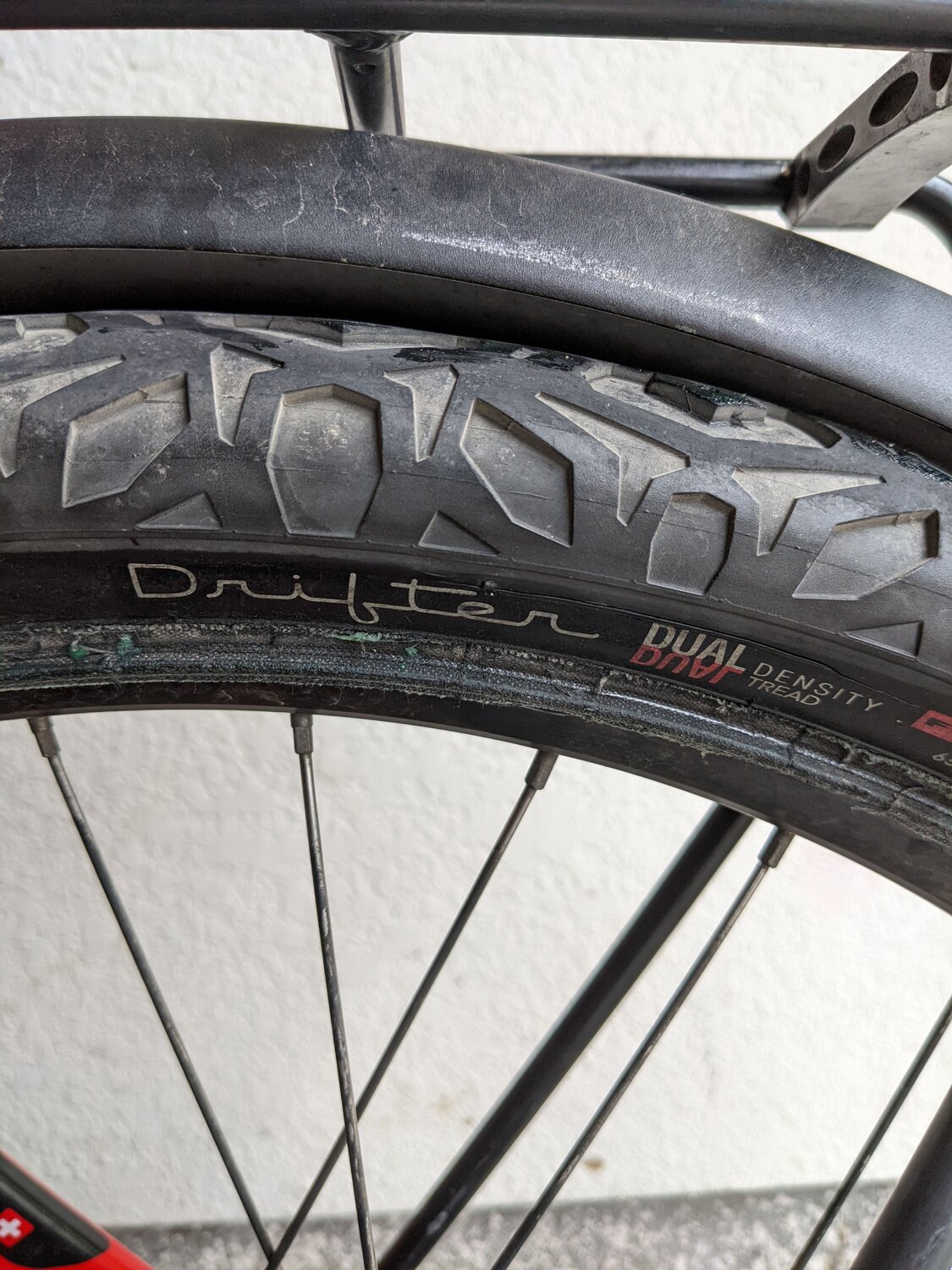

The front tire is the stock Stromer ST1 tire (Schwalbe Big Ben) and the rear tire is Serfas Drifter.
I've had good runout of Big Ben, no punctures in 5000km commuter but no thorns in my area. Puncture protection on BBs is very good, next up from that is Marathon Plus.
If BB are being punctured regularly by thorns I don't extra protection on Marathorn will make difference. Tubeless maybe way to go, BB should support it even it not meant to be run tubeless. Sealing rims maybe issue.
