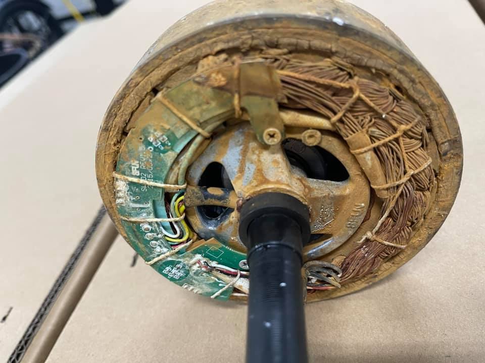

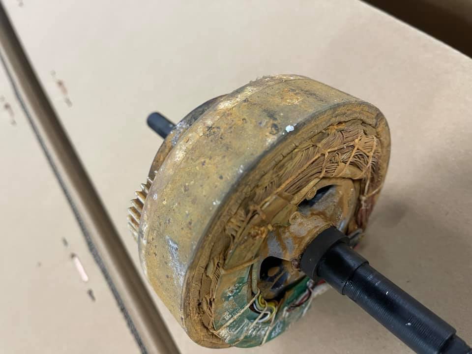

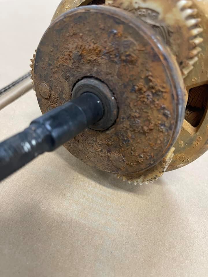

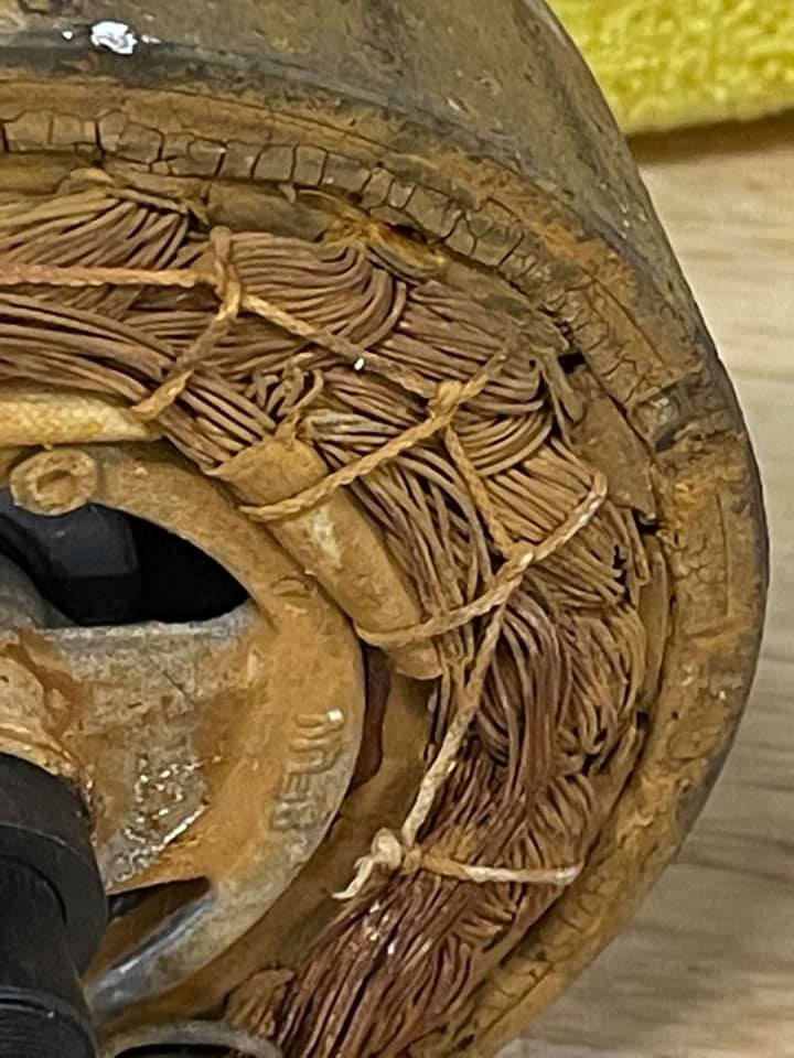

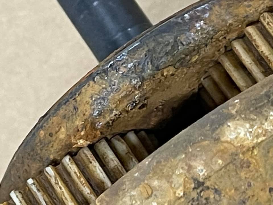

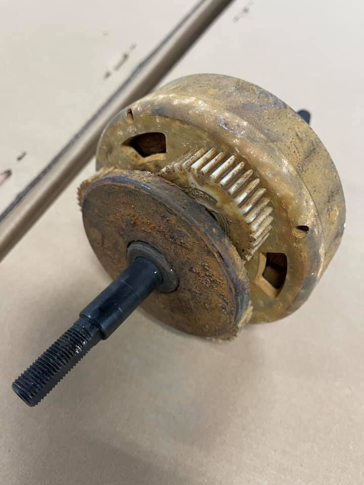

As for protection from water, @ez3putt when was the last time you opened up your motor and checked it? I saw these pics posted up just a couple days ago. I have seen similar on one of my own fat hub motors. Thankfully mine wasn't as bad but it was rust *everywhere* inside and a full Saturday to clean it out. Cable ingress points are where the water gets in and since its a mostly-sealed motor, it stays inside and then migrates everywhere after heating/cooling cycles turn it to droplets and they resettle.

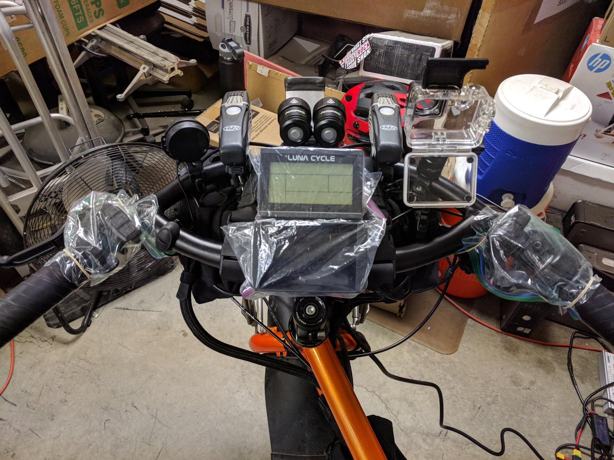

I throw a plastic bag over mine with a rubber band holding the front of the bag over the cable ingress point, which is where water usually gets in. Spray comes up/back off the front tire and soaks that very spot.

I like this stuff. O-Ring lube. See photo attached. Sometimes I will take apart a motor when it is new to apply this to each of the rubber seals. It helps a lot. I also use it on rebuilds. These motors have air space in them. They heat and cool so air pressure is exchanged, bringing moisture with it. They are not build like a diving watch. You can also use this stuff in the larger photo. It is thicker and used by plumbers inside kitchen faucets. It will last inside a faucet for years. The problem is trying to wash it off your finger.

I often drill mid-drive motor housings to reroute for a cleaner build with no visible connectors. Obviously this is 'cable ingress,' a vulnerable spot. I seal it with two products. Hot glue then rubber gasket sealant. Others might adapt this to their hub-drive cables.
@m@Robertson, never opened up my motor, nor do I ever plan to. If it ain't broke, don't break it.
