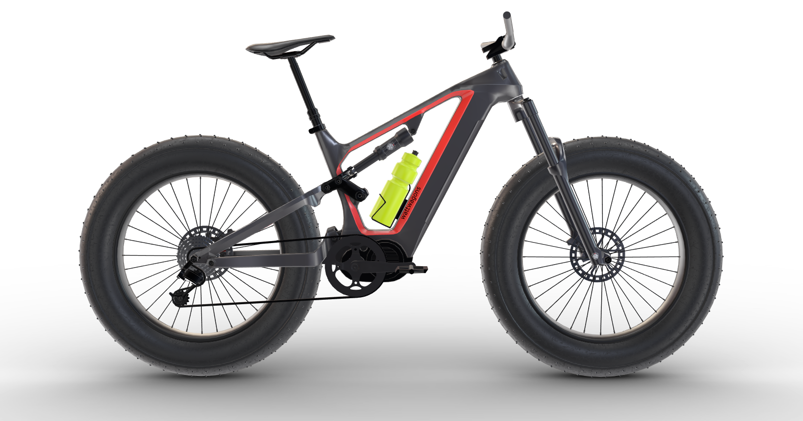

What is the measurement of your Hydra when adjusted how you like it:
1) - Top of pedal in down stroke to top of seat in up position?
2) - Center of handlebar stem back to center of seat post hole. (Probably measured on approximately level.)
Thanks so much if your willing to do this.
I highly suspect I want/need the XL frame.
@reed scott I was going to wait another day or two to let you soak in the sunshine of your new bike but this seems the appropriate time.
36 1/2 inches and 25 inches
38 inches saddle top to pedal top and 22.5 inches handlebar center of stem to seat post hole center for my current bike, Sondors MXS, and it is fairly comfortable.

Web Page Info- Use the Hydra or Hydra Frameset to configure and order your dream ebike. And be sure to read the OFFICIAL WW HYDRA FAQ page…
Motor, Controller & Battery - The WW web page has the best information as to the Bafang Ultra motor, the Archon X1 power and battery options. The DERESTRICTED THROTTLE option allows you to program your throttle above 750W (1000W w/ Kindernay IGH option). This option will only allow you to break your drive train and is thus not advised. Just know that 750W is 1HP, 1500W is 2HP, and 2300W is 3.1HP. In the USA anything above 1HP or >28mph is considered a “Motor Bike” or “Moped”…
Colors- There are a plethora of colors to choose from with multiple accent options available for a reasonable price to give a one of a kind bike. Even a custom full on paint job can be done, just ask Pushkar. Currently the colors are a thin film ceramic coating from Cerakote. The “H-Series” is being used for durability. This stuff was designed to coat firearms and OMG is it tough. Get samples to verify you really like the color choice as the stuff is not really glossy like the photos nor typical wet auto paints. Standard black is actually Cerakote H-190 called Armor Black. Please see the Color Configurator thread for a full discussion on the colors…
Frame Dimensions- The picture below is what brought me to WW in the first place; the 21” Hydra Frame. The forum has many locations where others have asked for XL but were only offered a 19” Large. I’m so giddy I kept bugging @pushkar to go for the XL frame investment! I suspect there will be many more big guys like me that will be happy for this decision too. 15” Small, 17” Medium, 19” Large and “NEW” 21” X-Large frames are available.

That’s a Hydra!!!
