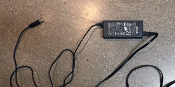

Once you’ve selected your ebike type and model, there’s one big variable cost to consider which is electricity… how much it costs to fill the battery each time you ride and how far that juice will take you. Here’s a quick guide to pricing out fuel costs:
  • Multiply the battery voltage and amp hour rating to get watt hours ie. 36 volt 10 amp hour battery has 360 watt hours (divide by 1,000 to get Kilowatt hours)
  • Check your local electricity prices, the average cost per Kilowatt hour in the USA at the time of this guide was $0.12
  • Multiply the Kilowatt size of your battery by the cost per Kilowatt hour electrical rate ie. .36 and $0.12 = a complete charging cost of $0.0342 or roughly four cents
  • Estimate your trip distance cost by dividing the charge cost by the average range of your battery pack… I estimate the lowest range per charge by dividing the watt hour capacity of the pack by 20 ie. 360 / 20 = 18 miles per charge and now we divide $0.0342 by 18 to get $0.00171 per mile. That’s less than two tents of a penny per mile on an electric bike looking at electricity alone!
