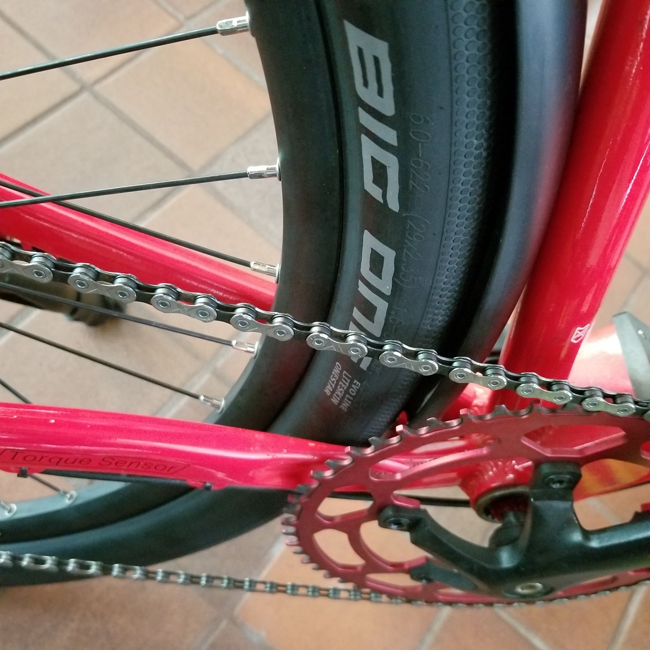

It really isn't very much work to crush the chainstays, now that the proper tool is on the way. Got it from Amazon for under $35, used-like-new, three-quarter-inch screw, all the power I should need.
Just arrived today: this over two-inch capacity bridge clamp. It weighs an ounce over four pounds,
If I spoil the frame, well, so be it.

Technical description of the clamp above, how it is expected to work and be used:
The half-round concentrates pressure for a series, next to each other, of very small pressings, to be repeated until the wanted clearance is achieved.
The outside of the tube is prevented from crushing at all by distributing the clamp pressure over a large area, by agency of the stacked fender washers, with compliance afforded by the crushable woolen felt.

Progress report: I went to work an hour ago. The clamp fits and it works. The one side is done, crushed plenty serious! (grin)
However, the superglued washers are not staying stuck to each other. So I am going to rebond them with epoxy and put under a square of 1/4" thick hard fiberboard in place of the red piano felt pad.
The plot of this story is not thickening. It is thin-inning a lone pair of CCS chainstays.
We are at this time of writing halfway done. Then I have to realign the tire laterally and vertically because the crushing alters the existing alignment. Then I have to ultra-carefully clearance a fender for which there is almost no room. Hours of fiddling. I can profitably waste this time because it is going to be a success.
One side of my CCS chainstay pair is already sufficiently thinned-down for clearance of the Schwalbe Big One.

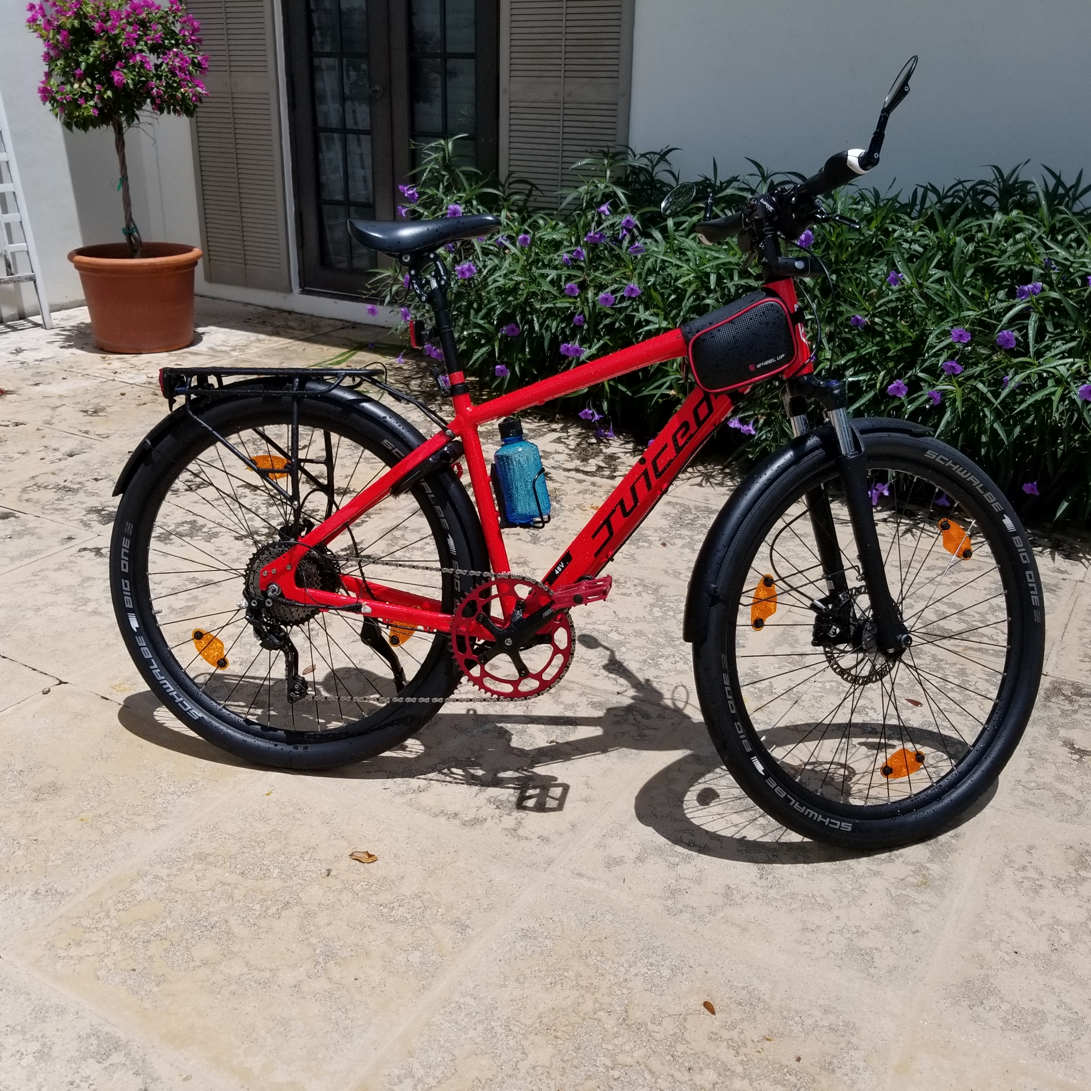

The Big One truly fits the rear of the CCS after a lot of hand labor. No risk of rubbing any more.
The fender was made to fit, too, after a lot of hand fitting to gain good clearances.
Now that this ordeal is done I am glad I did it. But if I knew how hard it would be I...I guess I would have done it anyway.
Wow Reid, Good job-The bike is looking awesome indeed. Outstanding job with matching components. I betcha Tora would be impressed as well LOL!
