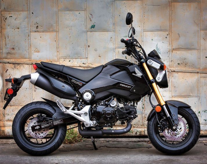

Honestly, I only see a few bikes I consider well-designed, if they are pushed above 25 mph. At 35 mph, it's almost comical. The forces that cause injury increase by 4x for every time you double speed.
Consider the most basic motorcycle, which retails around $3,000. The Honda Grom will easily keep up with traffic in a city. It has 200 mm disk brakes, a 4 inch front suspension travel, and a rear shock system. The tires are beefy enough to survive a pothole, or at least the wheels will not collapse. The Honda will be worth something in 3 years, a CF bike will be hard to sell if the battery is getting old. You can ride the Honda with a good full face helmet and not look bad.
There are costs to owning a motorcycle, but there are real benefits over a speed ebike. Training is hardly a bad thing. Technologies like ABS may never find their way to ebikes. I don't know how ebikes compete with e-motorcycles, down the road.
I almost bought a basic ($4,000) motorcycle a couple of years ago. Then I noticed ebikes and finally bought one. I just live with the low speeds. A bike like the Sondors is fun at low speed. That's where I would aim, rather than chasing something that creates a whole lot of problems.
