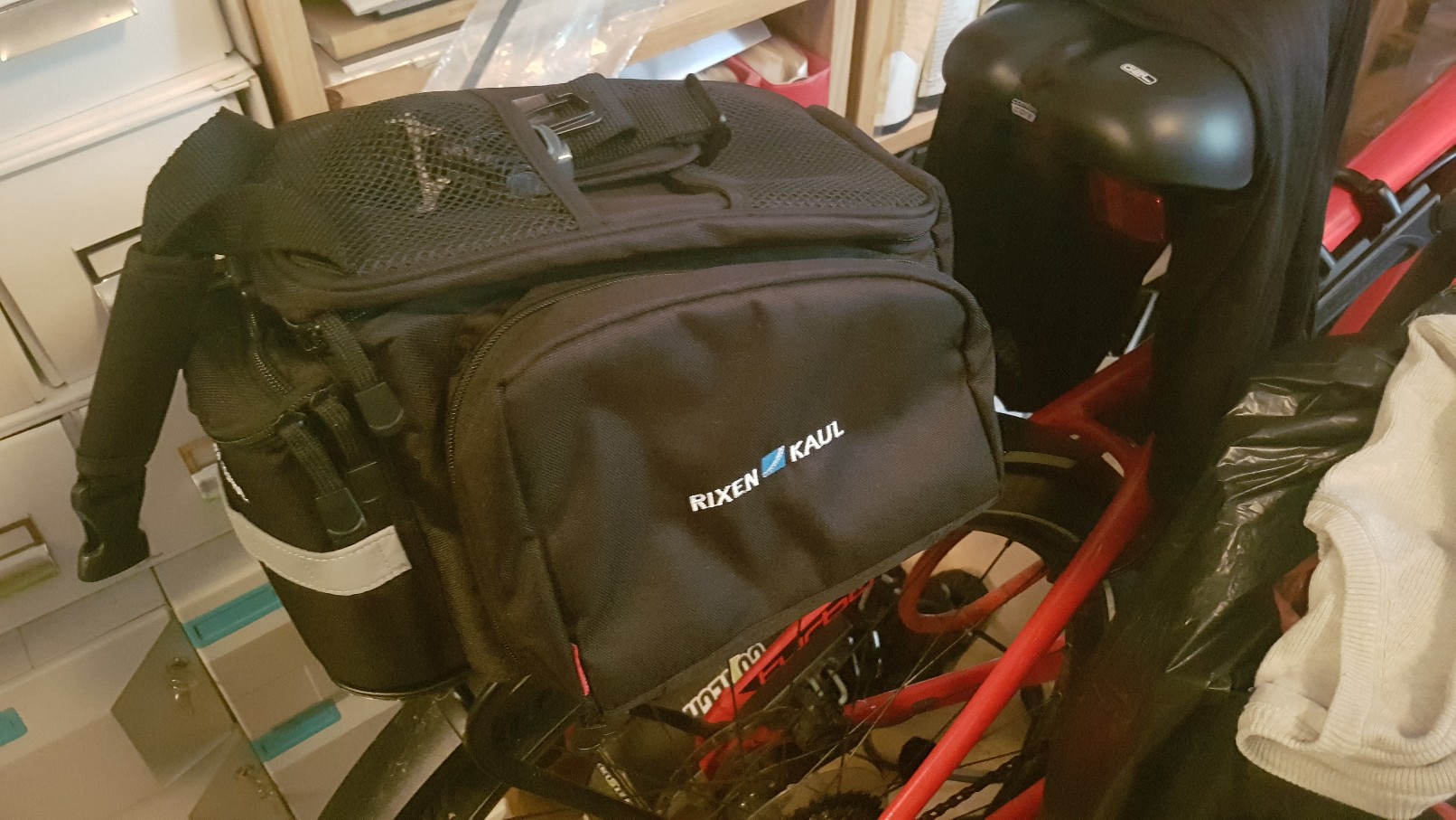

I got home KLICKFIX RACKPACK 2 PLUS yesterday and just clicked the bag on the rack, no need for a adapter etc.View attachment 18075
IF that bag is a 2 plus then that means each of the side pockets folds open to create a panner. Do you have a picture of the sides open
I was looking at those but the product description says that they should only be used with a rack with side screens. The Vado is very open is there not a risk of the wheel being fouled?

I am not sure if it works with the Vado, i use the sidepockets to store extra lights, first aid etc. But i can take a picture tomorrow or in the weekend.
I think as you say that its very open, you cannot use a pannier on the side with it, there is no space for it. I have a big pannier for shopping etc to alternate with.

My bike is in for checkup my motor is noisy, so you have to wait for the photo.
