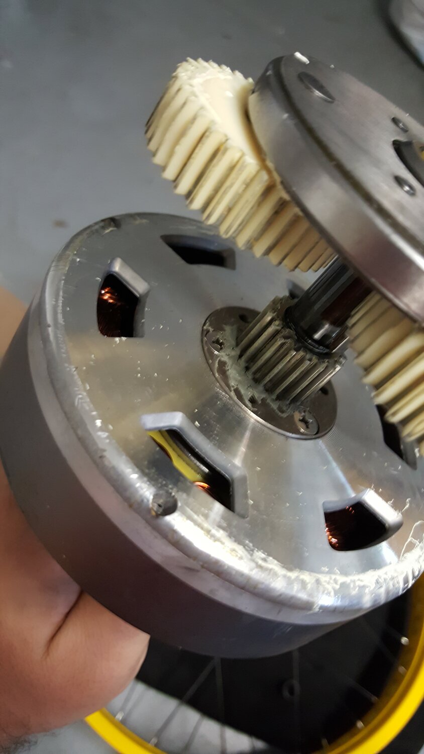

Here is a photo of the 750W motor core that I received from Area 13. It looks substantially different from the advertising photo of the core that I ordered or to Kyles video comparisons of the true 750W Bafang core compared to the Rad power's cores.
I don't doubt that this core will fit, just that an awful lot was made in those videos about how to see the physical differences in quality between the Rad Power motor cores and the true 750W Bafang cores. It was also backed up with time trial comparisons between the those two. Those video testaments were a large reason for why I decided to upgrade.
I understand about supply chain issues, how the true 750W Bafang cores may not be currently available, but if the new motor cores are now coming out looking like duplicates of the cores that area 13 previously said were inferior... then an amendment should be done to those older sale videos and someone with an apple phone should take one minute to snap and post a true picture of what they are now actually sending out.

I took one of my new 750's (a front motor) apart right after my last post above to check the core. I saw the same ol' bigfoot 750 I expected and its a brand-new motor. Comparing @how 's picture to the one I posted of an old rear 350, his new one looks to be larger than the 350 but smaller than the 750 - and we know from past experience the 500's used the same sized aluminum slab as the 350. So this is something different. In a couple of weeks I will be able to do the same thing with a front 500w motor I have at home, when I get back there.
This is the way it is, working with Bafang (Rad just buys big enough lots that Bafang puts their name on them). They make varying production runs all the time and put different things out - even simultaneously. I have two BBSHDs fresh off damn near the same boat, and one of them has a different thrust bearing configuration than the other - and one has a power take-off wire while the other one doesn't. A customer may place an order with Bafang, then cancel it and Bafang just releases the product - that may have some unique elements to it - into their normal output channel. Those same G060 fat motors like yours were once infamous for having two different KT controller configurations. There was no rhyme or reason to which one you would get. You just try one and if your display is scrambled, try the other one and it'll work.
Likewise, that new 750 I just cracked open simply had a standard M3 socket cap holding it down with a little blue thread locker on it. I have some motors that use countersunk Phillips heads that needed a heat gun to soften red loctite, and an impact wrench to pound the damn thing out after heating. More recently they have been using red loctite and security Torx heads. But this one has a simple socket and came out easy peasy.
Point being... whatever you are seeing in this production batch could change tomorrow, and again next month. Bafang moves in mysterious ways.
