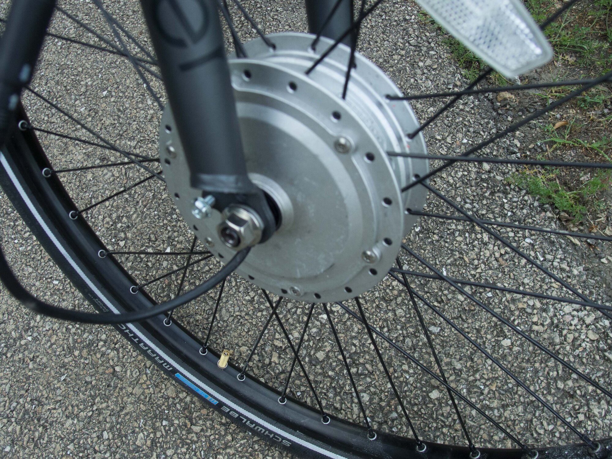

Installing my uber recycle motor today. The julet - bullet connector harness came the 2nd day via USPS. Those 7 lobe nuts are funny; found 2 12mm-1.25 hex nuts at the flea market yesterday. Burnt the pin off the harness to the Mac12t in the rain 7/12. One more hole to drill in the torque arm, clip the wire to the strut, ride out to the summer camp where the ebikeling controller is. Ordered a controller 7/14, got a USPS tracking # only 7/27.
I'm nervous about the schalbe marathon tire on the uber wheel. Road tires have a lot of flats. Has a long brass shrader stem, probably tubeless. I should probably take it off now and put on a knobby kenda, but I'm out of long stem tubes. If I do ride the marathon tire, will carry a knobby tire with me.
Schwalbe Marathon tires are pretty flat proof. They have an extra anti-puncture layer and are expensive touring tires. I use them on my commuter bikes.

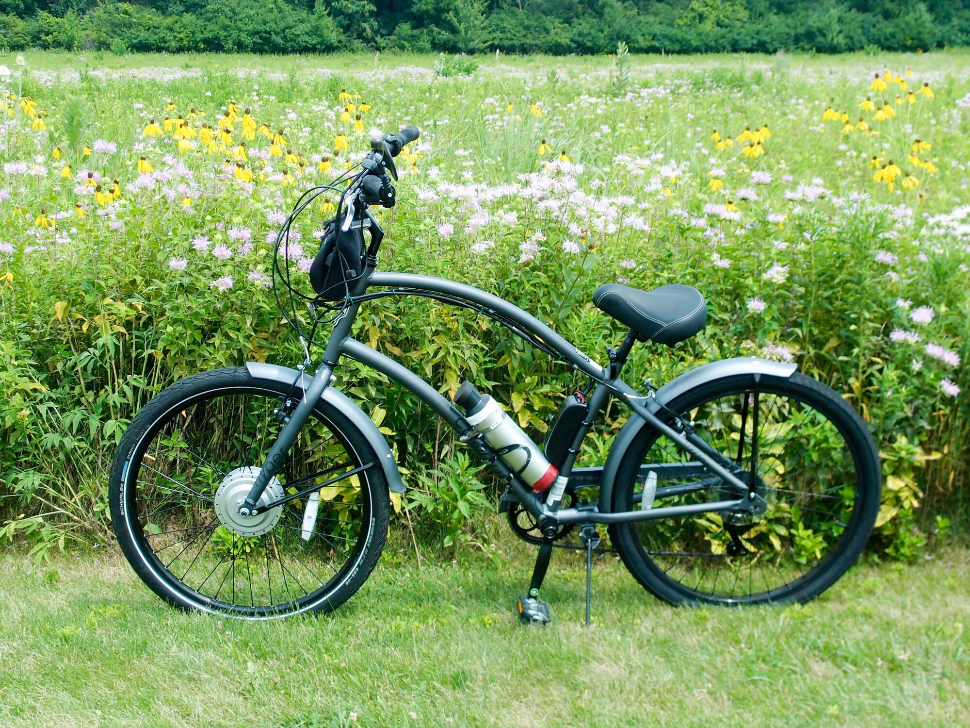

I started putting mine together 10 days ago. Still a work in progress. No torque arms yet, but fork is steel, and Uber did not use torque arms either. Using v-brakes.

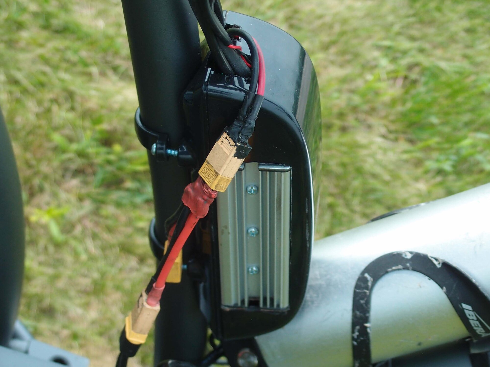

Using a KT square wave controller, 20A, and a 36V 10AH UPP battery off another conversion. Cranks along OK in PAS 1 at 12 mph. Tops out at 20 mph. It's comfy, and the high handlebars bars are novel.

The controller was too large for the only controller box I had, so I cut a slot for it. The power cord was too short too, but I'll fix that.
I also bought the Uber 36V battery for $40, a nice 40 cell unit in a metal case that is 19" long. I daydream about cutting out a wooden "tank" and hiding the battery in it, but that would be a wide tank.
I'm sure you know this but that rim isn't meant to be rim brake compatible.
I need another ebike like I need a hole in the head but I ordered a similar new/never used "Bafang FM G320.250.R 250W DC36V Front Wheel Electric Motor Hub" laced into a 26" wheel (same type rim as yours) to put into a 70's Sears 10 speed that I had converted into a 3 speed IGH several years ago. The hub has a roller brake interface but I'm not sure if I'll use a roller brake or not. These were surplus from Jump rental bikes, cost was similar - $30 plus $28 shipping.
I was sort of intrigued because the motor is supposed to have 11:1 gearing while a no name rear hub motor that I have is 4.5:1. That motor works great in steep terrain which is where I need assist so the Bafang should have twice the hill climbing torque (based on internal gearing), at least that is what I'm hoping, although the motor might be less powerful.
Yes, I know that rim is wrong for v-brakes. I will have to change the rim.
