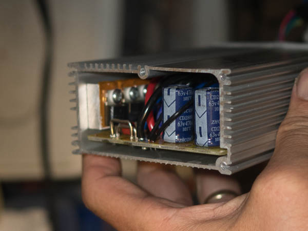

This is different from saying that a 36V controller will be reliable at 48V. If it only has 50V capacitors, the capacitors will eventually blow up with time. However, some controllers, like my original ebikeling 22A does use 63V capacitor. so it could be over volted.
The gotcha is that my ebikeling LED unit won't display the battery level. It will stay "Full" and it won't shut off the 48V battery at 40 volts. It will drain the battery down to 36-38 volts and let the battery's low voltage circuit take over. Not good for the battery. So I did it once, noted my speed went from 20 to 24 mph, and went back to 36V.
