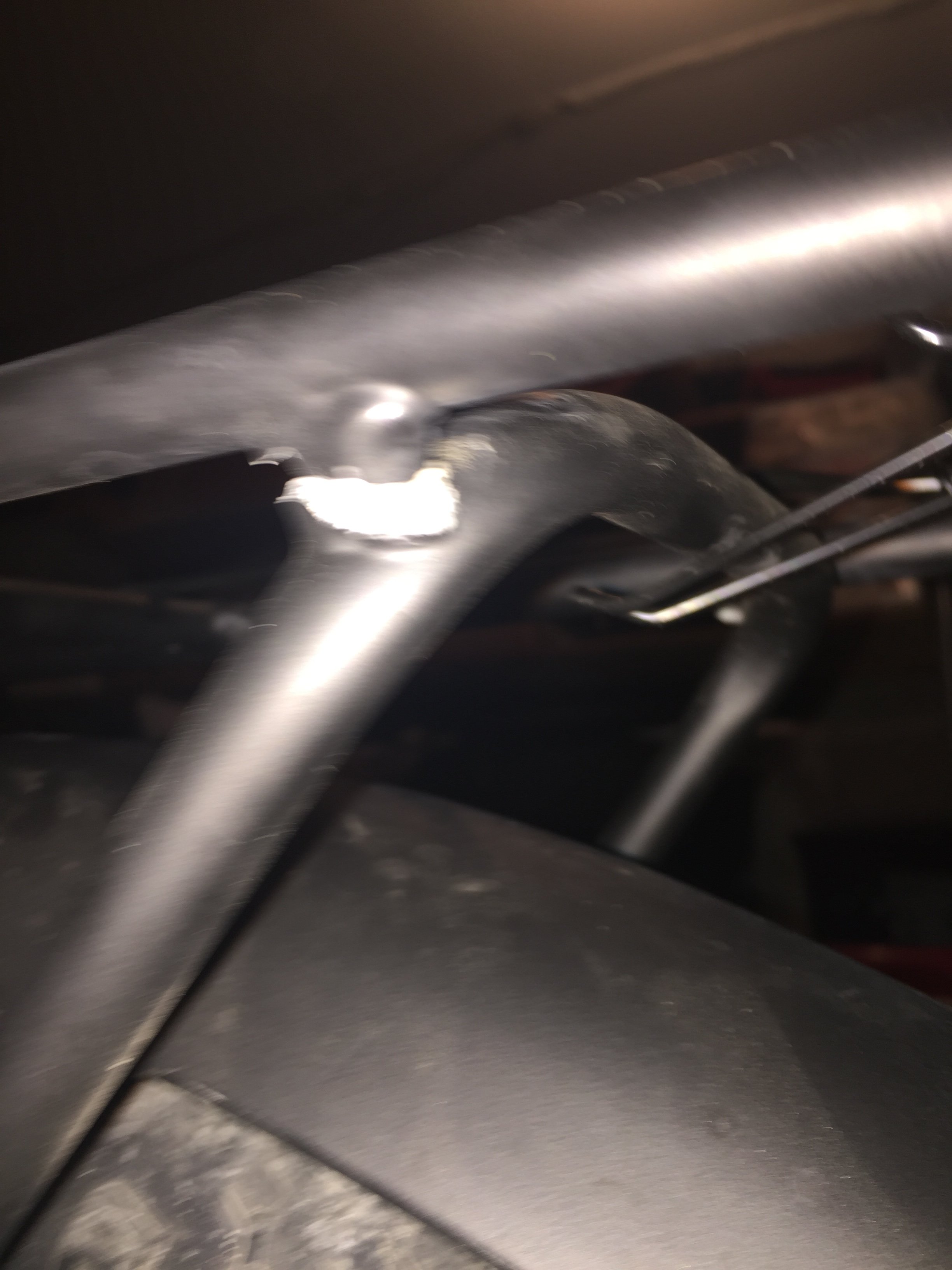

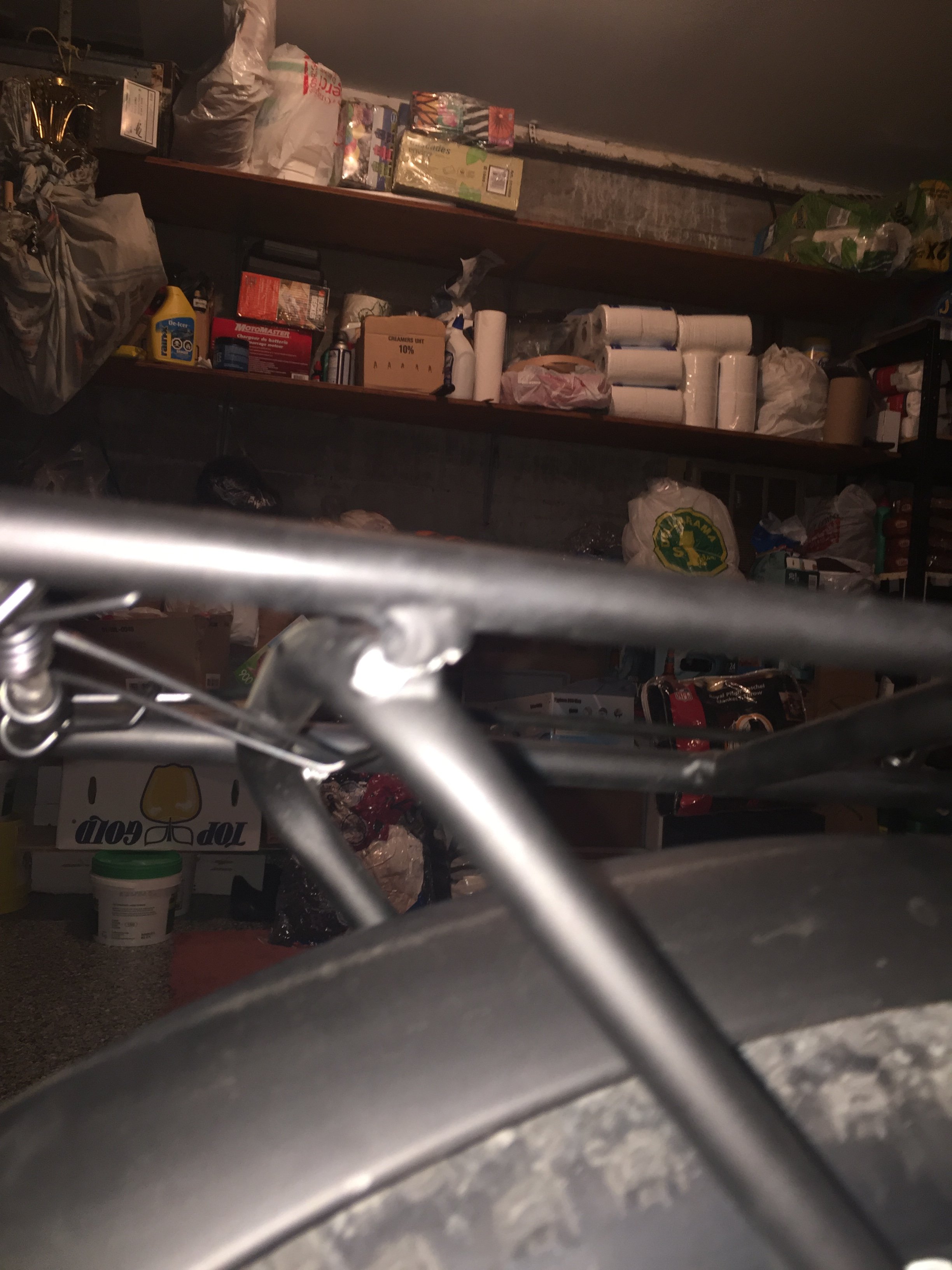

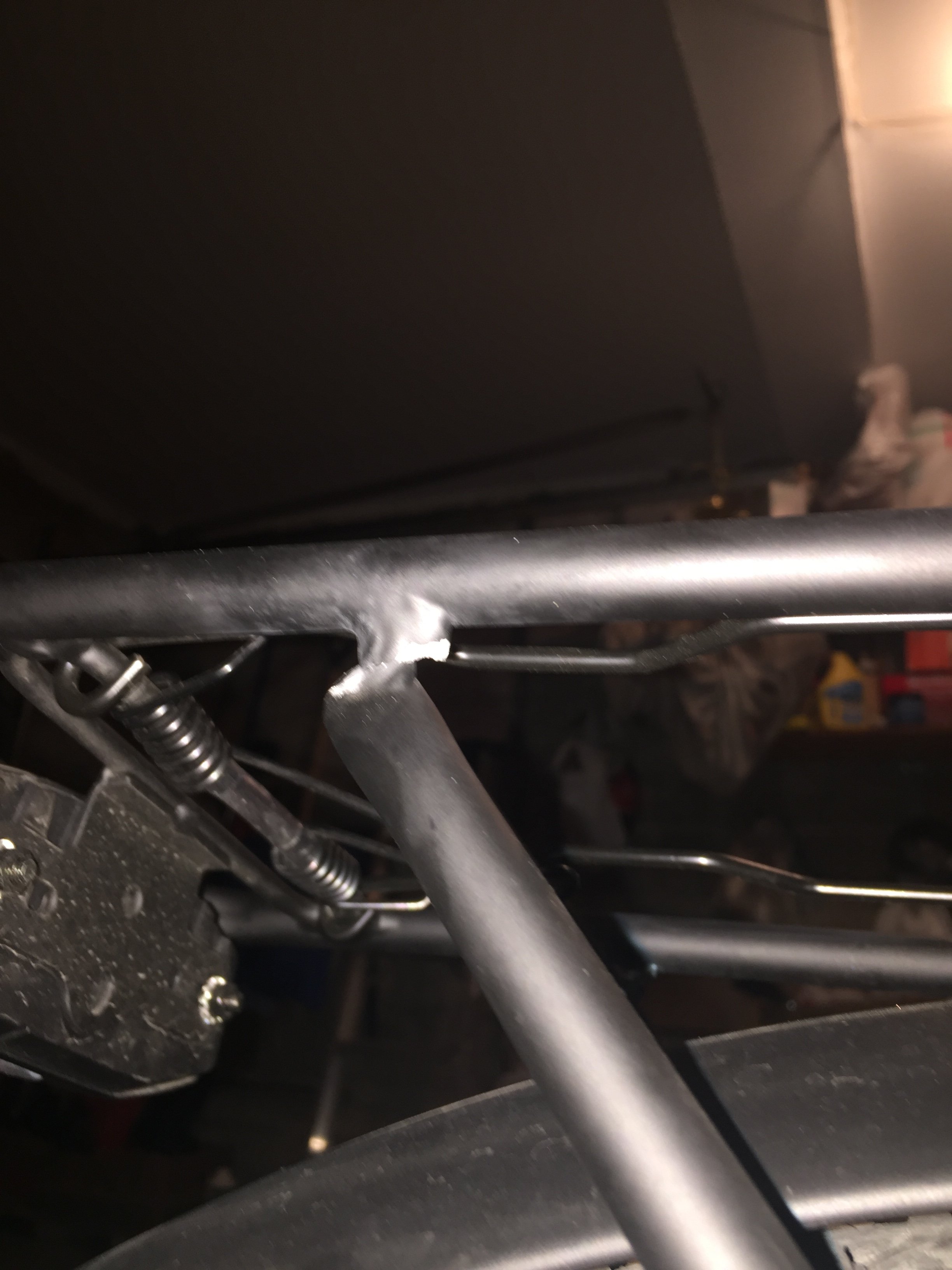

Here are pictures of the first 2 cracks on the rear rack:

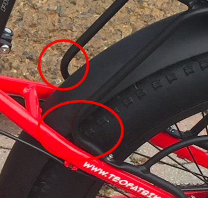

The next 2 cracks were on the front down tubes. Don't have a picture of that one but Here is where they cracks were circled in red:

Thank you for the pictures,
i`m no expert in welding aluminum however looking at your picture that looks to me like a really poor welding job (too much heat was used while welding the two parts together) and not a material stress fail, that should have been covered under warranty.

Thank you @Redskulls for the pictures. But like @AguassissiM said, this is poor welding job. Normally the weld should be to strongest point after it is done properly. It may crack next to it but not in the middle of it. Well it is made in China after all... I believe the other two crack at the bottom only happen because of the first two, which will increase stress at those point, you weren't getting anymore a proper weight distribution.

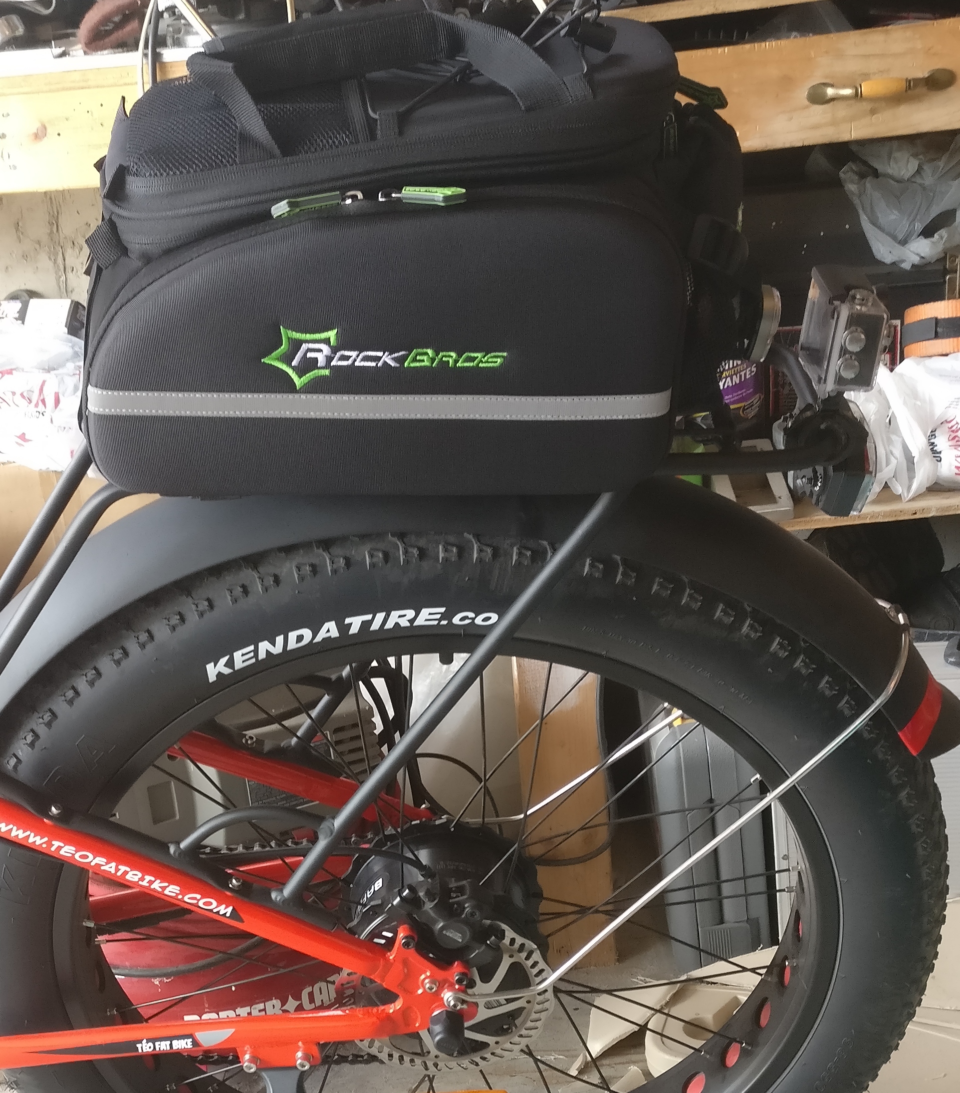

On the original rack I was only using the trunk bag, my panniers would not fit on the bars to clip in:
Also took a picture of my bag with all items, and as you see the scale says 3.7, I also added all my lights in the bag even though when riding they aren't in there:
Now I am running the Evo back and 2 Louise Garneau panniers with no issues:
