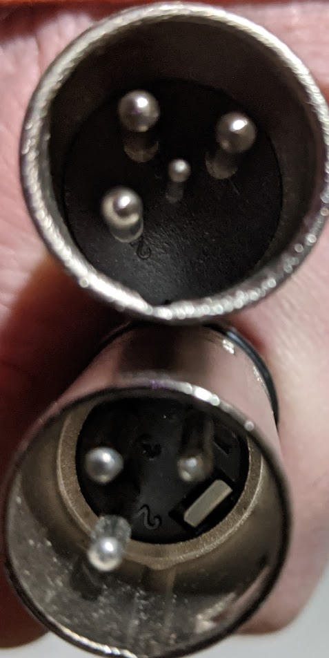

I'm not sure that the AliExpress charger referenced will work that iZip's battery.
I have a 7 year old iZip Sumo, and while its connector also looks like a standard XLR, it's not.
The iZip (TranzX) has a narrow pin in the middle that the XLR doesn't:

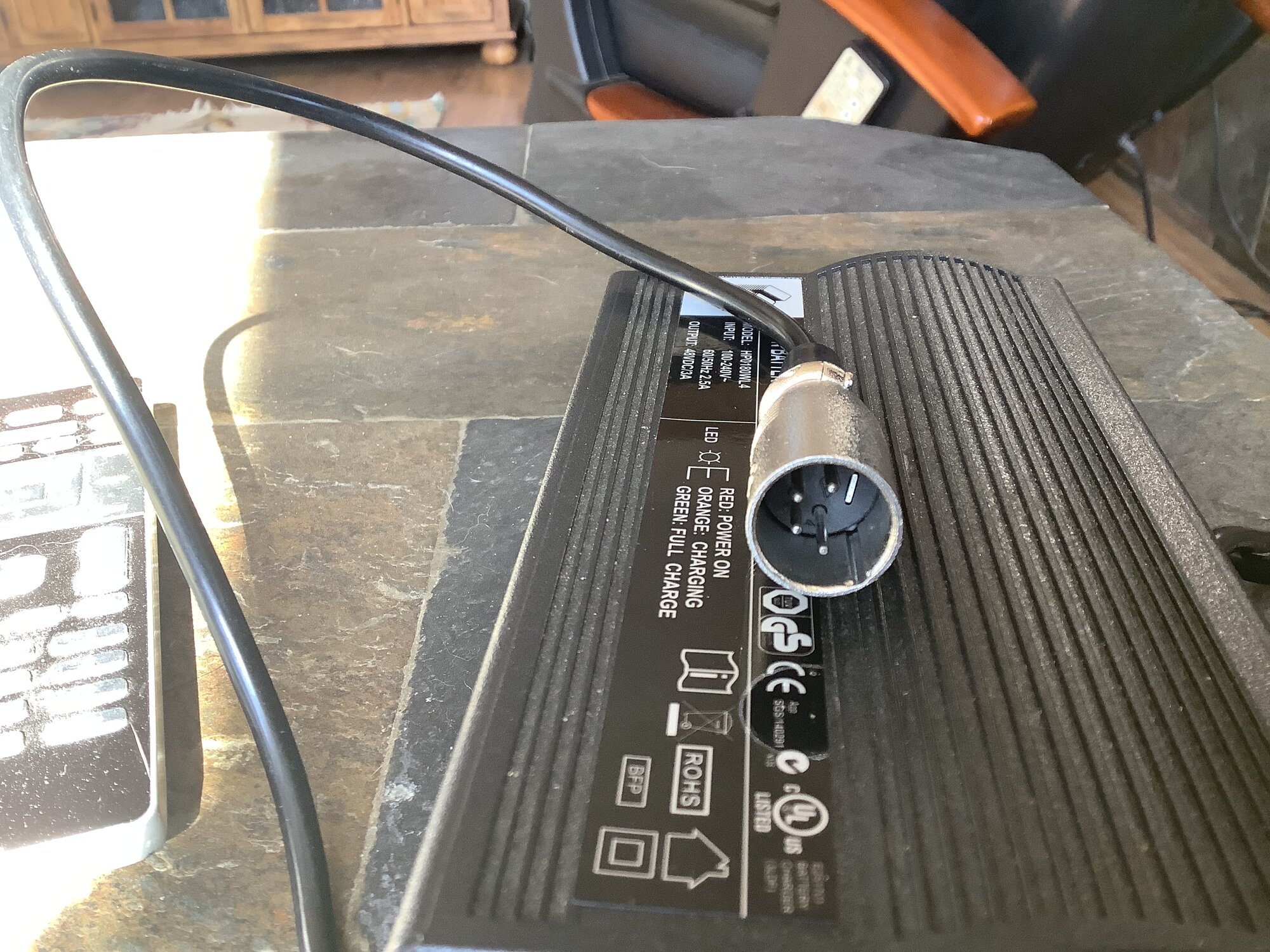

Anyways, is this the charger you had?
That looks like a generic Chinese charger with XLR connector.
You can buy this on AliExpress.
That is the charger, but the one from Ali Express will not work. I have four pins on my connector and all the XLR connectors I see online have three. You wouldn’t want to sell that battery charger would you?

where are you located KAMS?
if you are Socal local I can look at the charger and figure out why it isn't working. I can even assist in rewiring it if need, so that a regular XLR charger works on it. I have some experience with this (30 years in the automotive industry and the past 15 in the electric car space.)
basically the charger needs a positive and a negative and only uses 2 of the 3 or 4 pins. problem is that many of these chinese made chargers use different pins, some use 1/3 others 2/4 even others 1/4 etc.
need to look at the battery port and the charger port with a multimeter and figure out which of the 4 ports are being used and which are positive and negative.
I have multiple batteries for my 3 of my e-bikes and all of them use different chargers and pinouts. I re-wired all of them so that they used the same pinouts so we could use any charger on any bike. Even batteries from the same company one battery came pins 1/3 and the other pins 1/2. no consistency and no standards.
feel free to PM me if you want some help. I believe we can get the bike back up and running for you provided the battery hasn't gone 100% flat.
