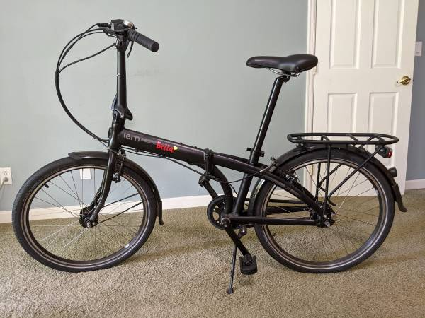

Throwing this out there since you have experience building bikes. For a commuter IGH might be preferable to a derailleur system.
As an example this Tern IGH on CL is $600 and IMO would be an excellent commuter bike.
or this one with Alfine 11 speed IGH and disc brakes for a $1000 asking

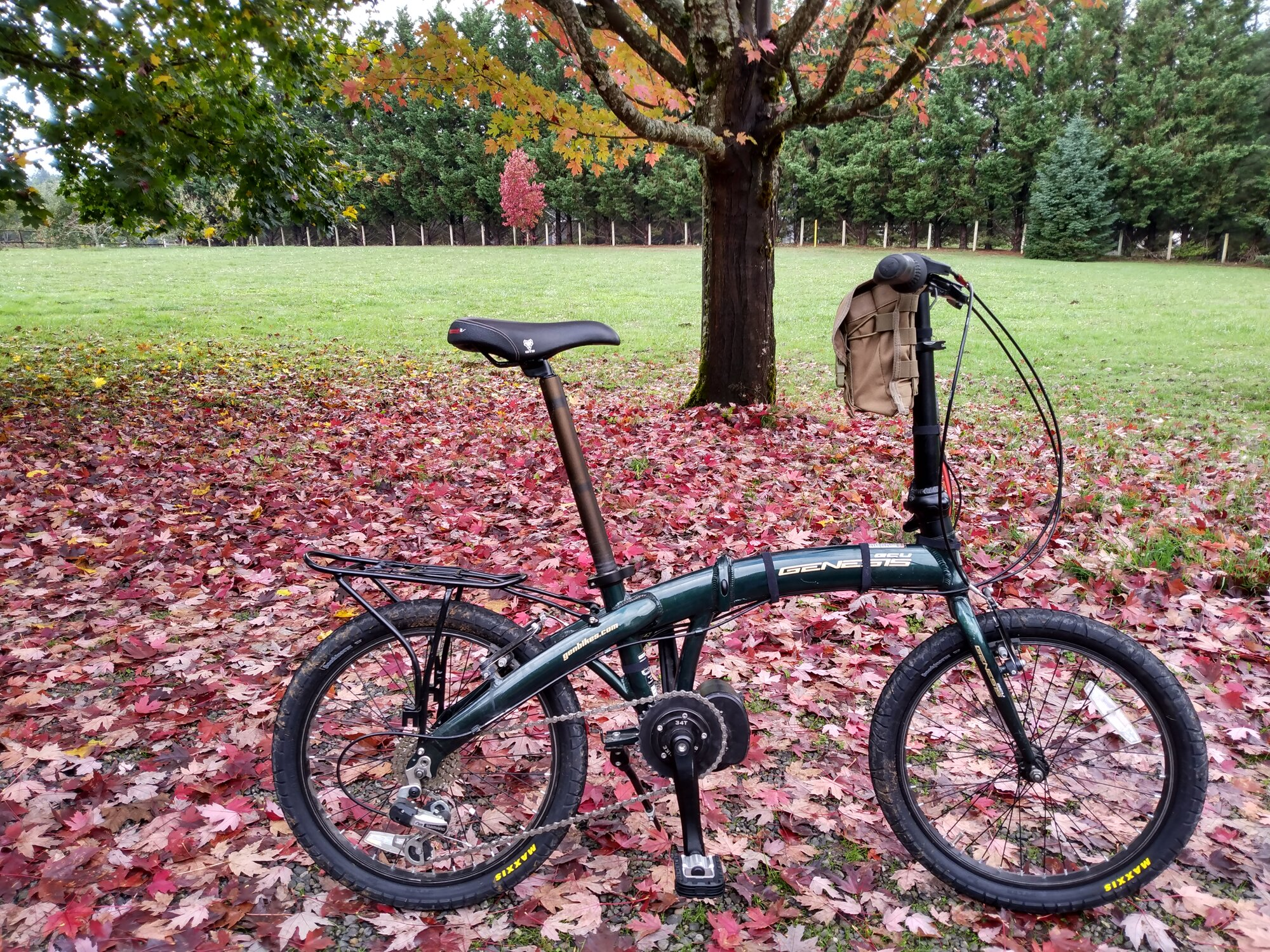

And install a Tongsheng TSDZ2 torque sensing mid drive or a front geared hub motor if you prefer (although traction would be a concern riding in low traction road conditions). Ignore the members that post how difficult a mid drive is to install (some of those poser posters either never installed one themselves or needed a bike shop to perform some simple task like removing their bottom bracket cartridge).
UL certified battery for an aftermarket is more challenging but UL certified power tool battery could be used and with only a 20 mile round trip commute should be adequate, especially if you can charge at work. Just a thought, PS you can use a throttle on a tsdz2 if you choose a compatible display.

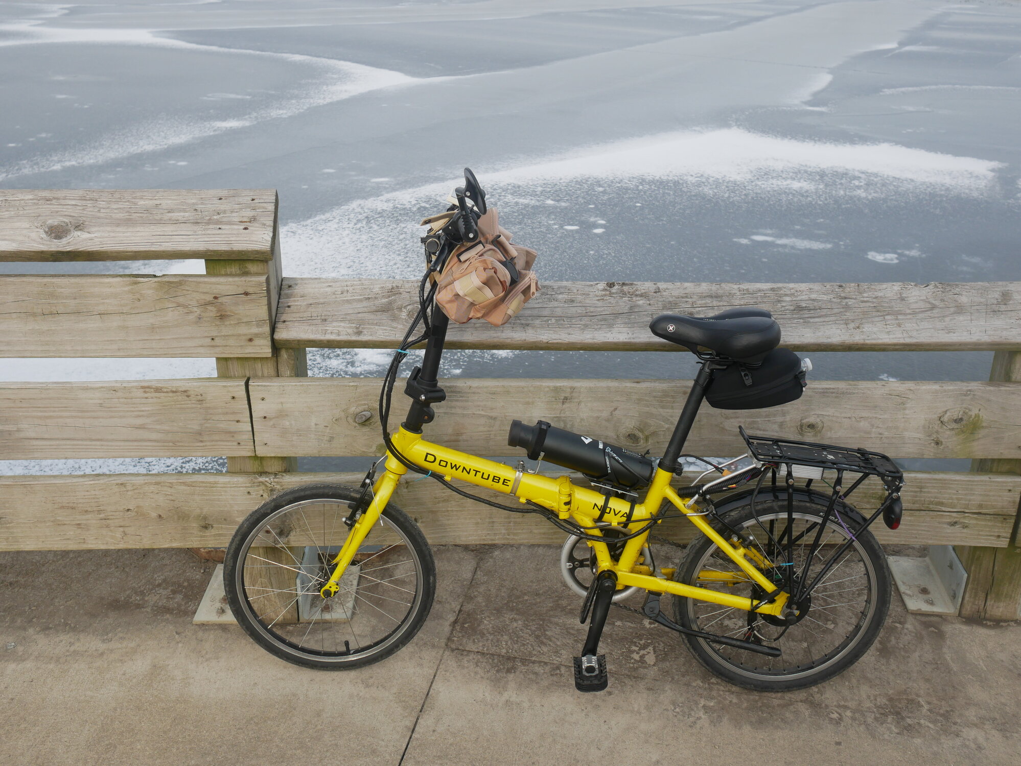

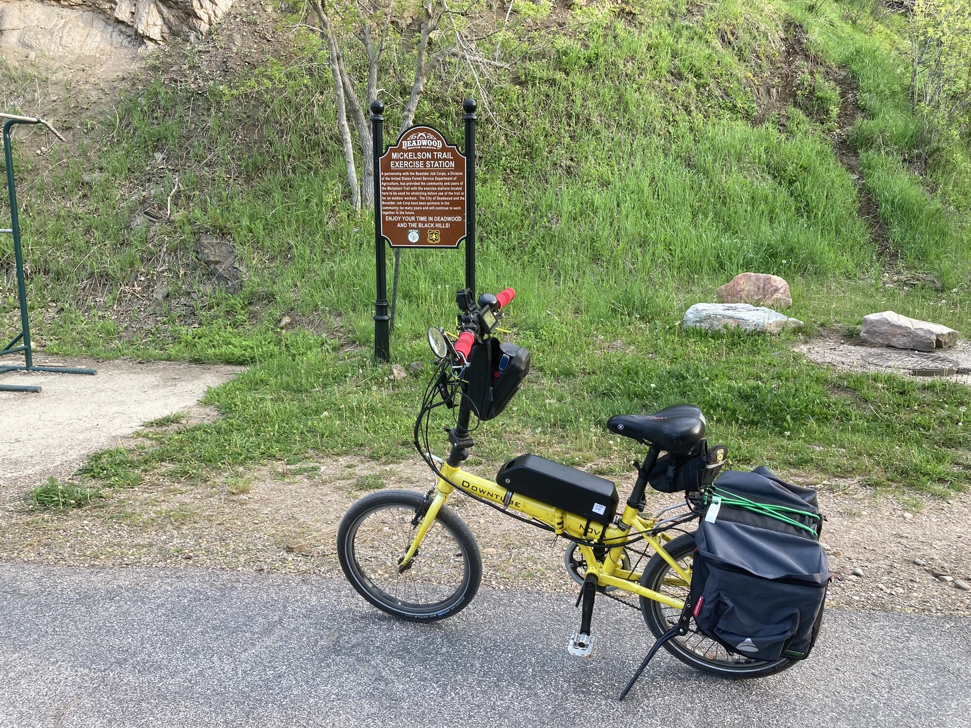

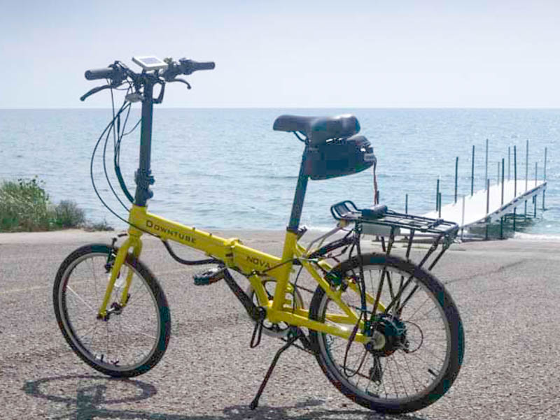

By the way. I'm good at spending other people's money. I could never pay $3600 for an ebike. Here's one of my DIY folders with three battery configurations. First one is a tool battery under the seat for 15 miles, Second is my everyday bottle battery for 35 miles. Last is a downtube pack for 50 miles. The last two installations prevent folding, These could be installed on EMGX's bike. Oh yeah, pretty light too,
The tool battery is safe. The others less so. I've got close to 5000 miles over six years on the yellow bike. Originally a $300 Downtube Nova. Rear wheel kit about $300. Being DIY, I've had the electronics get flooded. Broken the displays about three times in accidents, Let's call it $1000 in labor.
