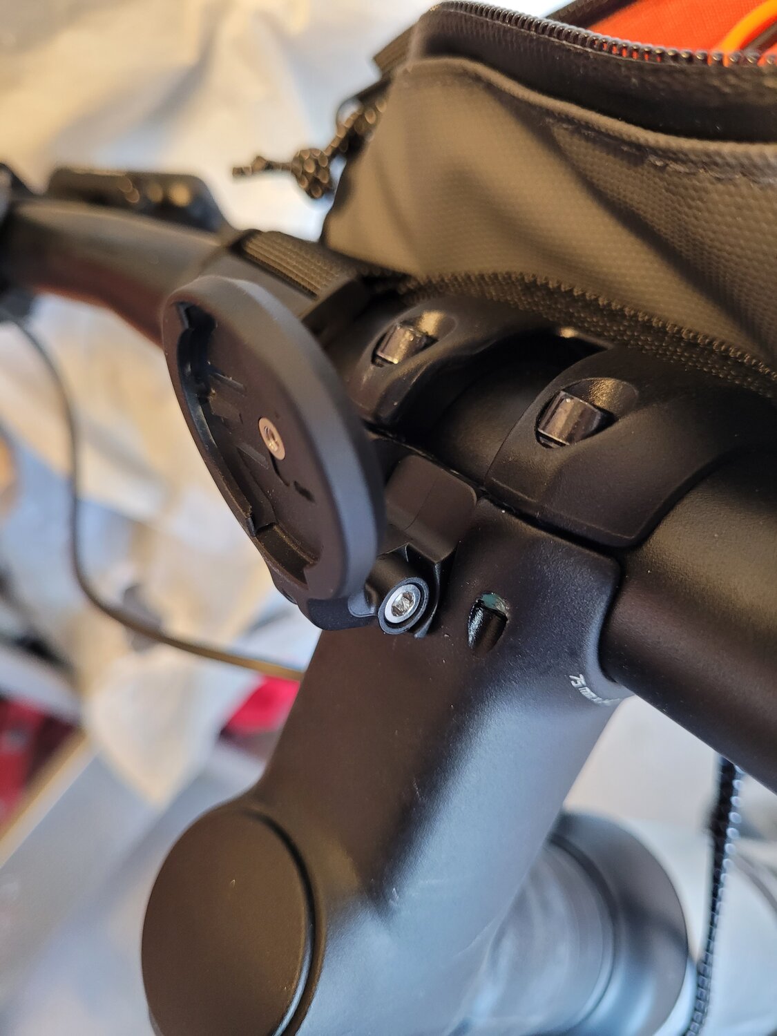

I have the 2022 Vado SL that includes a TCD/Garmin Mount. Initially I thought it was great. I'm using it with my Garmin Edge 530. After riding a bunch, I'm not so sure. Do you all use it? If so, any way to tighten it down more?
I've found that the connection to the stem is a clip that doesn't seem to be able to be tightened, so it wobbles around a little. Also, the hinge that allows it to be angled is really hard to tighten, so that it doesn't move when going over bumps.

Already took it apart. Removed the bracket. Decided I didn't like the little hole where the bracket was. Since I had the bracket out, I secured it with some removable glue so it doesn't move around Not sure if it will last, but I'll try it. Put it back together already.

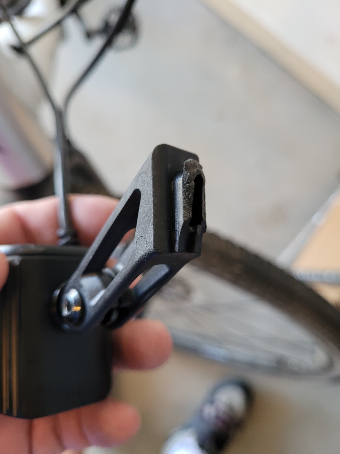

Yeah. My light bracket just broke on my ride. 😢

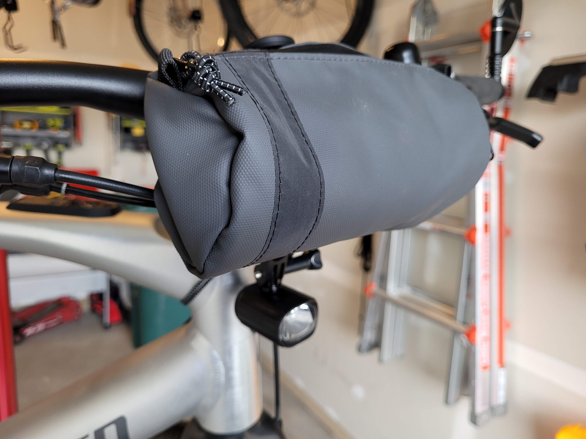

Looks like the light uses a GoPro type mount. Ordered this from Amazon in aluminum. I got the extension 9cm so I can have the light lower, so it doesn't interfere with my handlebar bag. Disappointed in the crappy bracket quality from specialized though.

Mine broke while I was riding. Could have been agrivated by my handle bar bag, but I didn't have anything heavy in it at the time. Maybe just because I was riding a lot of gravel roads.
My Vado SL came with a little plastic 'thing' which fitted into the slot left in the stem after I removed the mount. Check the bag of miscellaneous bits supplied with the bike.

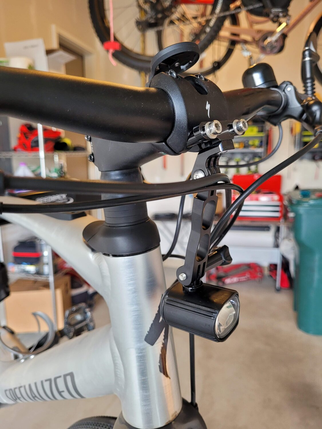

Here's the aluminum light mount from parts off amazon. I had it a little farther down so it didn't interfere with my bag.
