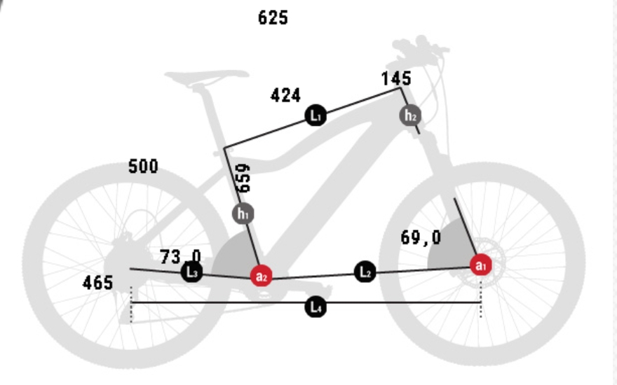

Pardon the n00b question, but what does the "60cm" refer to? Is that the measurement from the bottom of the seatpost to the bottom bracket?
That would be the seat-tube, as in H1 below.
BTW that is the frame of the BH Easy Motion Evo 29'er mentioned above. BH offers better than most frame geometry information online. I've owned the 29'er for about 1-1/2 years, and I'm 6'2", 190 lb. It's a tall bike with a long wheel base, not unlike an extra large road bike. I added a few comfort components like a BodyFloat. I love the bike, fits my size better than most bikes I've owned.
