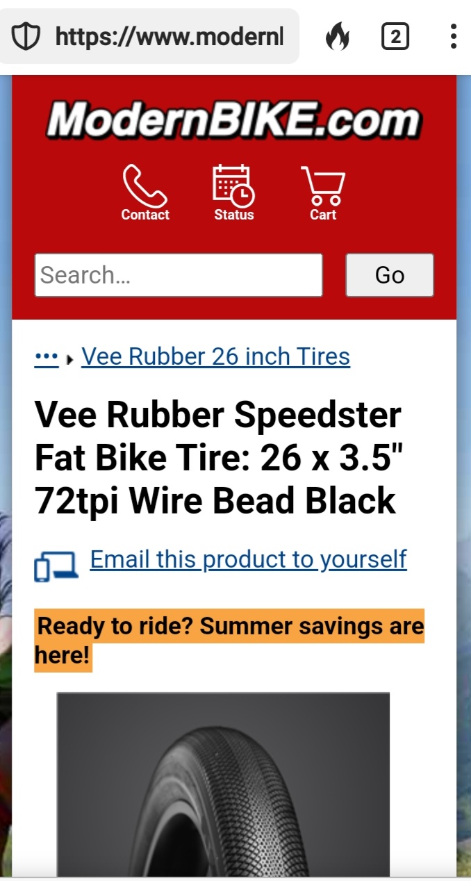

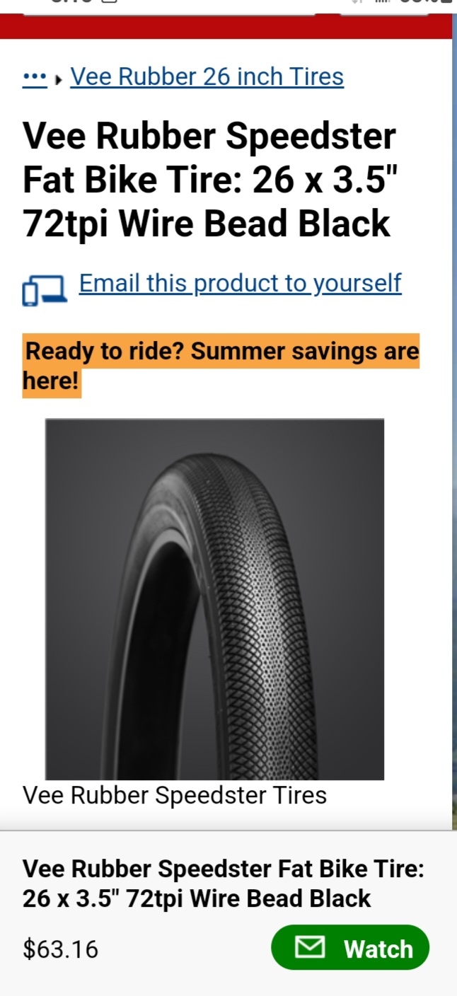

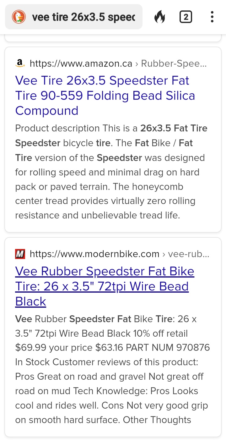

I did find one tire that I am going to buy for my next tire,..
Apparently it fits our fat rims.
It is a Really Efficient tire with a Really Long tread life.
It comes in different TPI (thread counts) and is available in both folding and wire bead.
I'm going to go with the wire bead tire because our original tires have a wire bead.
I can remove and install my tires with no tools, just my hands.
I don't trust a folding bead to stay on the rim without popping off.
I'm pretty sure that the wire bead version is tougher and more durable but it is heavier than folding.
It's cheaper too.
Keep in mind that it is a 3.5" tire, as aposssed to a 4.00" tire, so your speedometer will be off.
Your speedometer will be reading faster than you are going, and your top speed will be reduced.

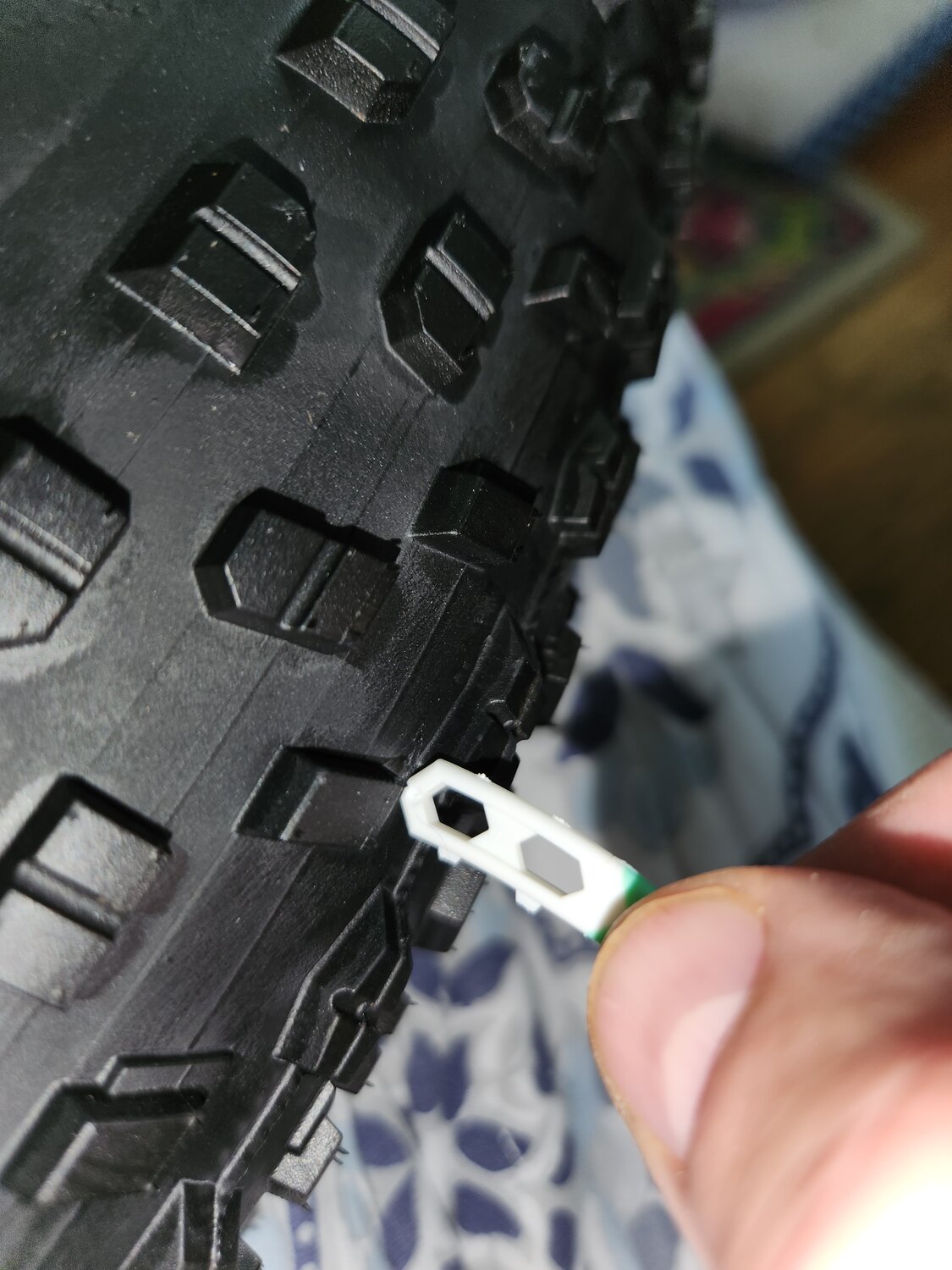

i ended up buying these and am waiting on delivery, hopefully the knobbies aren't going to get in the way. they don't look that big but who knows. we'll see and i'll let u know. I did see those other tires and that will be my next option if these don't fit. i also saw them in a 4.0 instead of a 3.5.

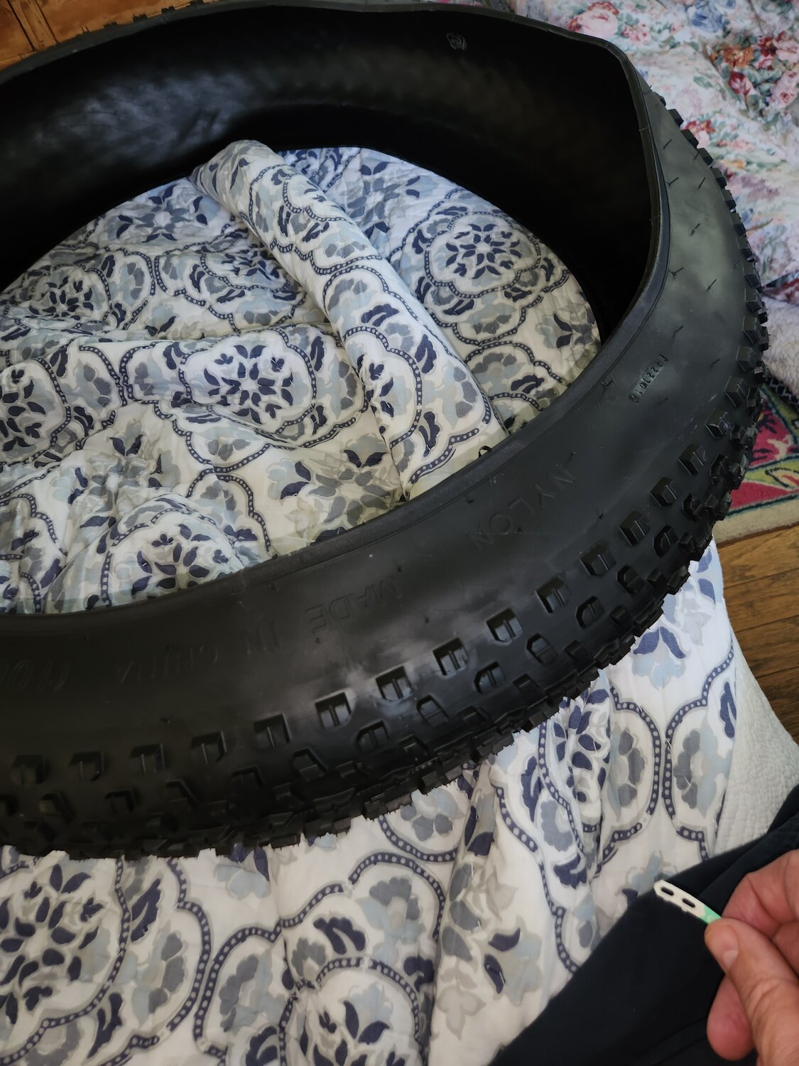

Tires and tubes got here today. I'm gonna have the lbs do it for me but I'm leaving tomorrow for a week so it will get done when I return.
From the look and my measurement they should clear the fenders. The knobbys are about a 1\4 inch and the fender with the OEM tire has more than that. I'll let u know when I return.

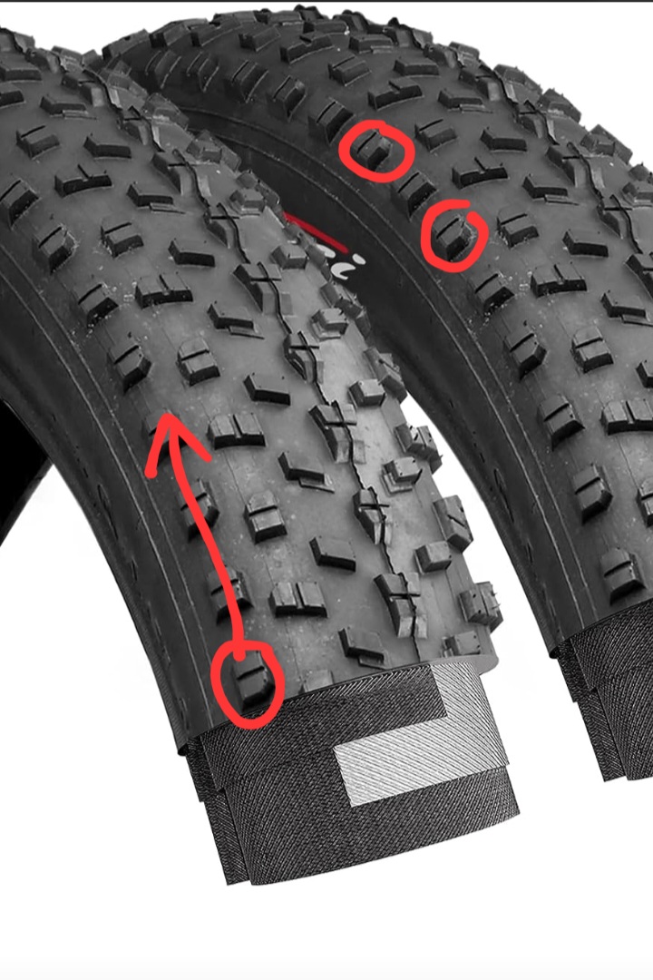

View attachment 161836View attachment 161837

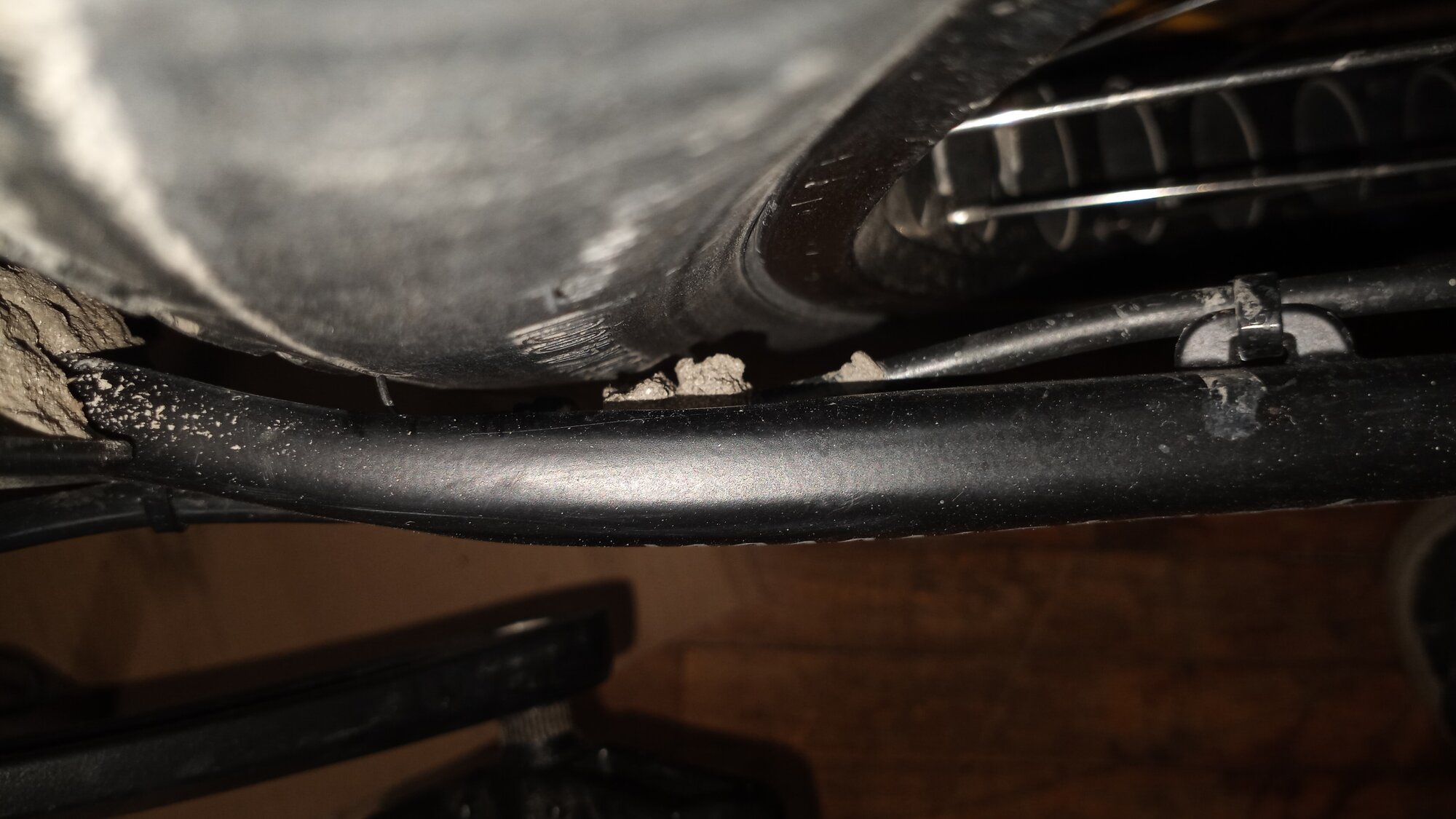

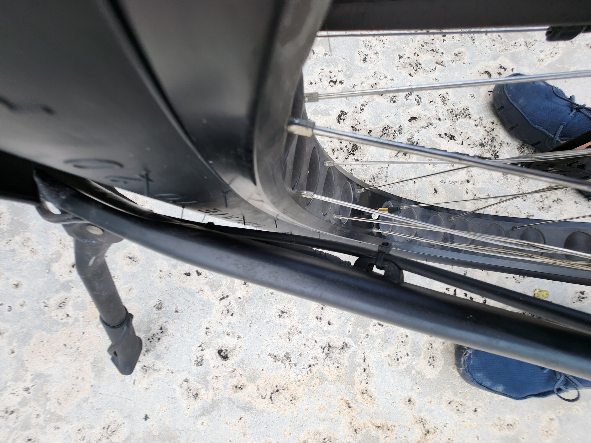

It's not the fender, it's the frame clearance.
If you have knobbys going up the sidewalls or your tires, they will probably hit the frame.

Thnx on the foldable lesson, it's gonna be close but from my basic hand measurements and eyeballing of the sidewalls it might make it.
On the OEM tires I've had 3 flats riding on road and I saw these have a 30 tpi so I'm hoping maybe it will be less. Time will tell.

It's these knobs here that might clip the frame,..
There was a YouTube guy with a T1000 that installed knobby tires on his bike but he had to cut the knobs off the sidewall so the tire would clear the frame.
I doubt that an LBS would be willing to do that though.

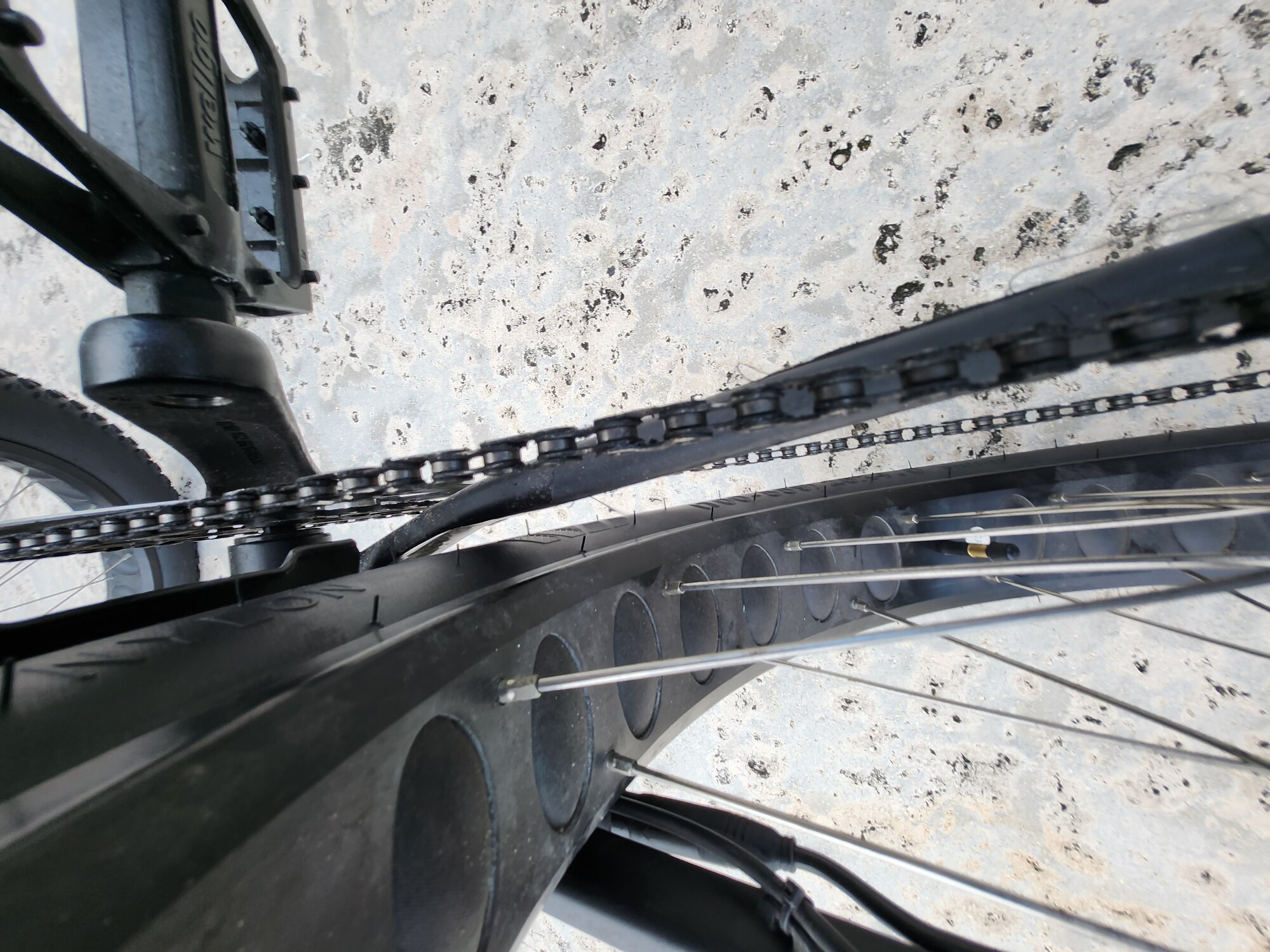

I got all carried away worrying about getting a flat, so I installed Tannus inserts, Mr Tuffy tire liners, and FlatOut in each tire.
I spend $350 CAD on flat protection. 😂

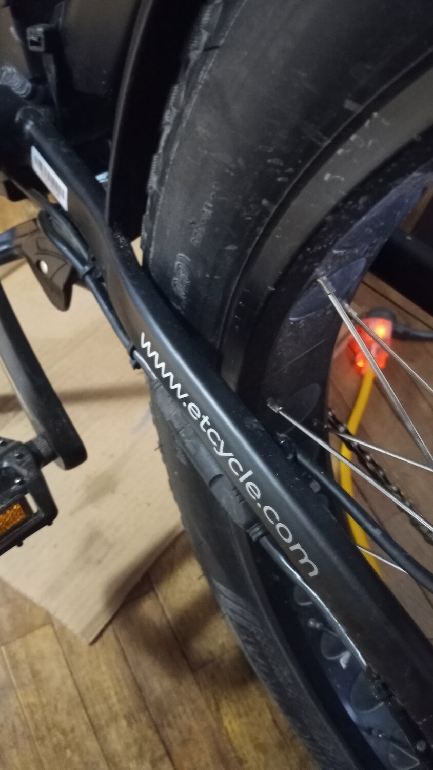

They fit perfect, no issues at all. It looks like they actually have more clearance on the frame than the oem
Wow !!
I didn't expect that.
I guess that just about any 26"X4" tire will fit our T1000's ?

I spent $220 CAD for Tannus inserts specifically because they say that you can ride on a flat tire at 6 mph to get yourself home.
That's not case, at least not with 26"X4" tires.
I didn't realize that until I deflated my tires to install the inserts and the tires just fell off the rim, then the bead gets jammed in the frame so you have to lift and carry the rear end of the bike.
My Tannus inserts were a complete waste of money.

Sorry been swimming and lifting the last couple weeks and finally got the bike out. Rides perfect, no discernable buzz noise or any for that matter that I noticed ( though I am a little hard of hearing at 61). Resistance difference was not noticable but again I'm not that tuned into what really goes on when riding. I put the earbuds in, crank up the music and do my 10-15m on the beach road.
So I'm happy overall, tires were very reasonably priced and they ride fine for my needs. Hopefully I can get more than 1k miles out of them ... and no flats!
