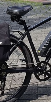

Jonathan55, The Cirrus Body Float is the only way to go, period. :)I recently purchased a Trek XM 700 e-Bike ( which I absolutely love) , but
for me it was like sitting on a stump. I have a bad disc in my back. The bike was so stiff I was going to have to return it...I installed a Cirrus
Bodyfloat Seat post and I could not be happier. The Bodyfloat is amazing. A fantastic piece of engineering.. It 'saved' my $3500 bike. Good luck.
