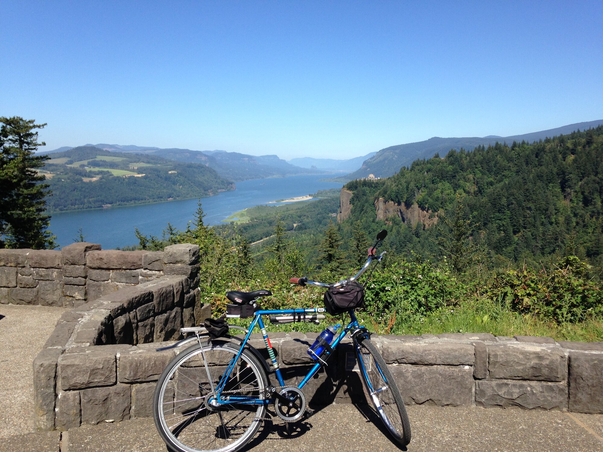

This is a Sears 10 speed bike that I got when I was 13 years old. Back then they were made in Austria. It had been sitting in a shed for decades until I decided I wanted a 3 speed coaster brake bike so I removed the drop bars, shifters and 27" wheels. Replaced the wheels with 26", rear with a 3 speed coaster brake hub. I put a larger rear cog on the hub and since this picture replaced the chainring with a smaller one so it is geared very low in 1st gear but high enough for leisurely cruising in 3rd. I love the bike and thought of putting a Tongsheng mid drive in it but I don't think it would fit the bottom bracket. Someday, for nostalgia, I might put the original parts back on it, but that day might never come either.
Thanks! I guess that would be a ~22% hill? That is indeed pretty steep.

Well, as you probably suspected, my "guess" on elevation was pretty far off. After exploring this afternoon, armed with an elevation app on my phone, I calculate the grades of six hills to range from 6% to 12%, with three of them above 10%. Walking up these, they feel plenty steep. I know they would on a bike!
It will fit. This is a standard 68mm BB shell. Great Bike!

It has been a while since I measured the BB but it sticks in my mind that it was considerably smaller than 68mm, maybe I got that wrong. A throttle with the coaster brake version of the Tongsheng would force the pedals to rotate with throttle use, that might feel somewhat strange, sort of like a fixie bike when the throttle was active maybe?
If the TS fits on this bike's BB I might have to buy one.
edit:
You're right PedalUma, the BB is 63mm. I replaced the original 2x chainring/crank assembly with a cartridge assembly several years ago and should have remembered that it was a standard cartridge. I'm looking for a TS coaster brake version at a reasonable price. So far found recycles-ebike.com who I think is US based but has dropped shipped from China. Anyone have experience with them?

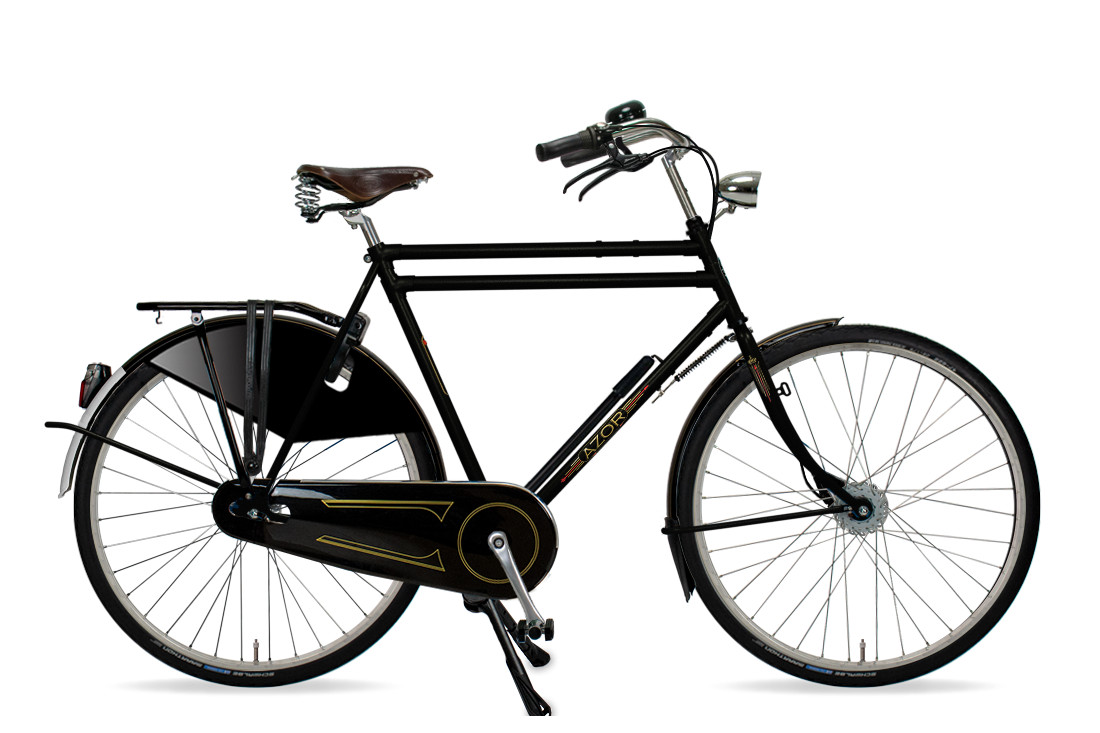

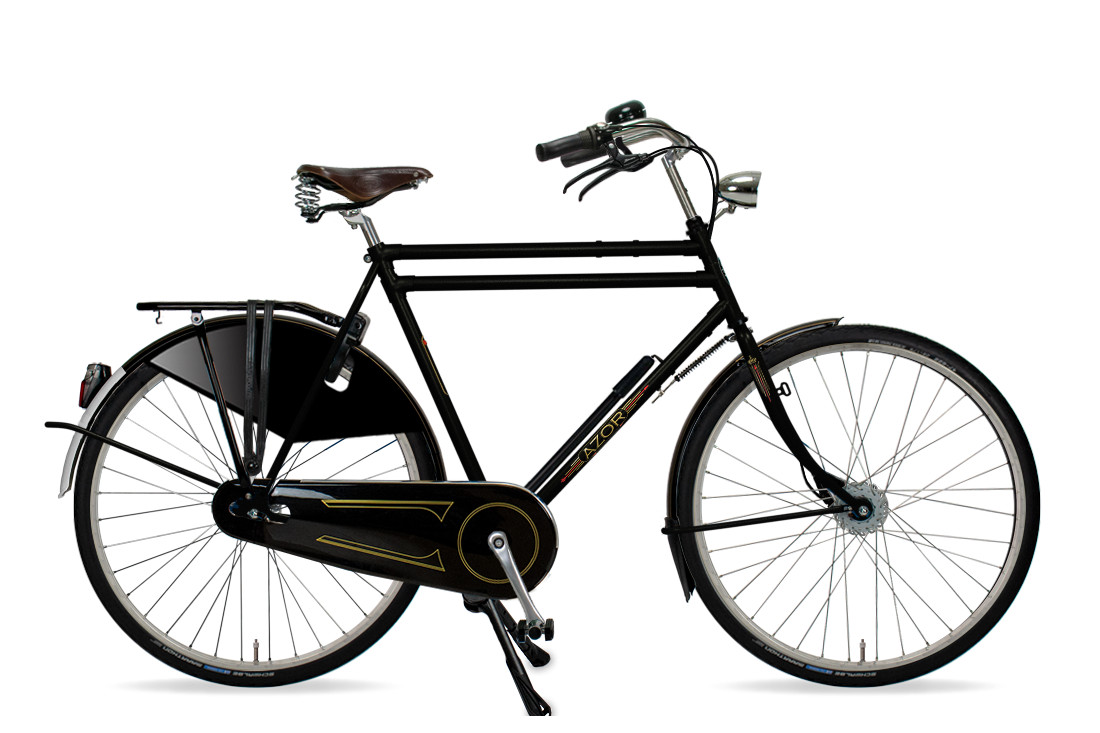

Why not hydraulic brakes ? , you are describing putting weight on the saddle not handlebars, correct ?
Yes, Art Deco. The rider's weight would shift back to the saddle for a Dutch upright riding style.
So minimal pressure on wrists. Why a "coaster" foot control brake instead of a finger activated brake?
Some people with wrist and finger problems, pain and weakness like the security of using their feet instead of a brake lever to stop. It also works in wet conditions and is sealed from getting bumped or dirty unlike discs.
