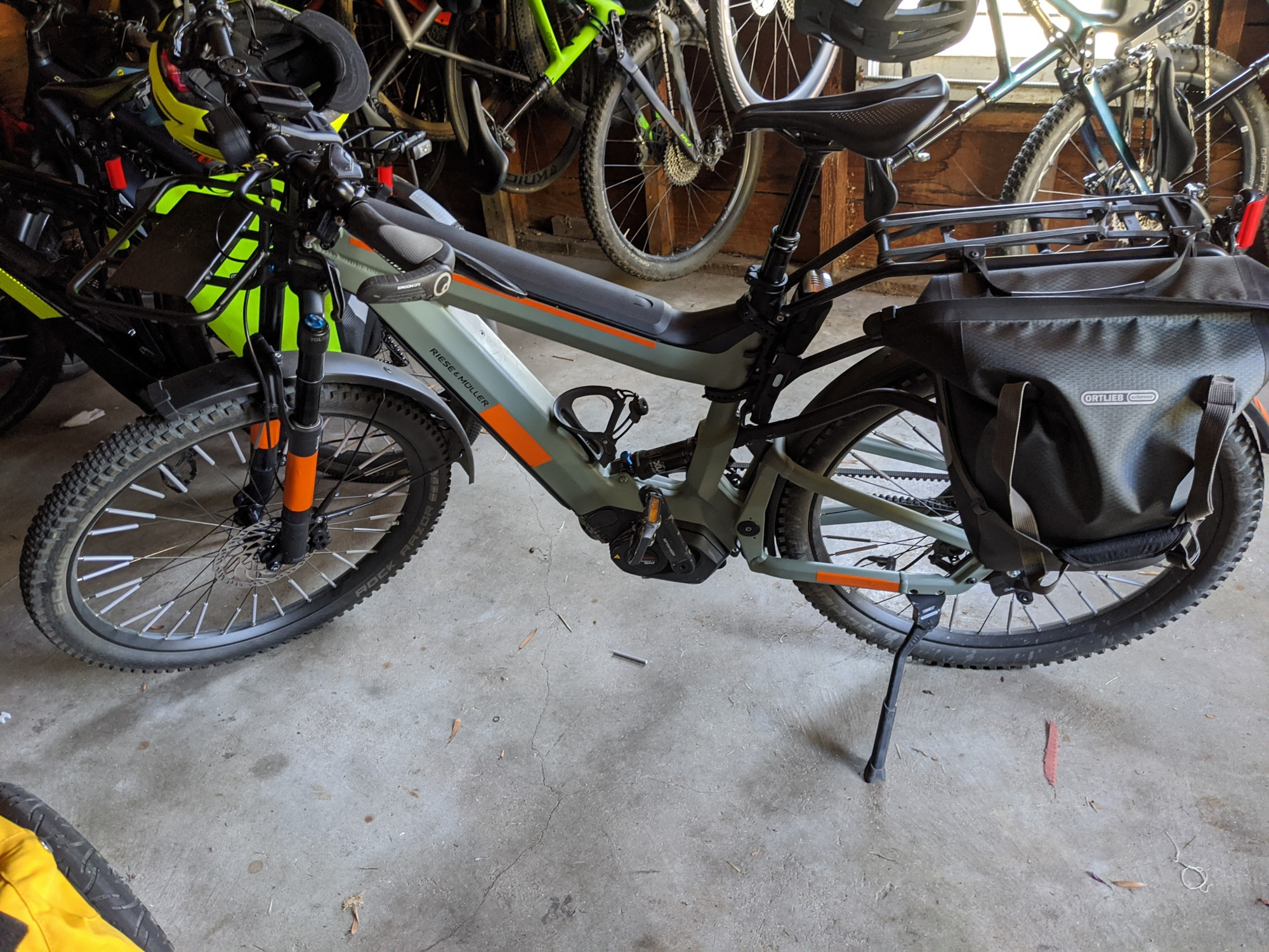

I bought a Superdelite GT rohloff HS a couple of weeks ago. Other owners might benefit from some of my alterations:
  • Rearranged the position of the controllers to be closer to handle grips
  • Fitted an Abus Granit X Plus 540 With USH Bracket underneath the front holder. I used a velcro strap to help take the weight
  • Replaced the standard pedals with Deity TMAC Pedals - they are very grippy and quite light. A close second choice was Crankbrothers 7
  • Replaced front and rear wheel axels with Hexlox:
    • Front: TA15QLOC Black_A2
    • Rear: SKEWER_Black_Rear_1HLX
  • Added hexlox bolts to seat and seat post - you don't want someone with a hex key to make off with your bike bits!
  • FItted Topeak RIdeCase for my phone
  • 15 cm Charge cable from Kiox to iPhone: Meenova Lightning-to-MicroUSB Cable
  • Ortleib 3.1 rear pannier holders and bags:
    • Ortlieb Commuter-Bag Two Urban 20L QL3.1 Pepper
    • Ortlieb Back Roller Urban Line Pannier Bag

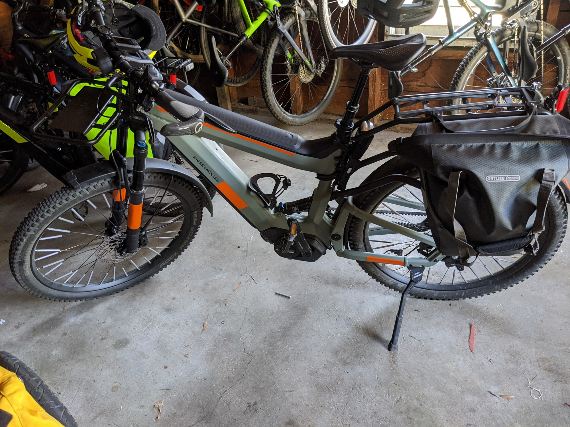

In the US drivers seem really distracted so I work pretty hard on visibility.
  • I applied 3m reflective tape in lots of places.
  • 3m Spoke reflectors
  • Knob Cobber rear light mounted on the rack. I used epoxy to make a mount.
Pedals: I was having pedal strike issues when cornering hard, so I replaced the pedals with Shimano PD-T8000. The pedals are asymetrical so the bottom side is much shallower than the top. It haven't had pedal strike since. I occasionally ride with cleats. I'm careful when I do.

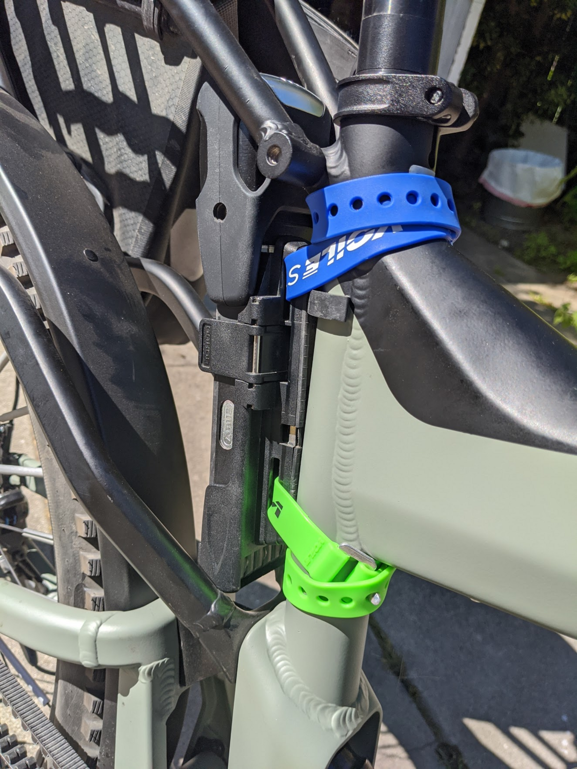

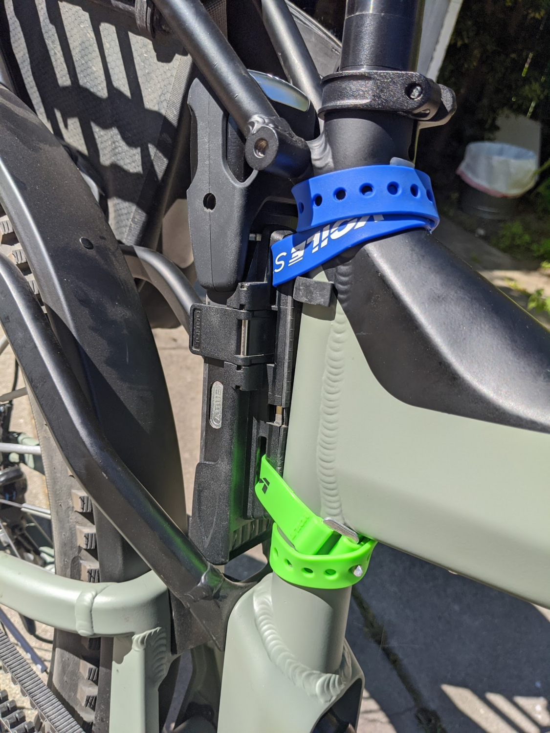

ABUS Lock Mount: I wanted to use the bottle cage, so I mounted the ABUS lock behind the seat using volie straps (and a rubber spacer on the top. Seems quite secure and freed up space.
Bottle Cage: I really like the looney-bin bottle cages. They can hold all kinds of bottles (from thermoses to nalgene).
I'm still looking for a front bag. Anyone have any suggestions?
Lloydt. Nice mods. I have a SuperD GX on the way. What model Ortlieb pannier is that? Does it mount well on the rear rack? Where did you get those nifty straps you uses to remount your lock? Sorry to pepper you with questions!
I is the ortlib shopper bag (https://ortliebusa.com/product/bike-shopper/). Mounts easily. I really like the 'Zip' open/close. Has a nice shoulder strap that can't get caught in the wheels. Wish it came in high visibility.
I ended up using two of these (Voile Straps - 15" Nylon Buckle to mount the lock): https://www.amazon.com/gp/product/B074HWY517/ref=ppx_yo_dt_b_asin_title_o06_s00?ie=UTF8&psc=1
In order to get the lock mount to be snug against the frame, you need something to push the mount out a little from the frame. I used a Garmin Rubber handle bar mount gasket. Basically, you need some kind of rubber wedge to make it work well.
