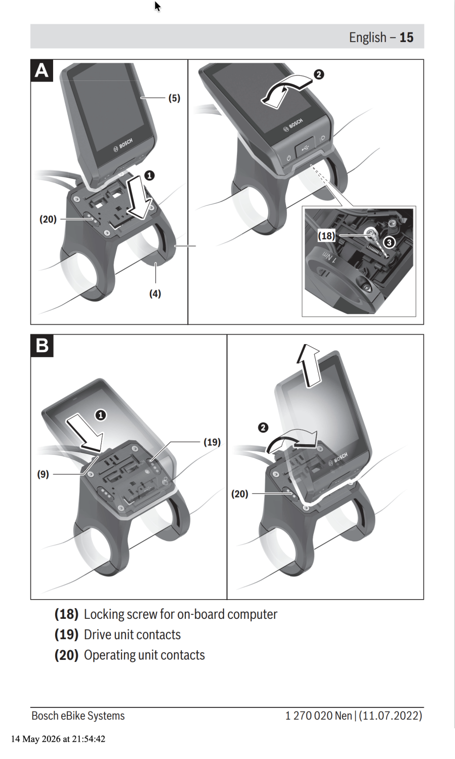

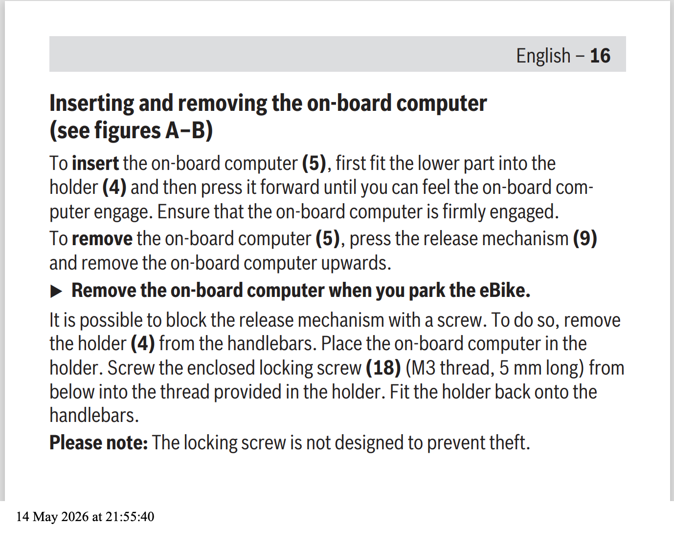

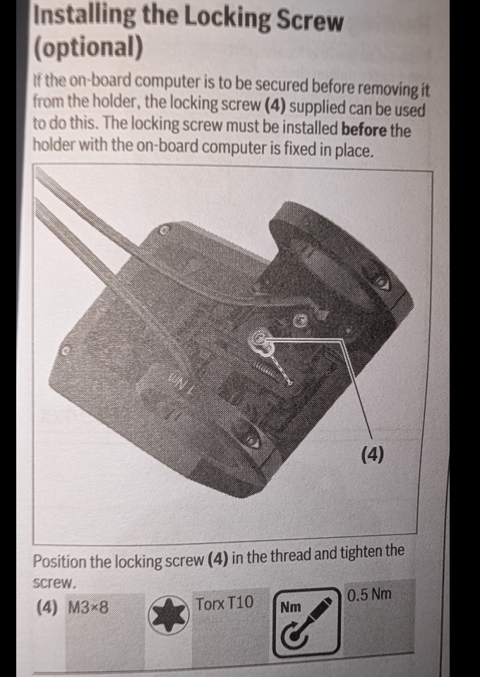

If it's the standard mount, there is a m3 security screw you can put into the mount that prevents the release mechanism from moving, effectively making the mount and Nyon a single unit.
@Aushiker is your R&M one with a custom mount in the handlebar, instead of the stock Bosch mount? If so, I have no idea...
If it's the standard mount, there is a m3 security screw you can put into the mount that prevents the release mechanism from moving, effectively making the mount and Nyon a single unit.View attachment 209988
Standard mount, but thanks for your help. You seem to on to the very solution I was looking for.. It looks like the same approach is used as with the Nyon 2. I should have read the manual :)
the problem is I find you can have issues if you never remove it. I had it screwed on for awhile and I came out on the coldest day found it dead. the battery connections can stop working if it does not get removed once in awhile.
