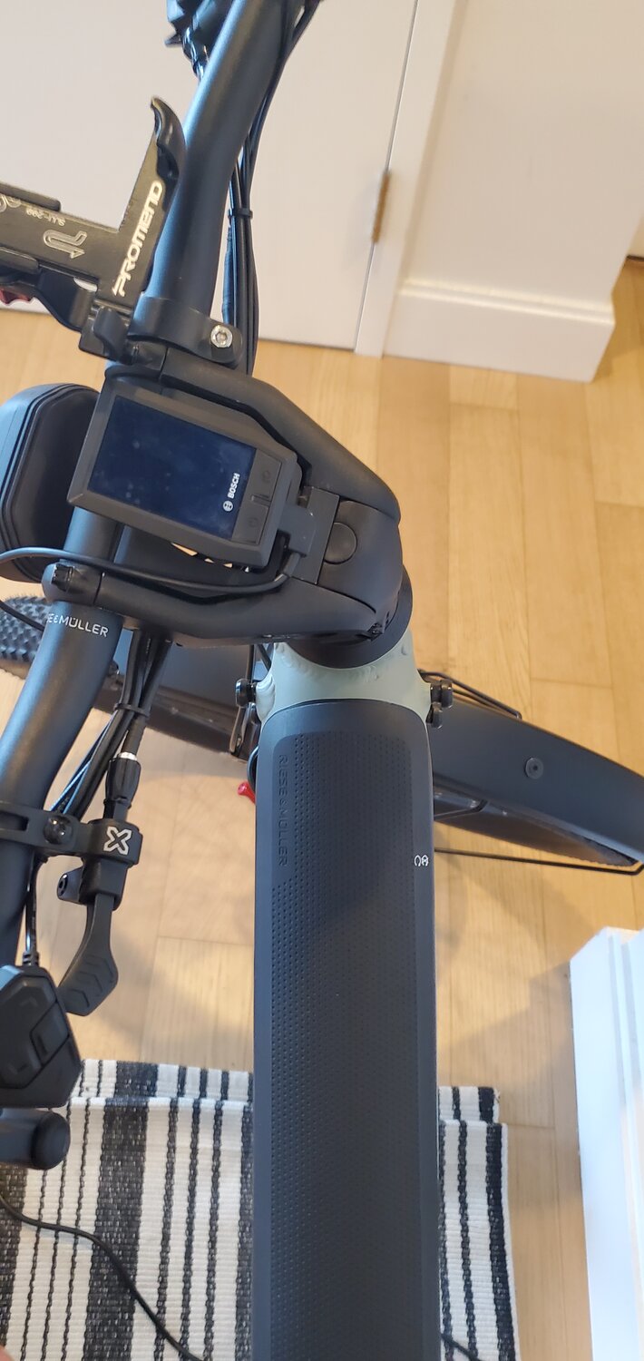

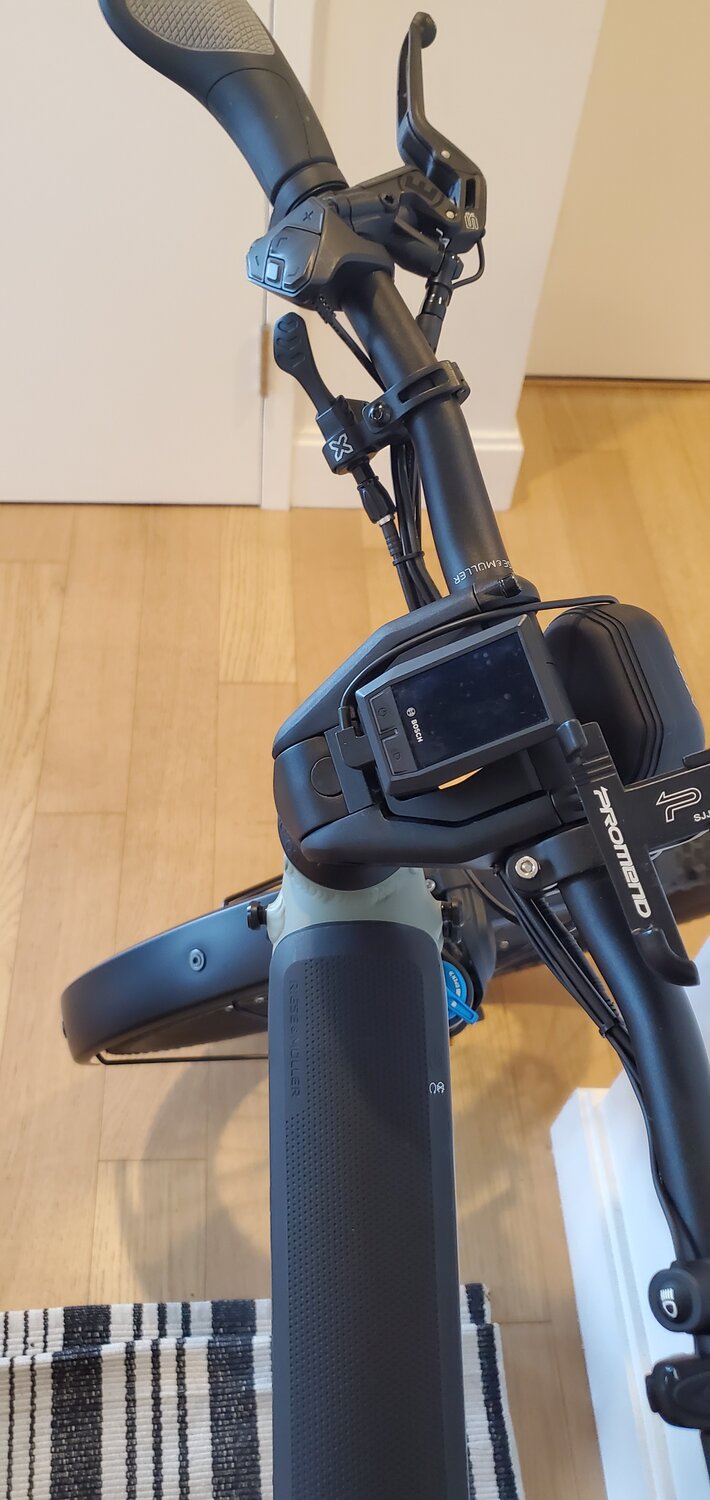

Greetings, I just noticed this and am wondering if this is normal. My bike's handlebars can turn ~95 degrees to the right but only ~40 to the left, is this normal?
Left:
Right:
Steve, I've had that problem with my Homage. I 'fixed' it by forcing handlebar to turn the extra amount to the left/right.

Surprised. Your bike is supposed to have AZX-221 ACROS Blocklock installed, mine is AZX-220 with the adjustable 3mm hex. Yours may be so off-center that the recess is hard to see?
There is no visible adjustment hex bolt, turns out my LBS doesnt know how to fix this either. ACROS does not have instructions posted for my Blocklock. LBS is reaching out to R&M for assistance.
EDIT Aug 11, 2020 : Had a huge wipeout, riding on pavement, while making a left turn the limiter (which was way off, as seen in the orig. post) slipped again, turning the wheel far more than the handlebars indicated. Waiting on LBS to fix this cause the bike is a death-trap until I have confidence that the handlebars accurately depict and control the wheel angle. Wheel turning radii are closer to normal now!
Road rash is THE WORST!!
new turning limits after crash, still no idea how to adjust/tighten this:
right turn
left turn

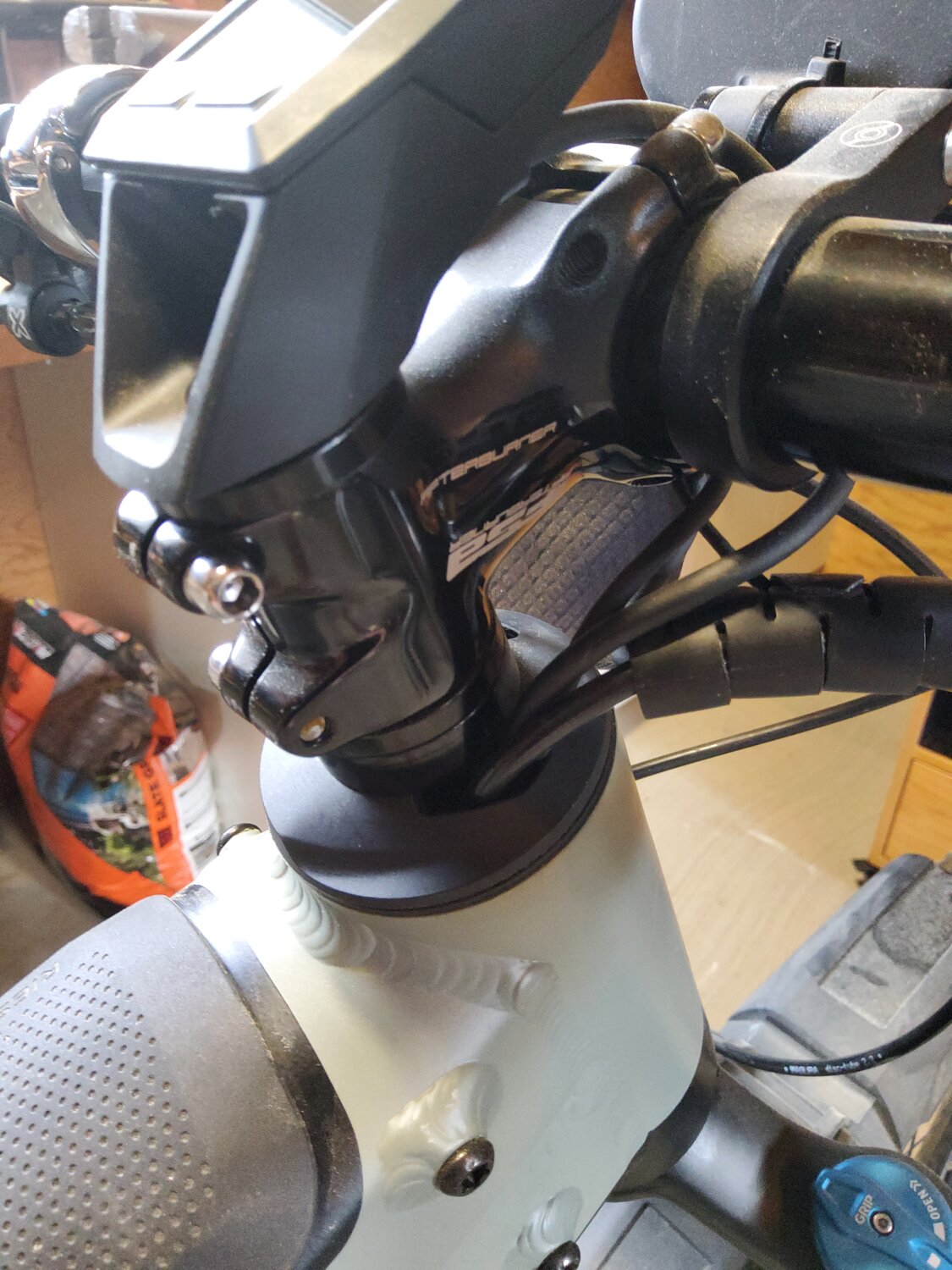

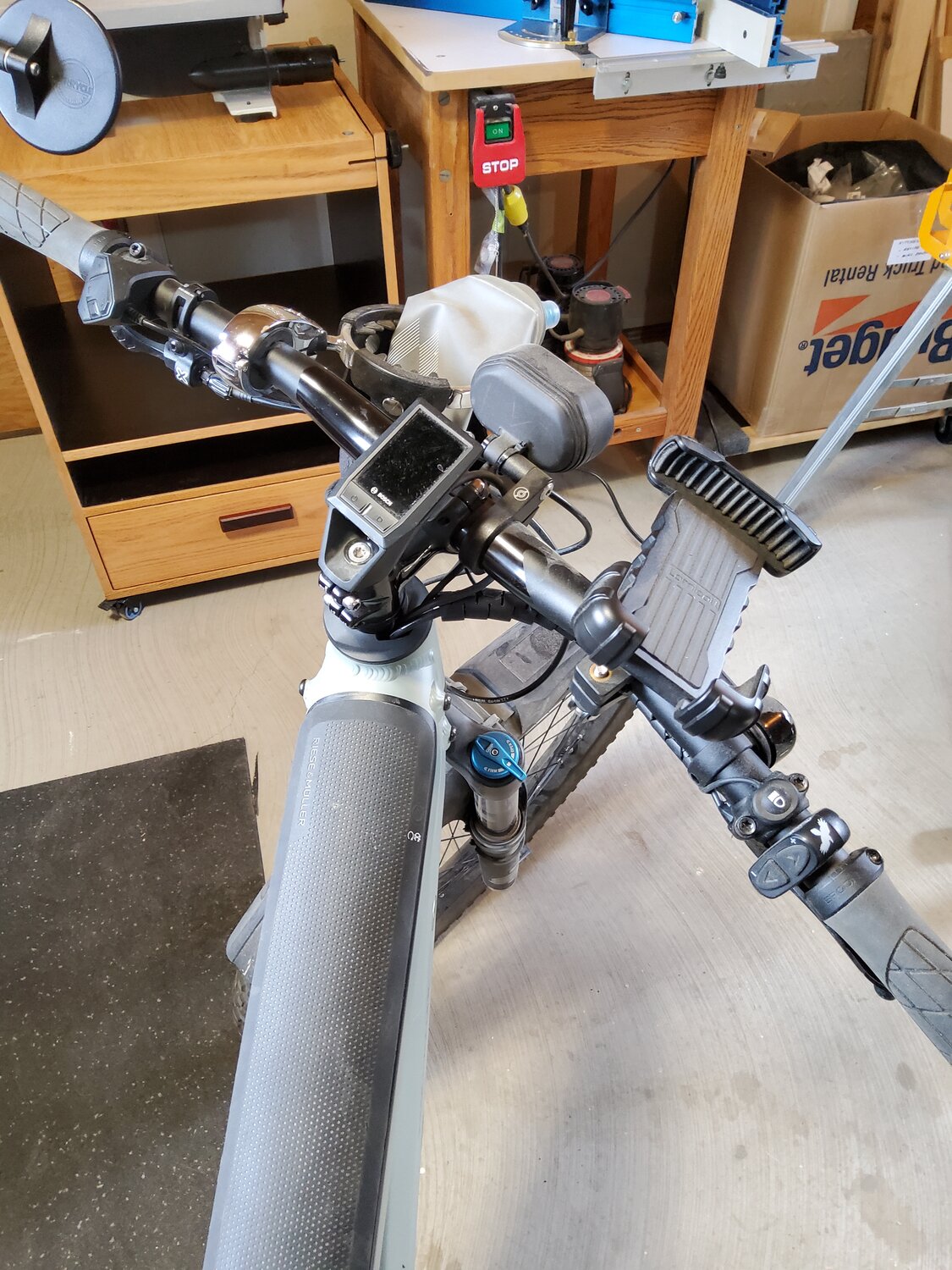

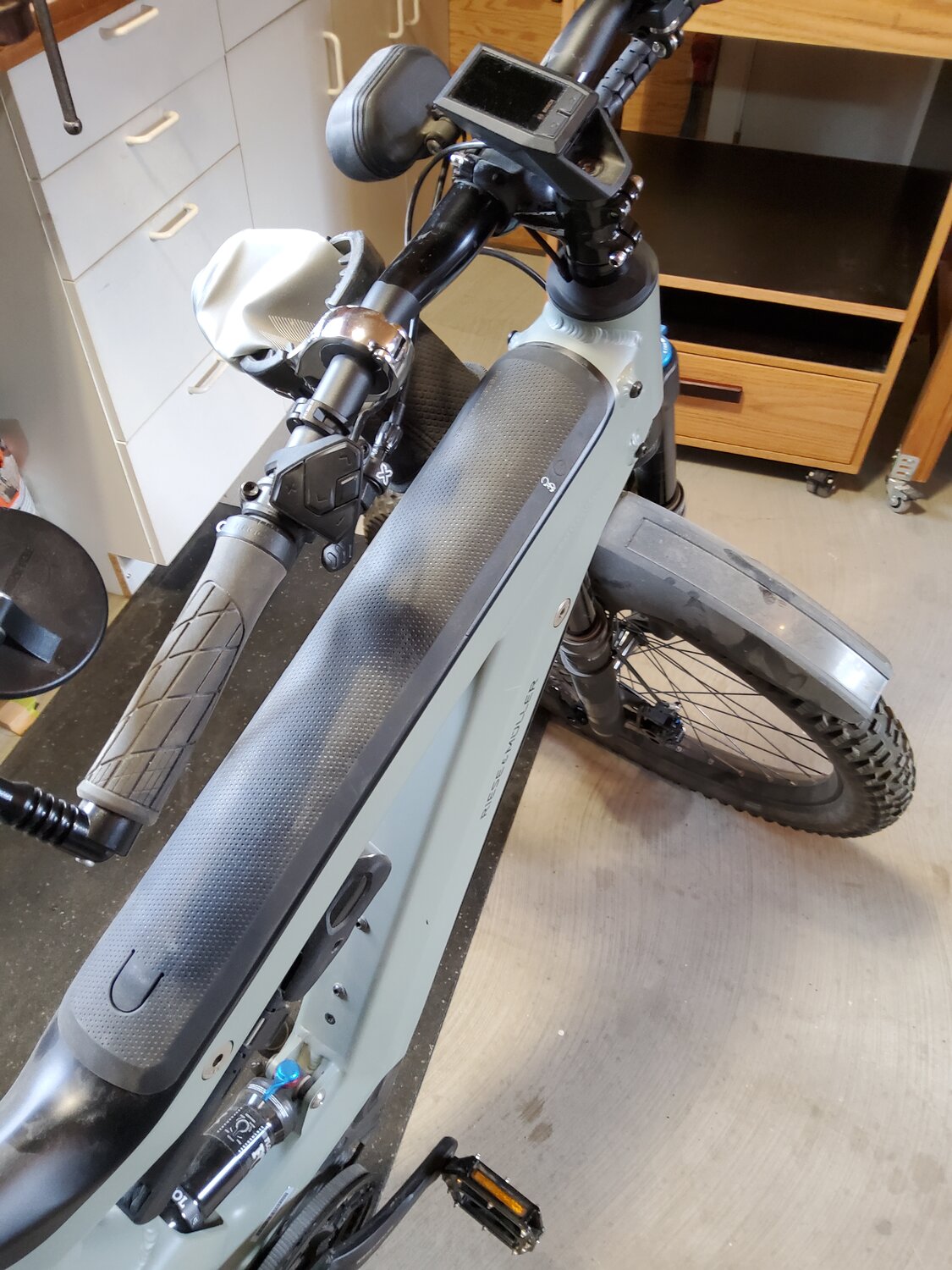

I am having the same issue with my 2020 Superdelite Mountain. Worried about safety now. No local dealer so need some help if there is a solution
The limiting mechanism is built into the lower section of the headset on MY20+ R&Ms - Either your bottom headset cup or your crown race were installed off-center or were shifted by the impact of a fall/crash.
It may sound brutish, but the easiest way to fix this is to slam the bars hard in the direction you want to move the limit to nudge it. The alternative is having your lower headset cup and/or crown race removed and reinstalled center at a shop.
