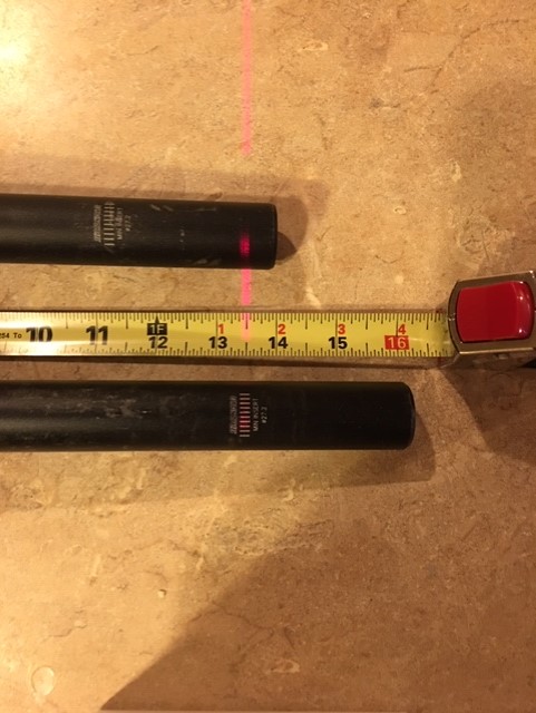

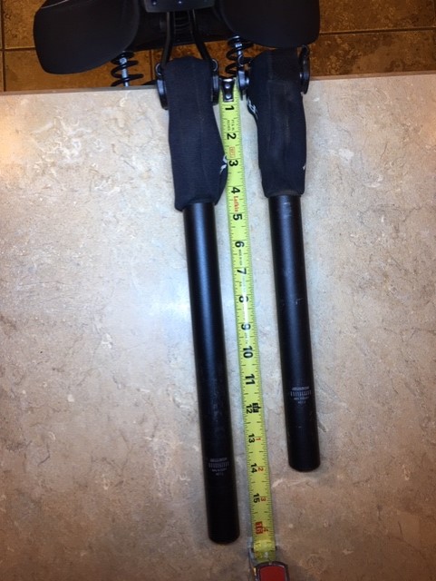

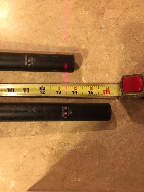

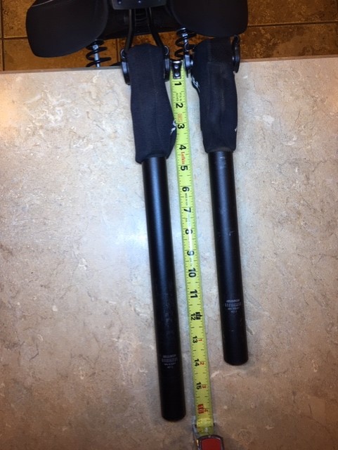

Since you have both the 350 and 400mm Suntour, can you do me a favor and measure them from the bottom to the top of the rails, and then also from the min insertion line to again the top of the rails where you will mount the seat? Thank you.
Will do this weekend
I took some rough measurements from the minimal insertion line to the where the seat attaches to the Suntour seat rails. It was a little hard to measure exactly because the seat rails are at a slight angle for the seat to be level to the ground. I "guess-i-mated" and used the center part of the seat rail near the Suntour pivot point as a mark. The red line is from my stud finder with laser leveler (my iphone was a little off center with the pic of both Suntours):
350mm Suntour from rail to min: 11.5 inches
400mm Suntour from rail to min: 13.5 inches
50mm = 1.97 inches
I didn't notice I ended up using the same picture for the 350mm and 400mm measurement from my original post. I updated the post with the 350mm pic.
50mm = 1.97 inches
