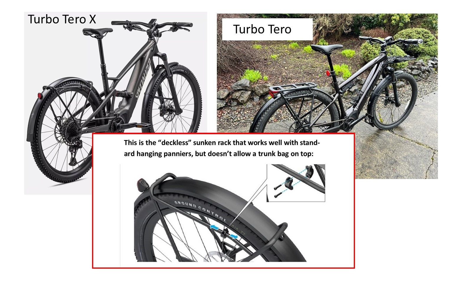

I own a Specialized Turbo Tero X 4, and I absolutely love the bike. However, the factory “fender rack” has one significant limitation: the lack of a platform makes much of my everyday travel less convenient.
While the rack works well when I use panniers, more than 80 % of my rides involve a trunk bag, which unfortunately has no stable surface to sit on. On longer trips, I typically use both panniers and a trunk bag.
Interestingly, the standard Turbo Tero (hardtail) comes with a perfectly designed fender rack that integrates both a platform and pannier rails—an ideal combination. I understand that this rack kit is available, but it fits properly only on the 29″ wheel hardtail model, not on the Turbo Tero X. (SEE PHOTO)
Has anyone created an add-on platform (similar to the hardtail version) that could bolt onto the existing Tero X fender rack?
Or, is there a US vendor that offers a compatible bolt-on solution?
Thanks in advance!
This would dramatically improve the bike’s utility for riders like me who rely on a trunk bag for most travel situations.
Thank you very much for your time and consideration.

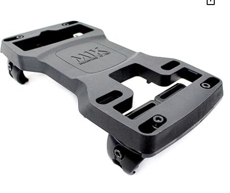

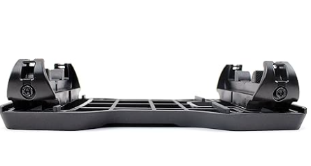

Amazon sells an adapter (Basil MIK Gepäckträgerplatte) that will turn any rear rack into an MIK compatible rack (I used one my wife's old Canondale F9 with a Topeak rack) and you might be able to mount it on the Tero X fender. You would need to add spacers since the horizontal rails are a couple inches below the top of the fender but you could maybe get it to work.
