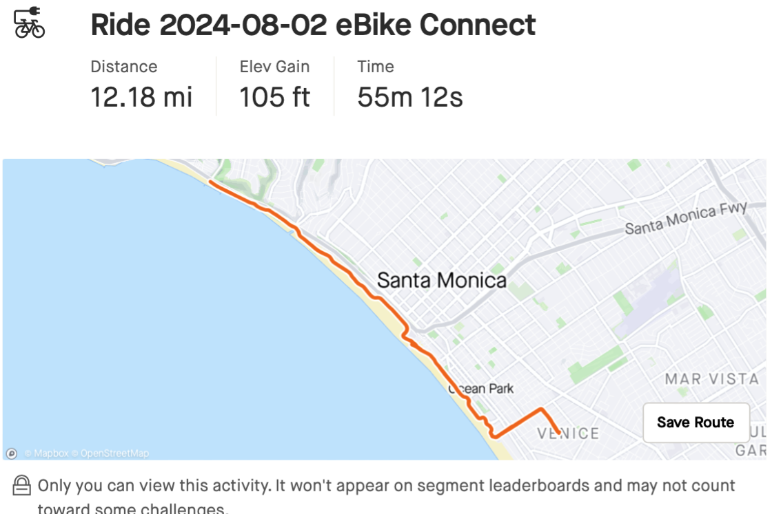

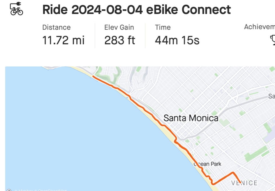

I've been doing a regular ride a few times a week for a while now. Through 8/2/24 the distance shown has been ~12.15-12.25 miles. Since August 3, the distance shown has been 11.73-11.74 miles. The only change is that my August 3 ride was an all out effort which lowered my time by several minutes - 5-10 minutes lower on average since then if I push myself hard. Same equipment, same exact route with no deviations. Most of it is on the beach boardwalk which is straight and narrow.
It's a Bosch Byon on a Riese & Muller Superdelite. I have the bike app running on my iPhone and on my Apple Watch.
Any ideas?
Does the small non boardwalk sector contains switchbacks or similar?
No it's remarkably straight, there's one area where you drive around a building (a U-shaped drive) but it's all large turns. Same for the section on the streets to get to the boardwalk - straight ride for half a mile then turn left then straight ride for half a mile. I'll try and post a screenshot of the route.

The elevation gain is off for some reason, even in the recent 11.75 miles trips, one trip will show 85 feet elevation, the other trip will show 280 feet elevation.
Interesting. The only explanation that I can think of at the moment is that, at the higher speed, there's some "corner cutting" between position recording intervals.
