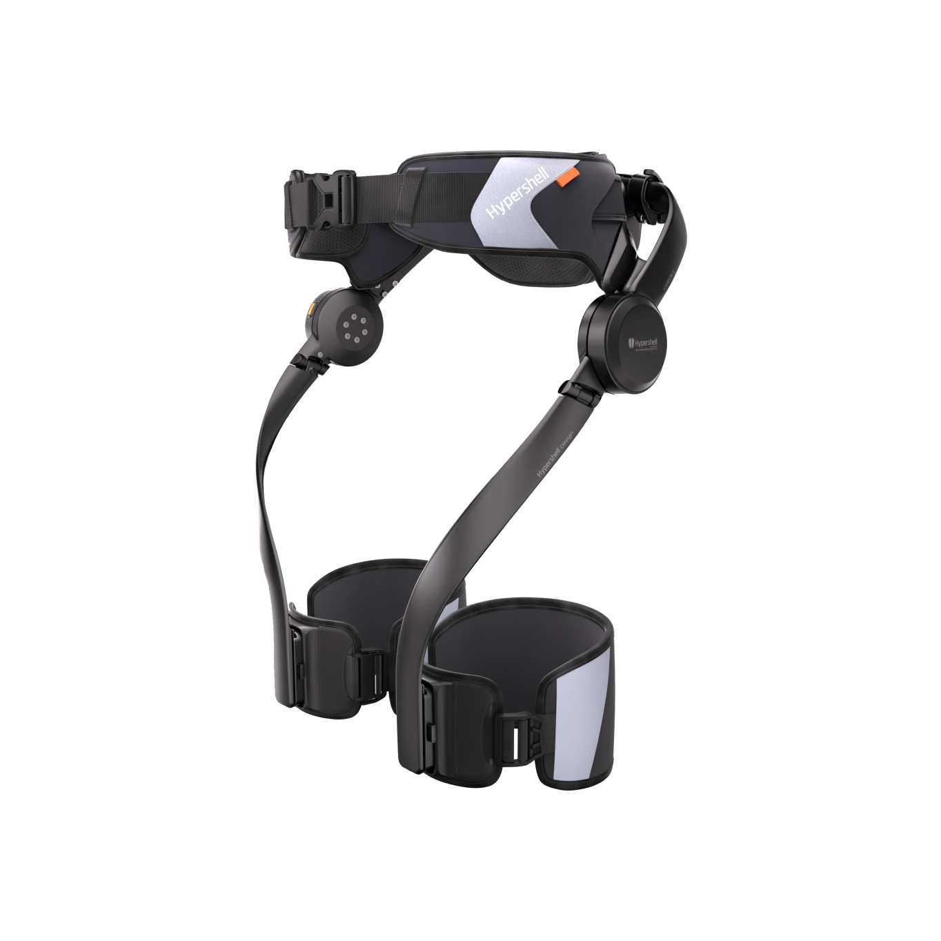

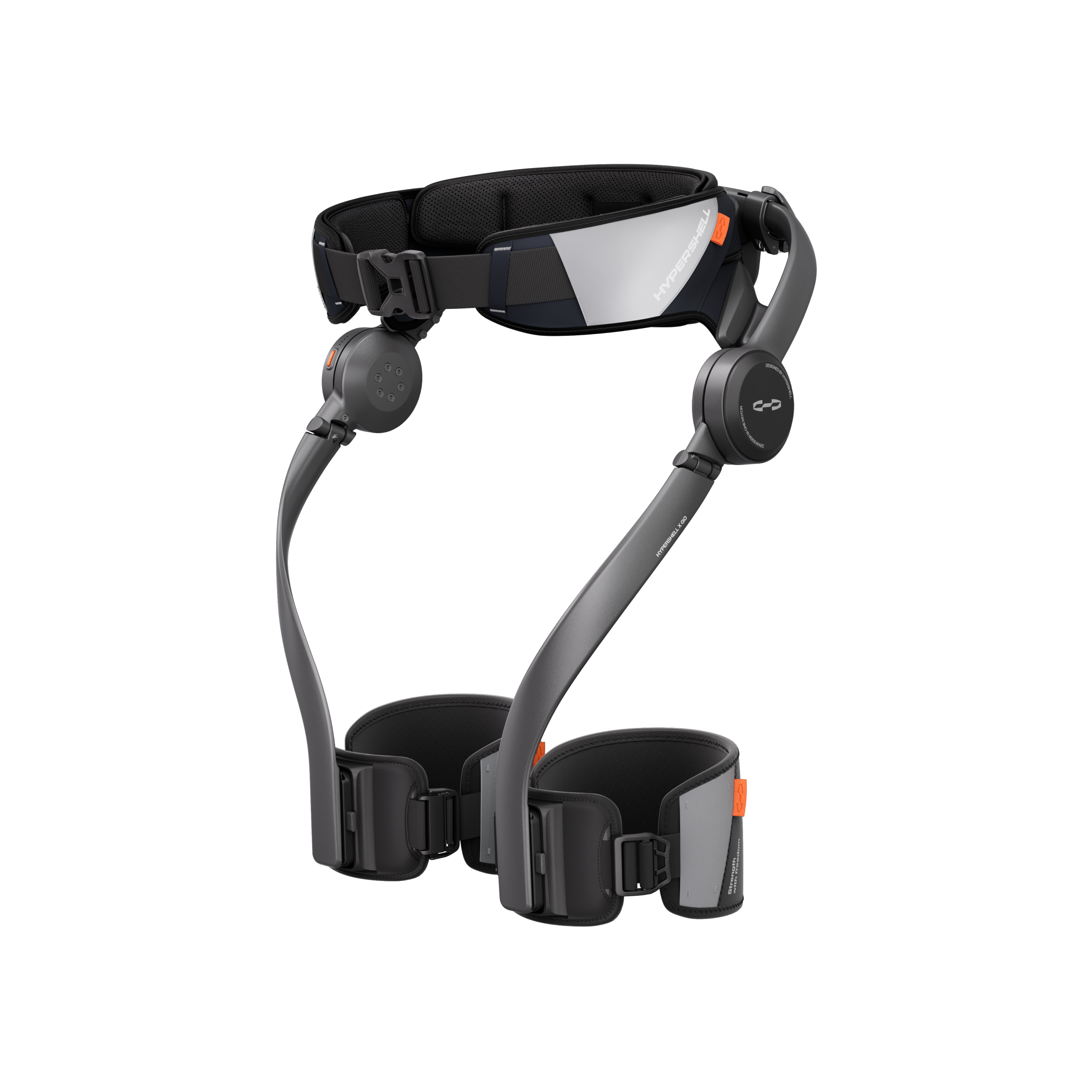

Maybe you should get an exoskeleton, then you don't have to mess with your bike at all. 2.2kg for the system, 2.6kg with a spare battery which you would almost certainly need.
I'm sorry Steve for laughing. It even beats the "airbag bike helmet"! :D

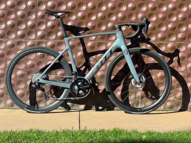

to the OPl as mentioned in one of your other threads on this, mahle now makes a complete system around the X20, the XS, which incorporates everything into just the battery and motor. total weight is 2.5kg. you are not going to get it lighter than that with readily available current technology!
also.… the addict e-ride is a very nice bike, maybe pick up a used one? it’s essentially the bike you are trying to build yourself.
notice that 1) you can’t even see the motor and 2) the chain stays are substantially reinforced relative to the regular addict. the additional dimension also integrates the electrical dropouts, so the power to the moto or is completely invisible and no wires need plugging in. this is as clean as it gets in 2025.
