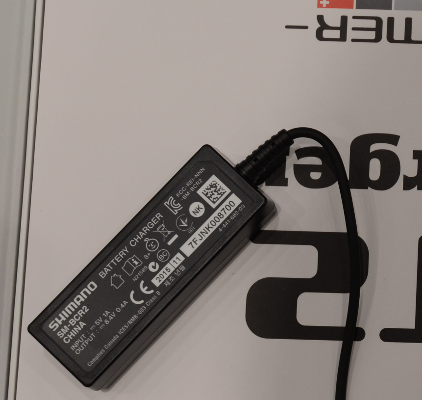

Which interface did you use? Is there an advantage of one over the other?
In order to use E-TUBE PROJECT, the SM-PCE1 or SM-BCR2 interface is required​
