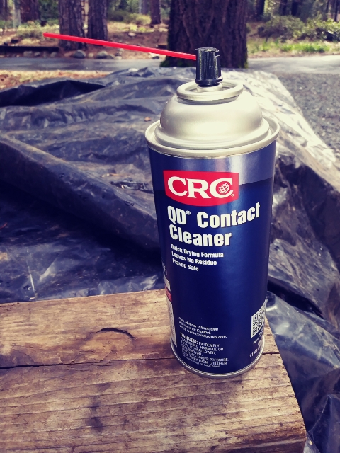

The battery acts normal as it charges, but won't communicate to the display controller when installed in the bike. Could be contaminated contacts on the battery. I use a 'plastic friendly' contact cleaner on our Vados. Others have posted good results using a dielectric paste after cleaning the contacts.
It's fairly inexpensive.
You might consider also posting to the Specialized section of this forum to get more responses from other Vado owners.

Thank you for the possible corrective action. I tried both points with no change in the problem.
I will jump over to the Vado area and see if anyone their might have experiences to lend.
I am outside warranty so I might remove the connector screws and pull the connector to check wires on the back side.
