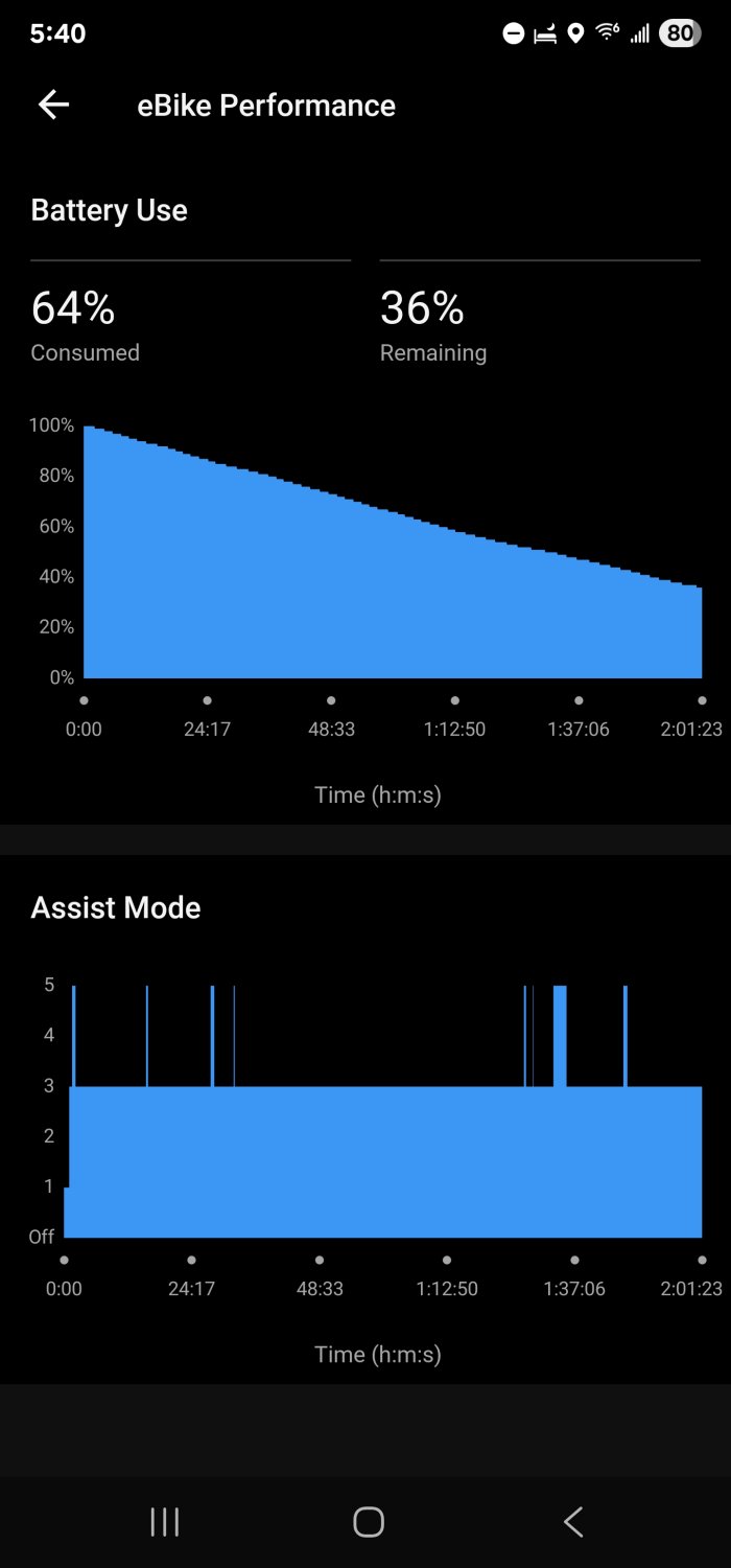

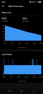

I have this for now from 2 days ago. I started at approximately 6400 ft elevation. This was a pretty flat ride though. Of course this is battery % from Garmin which is only the main (I know this now!) , but it's similar because the SL does try and drain both batteries at a similar rate.

Well... 50 km, 424 m elevation, 64% batteries used.
Effective min charge total 10% so 90% / 64% * 50 km gives 70 km.

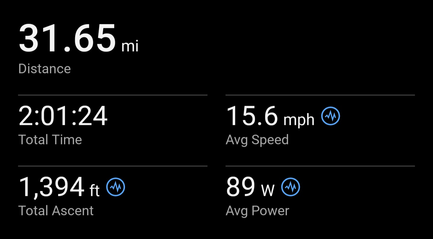

I know you're just after a rough range estimate here, but @mogulman averaged 15.6 mph on that ride. At that speed, well over half of the battery energy used went to air resistance.
Are you expecting your average speed to match his?
Also, do you think the two of you have similar gross weights and Crr and CdA values? Over 2 hrs, a 5W difference in mechanical power loss due to total resistance adds up to 10 Wh. If covered entirely by the motor at 80% efficiency, that's over 4% of the useable capacity of a 320 Wh SL 1 main battery with 10% reserved.

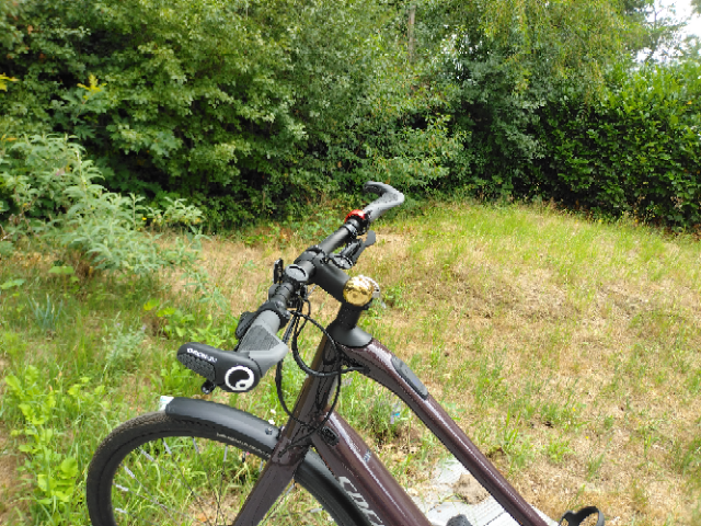

New handle bar and grips for the SL's. After a lot of km we came to conclusion that 16 degrees and Ergon grips fitted our needs better for our fit. Happy with this fit.

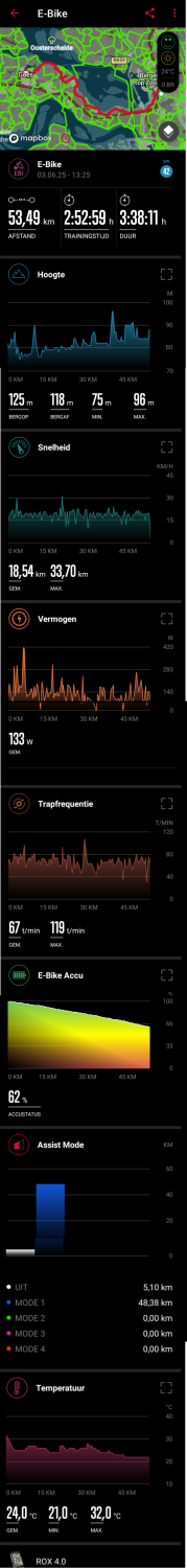

Seeing your TCU in the photo made me wonder how a guy with your experience puts it to use? How many pages, and what data fields are you showing? Actually a question for all.
My usual 2 pages (assist mode, speed, clock, percent battery / assist mode, rider power, cadence) recently expanded to 4 when I learned that the TCU can show estimated range, range trend, and gradient.
Don't like scrolling through 4 pages, so will likely return to just 2 eventually. The gradients were useless in my hilly terrain, so switched that 3rd page to motor power and motor/rider power ratio just out of curiosity. Doubt this and the 4th range page will earn their keep on the TCU but will play around with them a little longer.
Love how easy it is to reconfigure the TCU with the app.

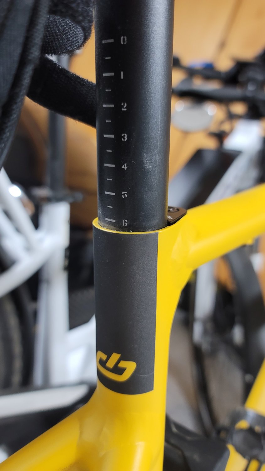

After 10 months, 178 rides, and 2,346 mi — including a good bit of bumpy offroad — my SL 1's seatpost hasn't budged a millimeter! Small thing, I know, but I've NEVER had a seatpost that didn't sink over time. (Also never had a bike of this quality, so maybe not be so exceptional to some of you.)
Seatpost 1 month after New Bike Day. Rode the brand new SL out of the shop with the seatpost at 6.3 cm, and it looks exactly the same 10 months later. Never adjusted after initial fitting.
