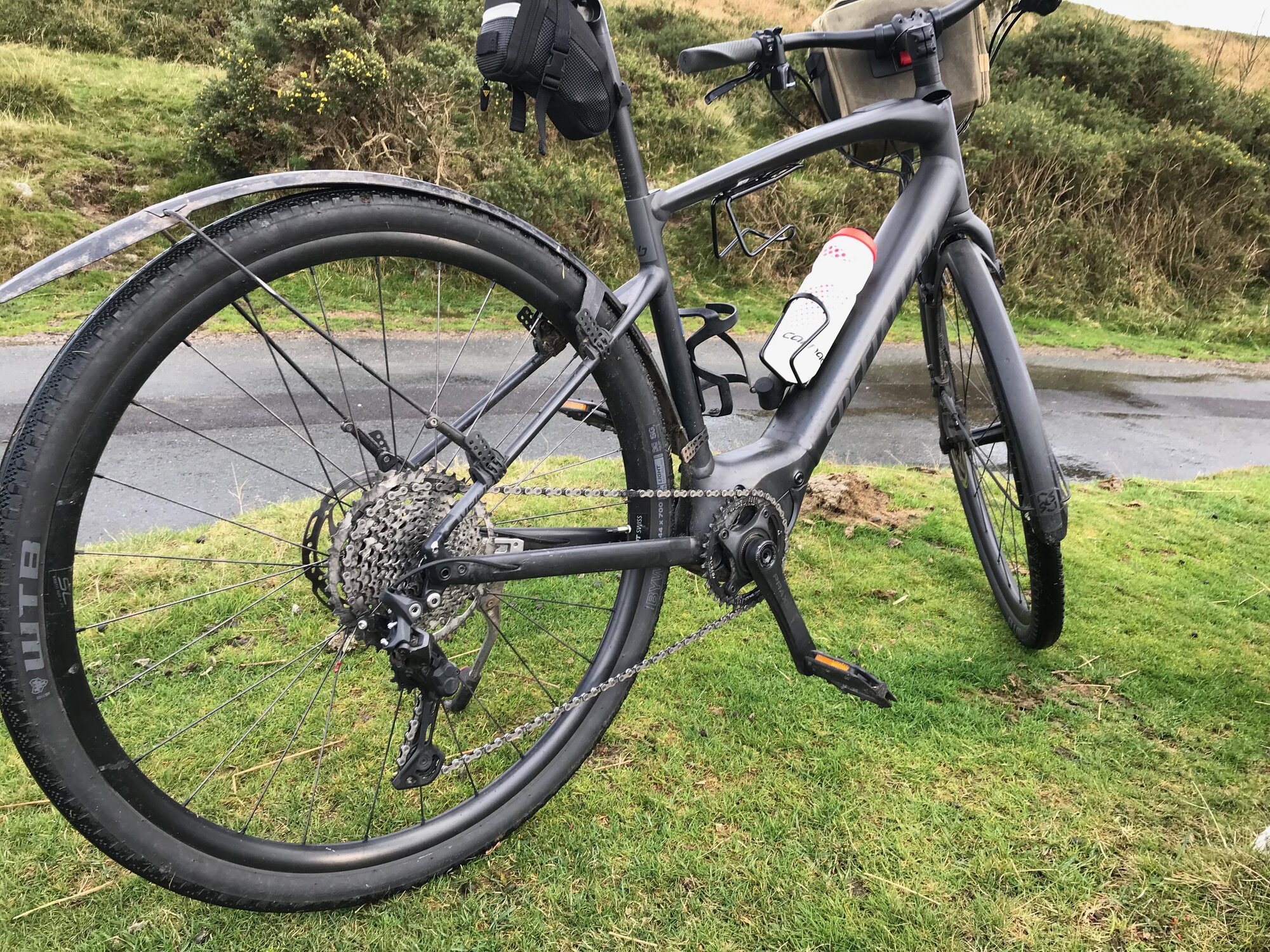

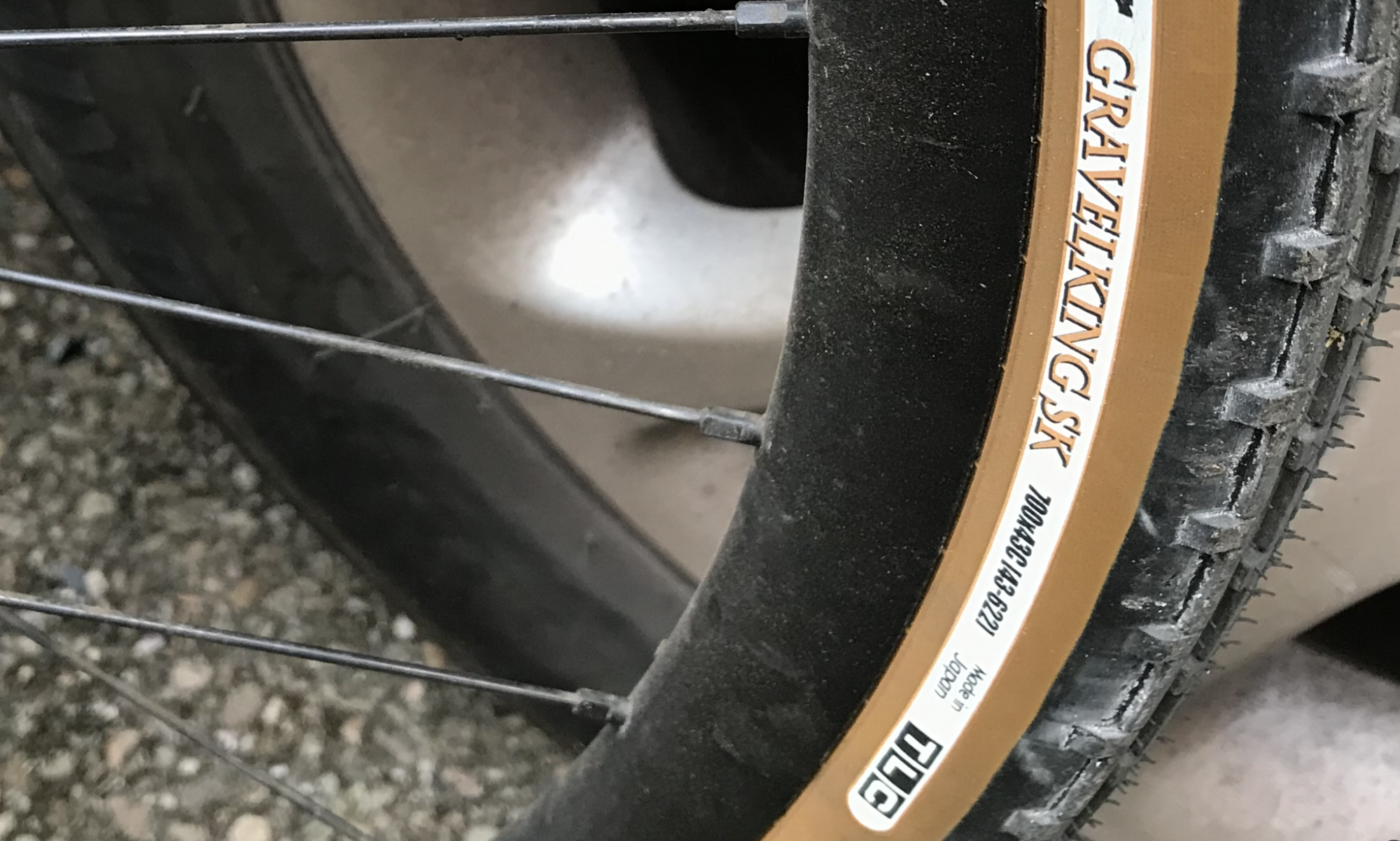

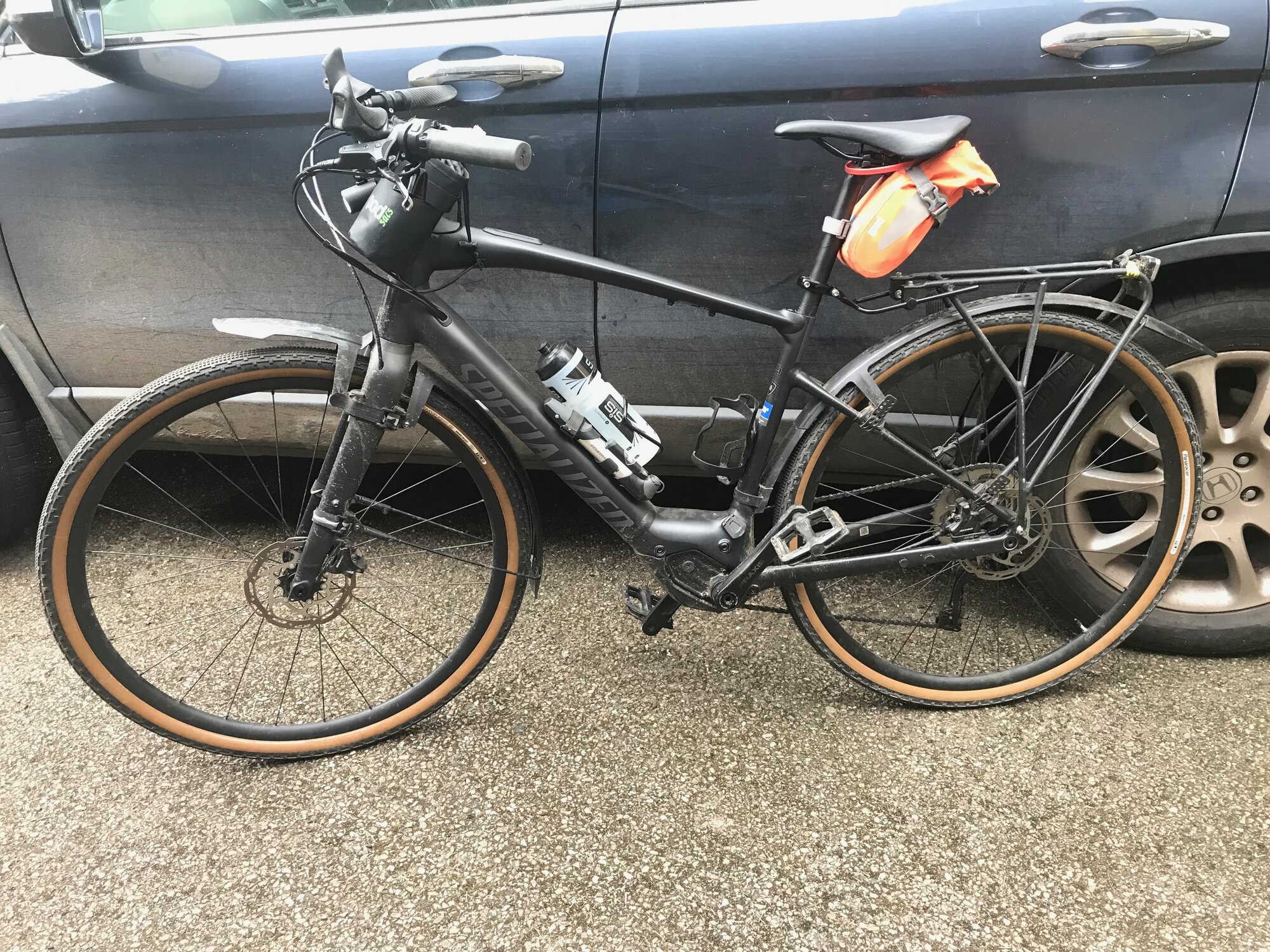

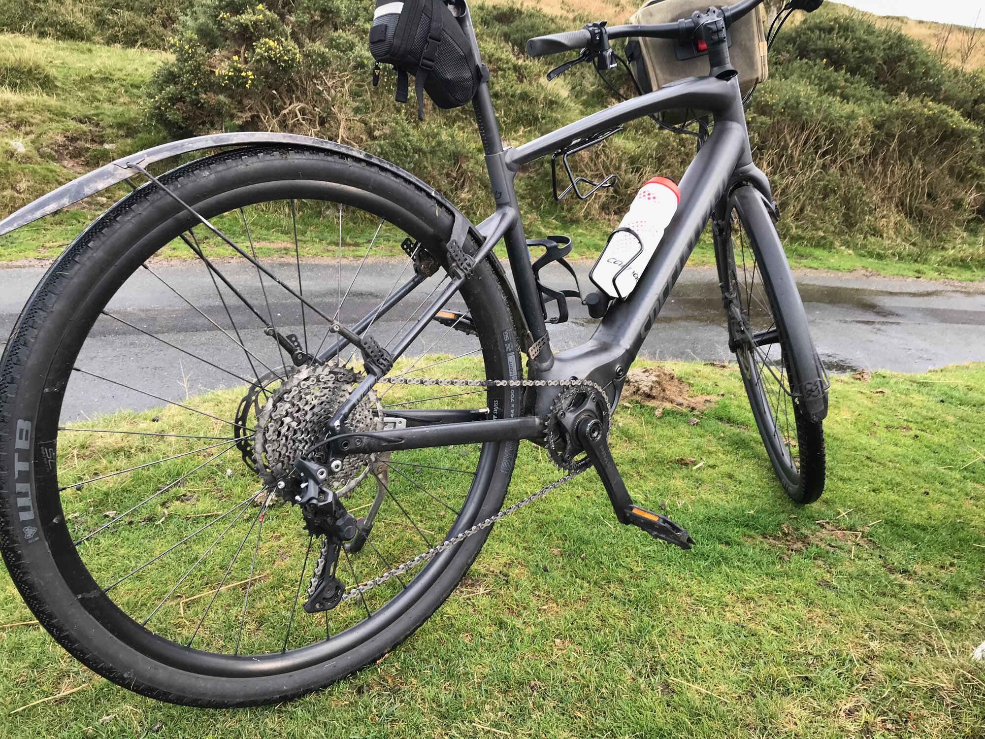

For me, there is nothing better than SKS Speedrockers but there are two important points:
  • The rear mudguard will only fit the 38 mm tyre on Vado SL. With a 42 mm tyre there is no clearance to install the mudguard! (The front fits OK).
er... cough, cough ....
or...
View attachment 186948View attachment 186950
or...
View attachment 186951View attachment 186952

Ras, as my brother explained to me, the tyre profile can be very different depending on the exact tyre model, inflation pressure (and the rim inner width, irrelevant here). He installed a 45 mm Schwalbe G-One 365 on his gravel bike, measured the width, and it was 42 mm.
The only thing I can confirm is: A Specialized Tracer Pro 42-622 tyre under 2.6 - 3.0 bar is too big to accommodate the rear Speedrocker. The tyre just rubs the mudguard. (The Tracer profile is high).

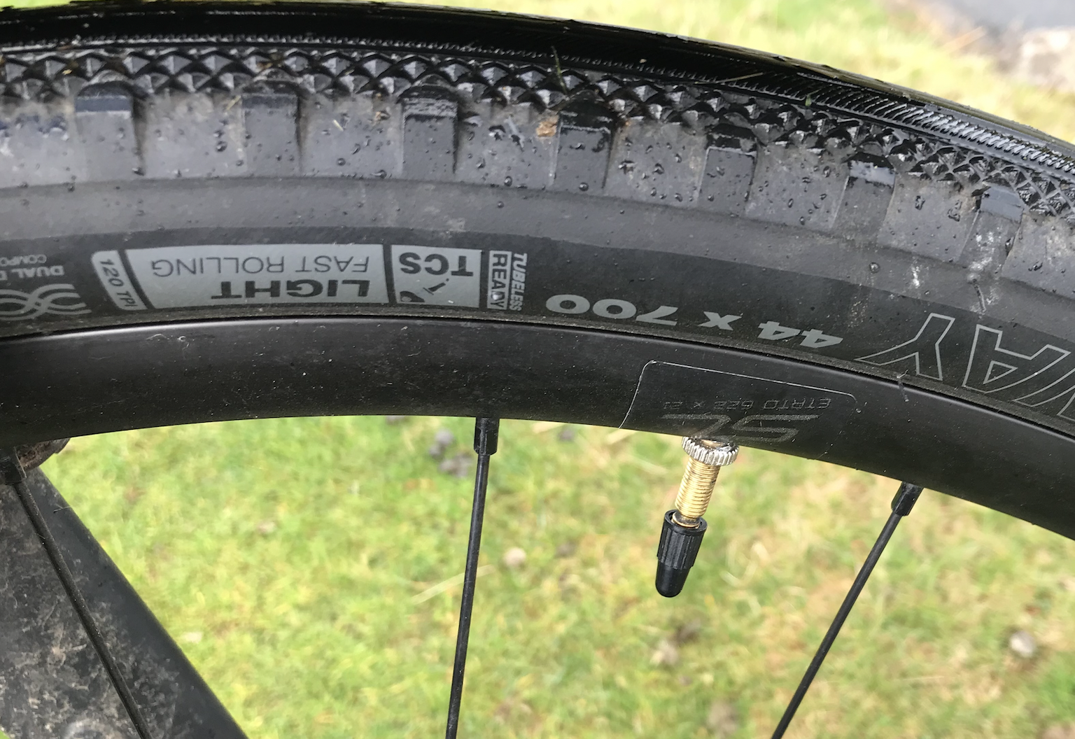

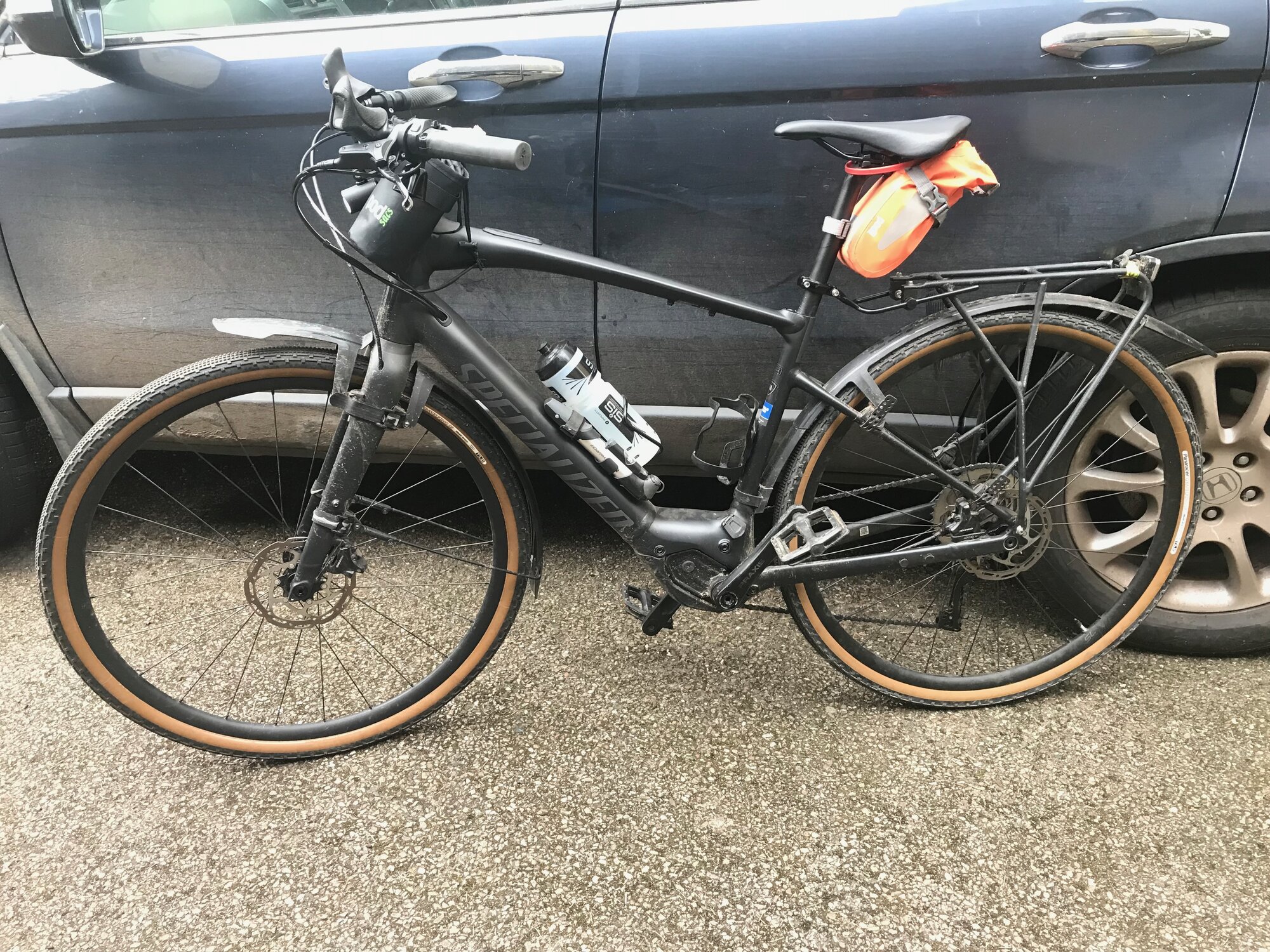

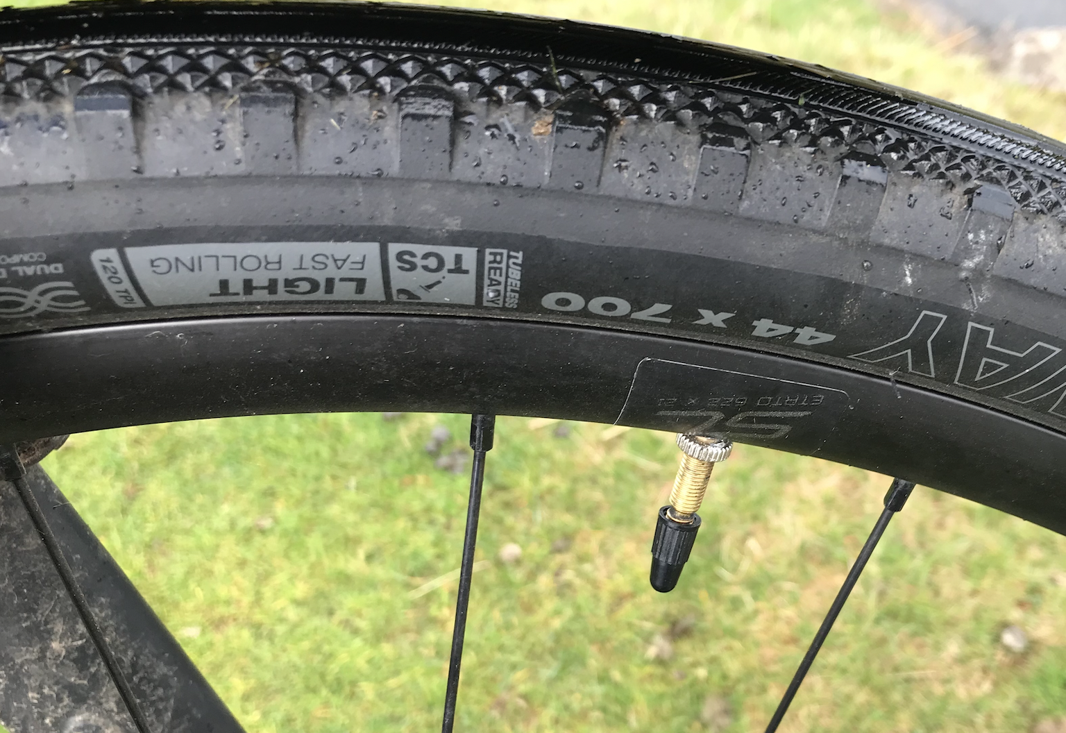

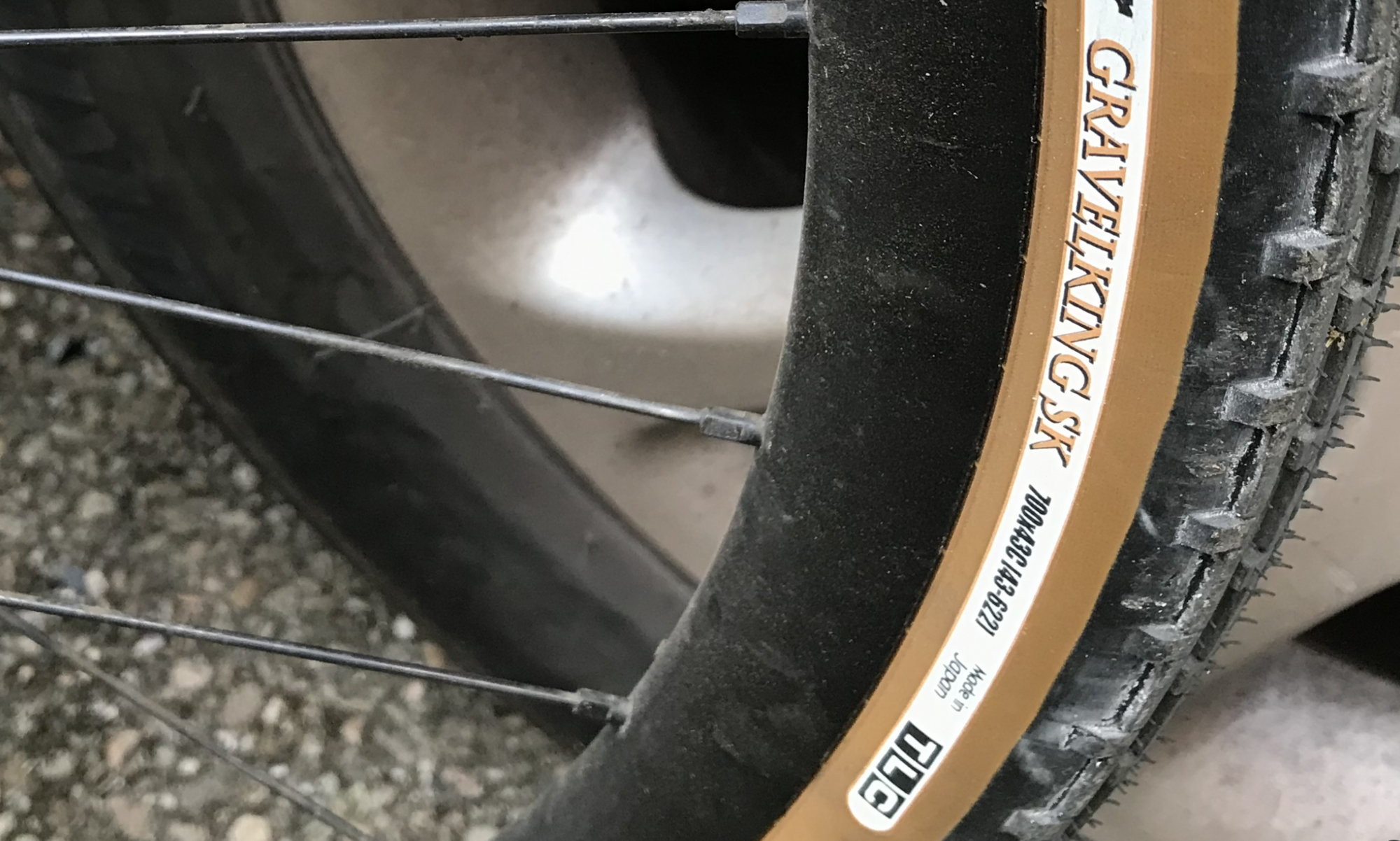

Exactly - I've had the Speed Rockers about 7 years and for the last 4 they've been on the Vado SL & I've had a number of different tyres. On paper the Byways are the widest at 44 and fit no problem (at any pressure) and the Gravel King SKs although 43 are actually wider because of the knobs. No problem with those either, though up at the seat stays its pretty close, but in use seemed fine. To say anything over 38 just won't fit is incorrect. Most up to 42 seem to fit fine. Perhaps it's just the Tracer Pros - Did you ever have a pair of 42s Pathfinder Pros? Curious if they fit.
Marts you should be ok with 40s, though I've not tried the Terra Speeds, they look good!

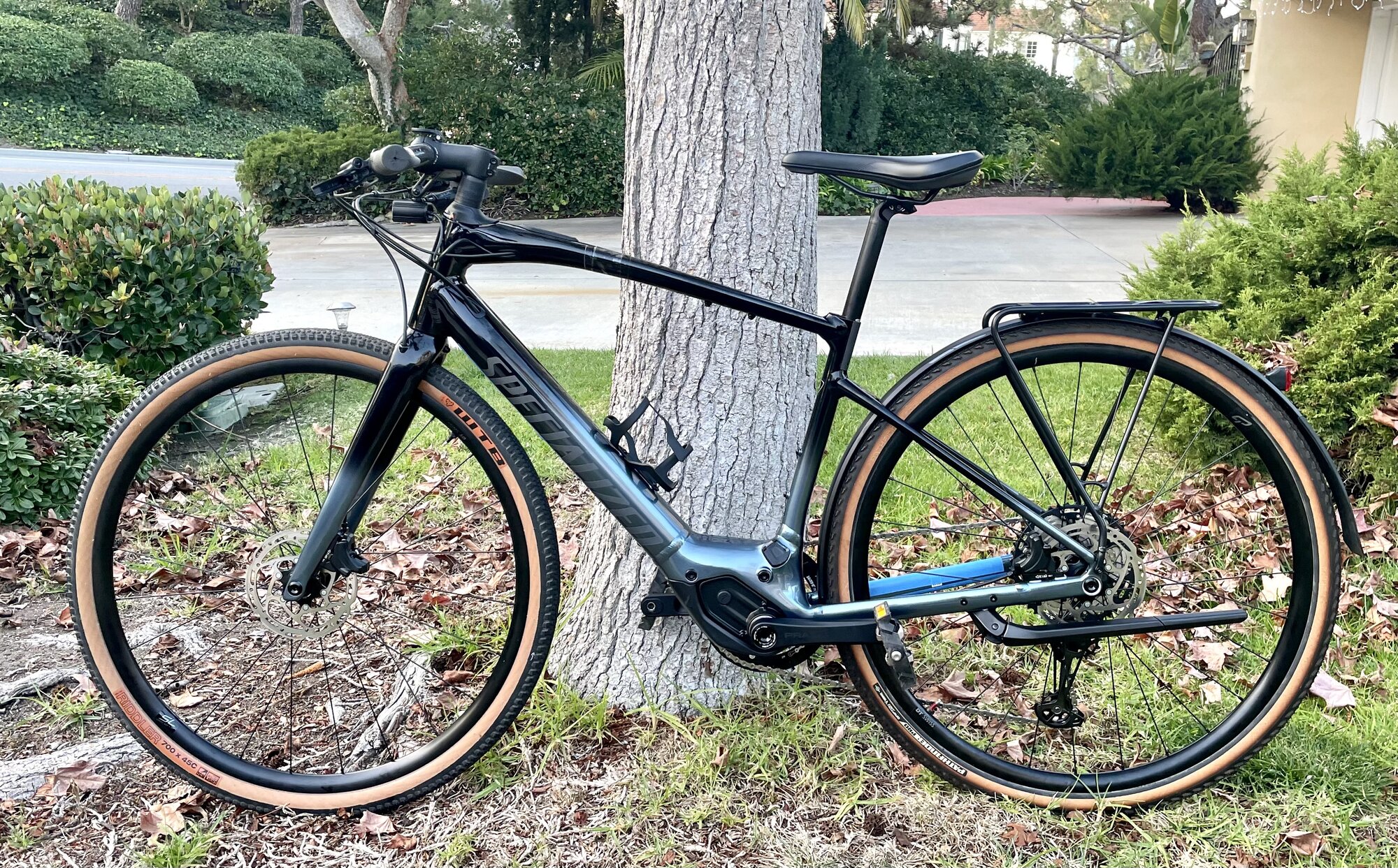

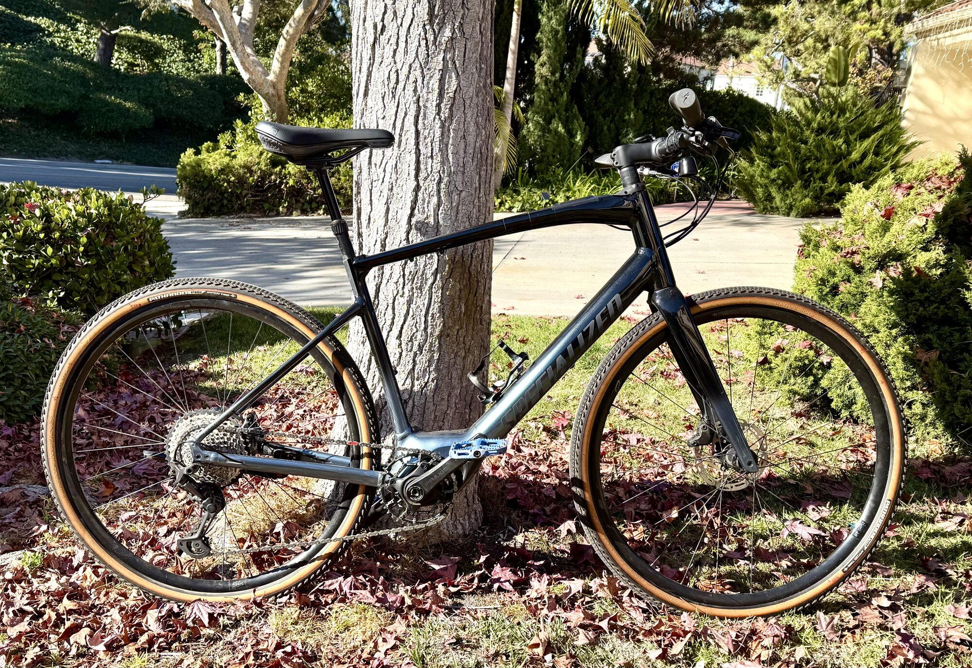

and in 2024 in Southern California mode (no mudguards needed!)
A real beauty! How did you solve the tail light dilemma?
It's for sale if you're interested 😉
If only it was that simple! ;)
2021 Vado SL 4.0 EQ, 2024 gravel racing edition :)
