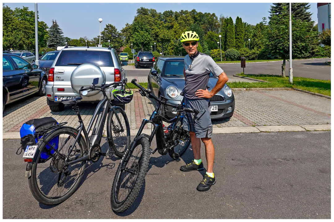

Our proven mountain road bikes :) Vado & Trance E+
