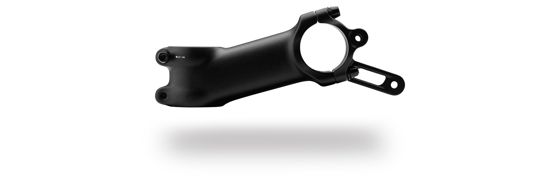

Now I can understand that my Vado is equipped with a very specialized Stealth stem, which only belongs to the Euro Vado 6.0. I could see (in a website picture of Vado 5.0) the TCD-W display support does not belong to the Flowset stem, which is good. I can, however, notice that the headlight is mounted near to the stem. Does the lamp support belong to the display support there?

Here is the Specialized Stealth stem with the integrated display support (the Supernova headlamp is mounted separately on the handlebar):

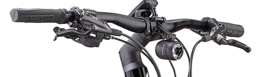

Here is the Specialized Flowset stem arrangement for Vado 5.0, as seen in the website:
The question actually was if the Vado 5.0 Flowset stem could be easily replaced with any other to not affect the display and the lamp.

Ah, good question. Indeed it can! I used leftover Pinarello top cap parts to run a regular stem on mine. Specialized has the correct part too, I just didn't have the patience to wait for it. Here you can see a standard top cap and spacer setup enabling one to use a traditional stem.
You'll also need a mount to put the light on the fork between the fender and the fork crown. Looks like Specialized sells the light with mount, don't see a mount itself. Here's the p/n for the light with mount S195800001

On our Vado 5s the headlamp is mounted to a special stem clamp as shown on the Specialized US web pages.

The Supernova headlamp itself is also custom in that the electrical cable enters on ths oppsite side of the mounting bracket so water won't enter the housing when installed on this bracket. The lens is also 'up side down' to keep the beam below eye level.
The TCD-W is supported by its own separate bracket clamped to the handlebar. Mine is located next to the stem clamp positioning the display over the stem. So, the lamp and display supports are separate on my Vados.

The dispaly is no problem being on a separate handlebar mounted bracket.
The lamp, however, is a different issue. Lamps that are fork crown mounted don't pose a problem. Lamps mounted to the Specialized stem do in that the electrical cable enters from the side opposite the mounting tab. Moving the lamp from the stem almost always requires the lamp to be rotated 180° as in @Brendon@TBSM example. This puts the cable on the top of the lamp potentially allowing water entry.
My solution to this was to move by stem mounted lamp to a 3D printed extension that moved the lamp up.
This same bracket can be rotated down to lower, rather than raise, the lamp.

2020 Vado's that I've had in the shop all have a fork mounted light. That stem mount is leftover from the Blox display as I understand.
