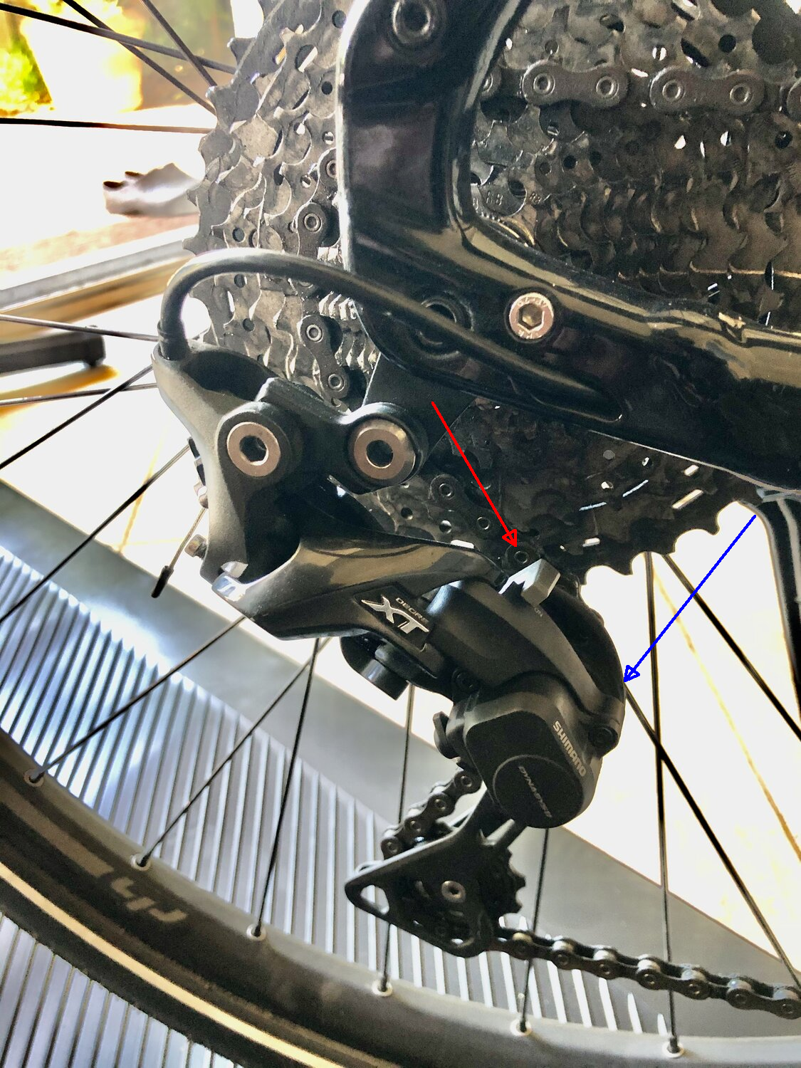

@Kam1936 and @Nxkharra please engage the grey clutch (move from the red to the blue position) if you want to have better rides. The Shadow clutch prevents the chain against bouncing. Disengage for the wheel replacement.
@Stefan Mikes thanks. I just checked mine. The blue position (shown in your picture) in my case is the disengaged position. It is to be used for taking the wheel off only as it releases the derailleur for more giving. At the blue position the chain rattles and hits the chain stay tube.
I was always instructed to keep it engaged which is the red position in your picture.
Please let’s clarify.
is yours different or am I confused?

Not certain but to my experience when clutch is disengaged gear Chang is smoother.
but chain rattles if the road is bumpy. So to be sure I always ride with clutch engaged.
My experience too. Changing gears is smoother when the clutch is disengaged, i.e. in the front position (blue arrow in @Stefan Mikes picture). I leave it in that position most of the time. Riding on rough/bumpy terrain it's best to engage/close the clutch. But not all the time.
