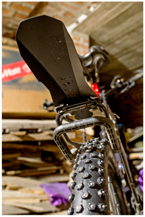

If Anyone Considered What The Maximum Vado Tyre Size Was...
...it is 28x2.0" (50-622 or 51-622). I was very afraid Schwalbe Marathon Winter Plus studded tyres wouldn't fit my Vado. Oh, these fit perfectly. Even leave more clearance to the fender than Electrak 2.0 Armadillo :)
I had the first ride on snow and ice this morning. The tyre pressure was 3 bar (58 psi), and that was 60% of the maximum allowance for these tyres. While my Electraks produced a zig-zag on the first ride attempt, Marathons Winter held perfectly, was it deep snow or icy asphalt. The ambient temperature was "-0.1 C" or "black-ice conditions". I'm so happy with the purchase, even if the price of studded tyres is twice of the regular ones. Low inflation pressure (which is still by half bar higher than the minimum) ensured very smooth ride. Funny thing: These tyres are not noisy at all!
Note: Vado 6.0 (with suspension fork) accepts the same tyre size, so it would be good for any "full" Vado.

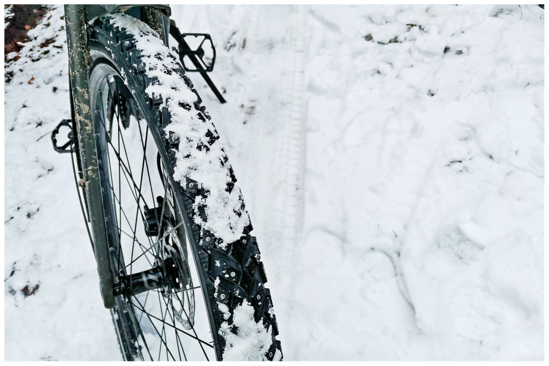

Just for you Stefan, we've got well over 12" here, finally got to try out winter mode! 27.5 wheels with Schwalbe Ice Spiker Pro's 27.5x2.6, 18psi in the back, 15psi in the front. Too fun!!

Here's some pics, if you want some shots in particular happy to take more!

It is quite interesting these tyres behave flawlessly on ice but can slip on fresh or loose snow... No grip at all!
I think that's more attributed to tire width rather than tread pattern. Wider tires displace more weight and aren't as likely to be pushed around in snowy ruts. I think from a commuting perspective the 27.5x2.6 Ice Spiker Pro is the best of all worlds. If you want to trail ride a wider, fat bike makes a huge difference.
