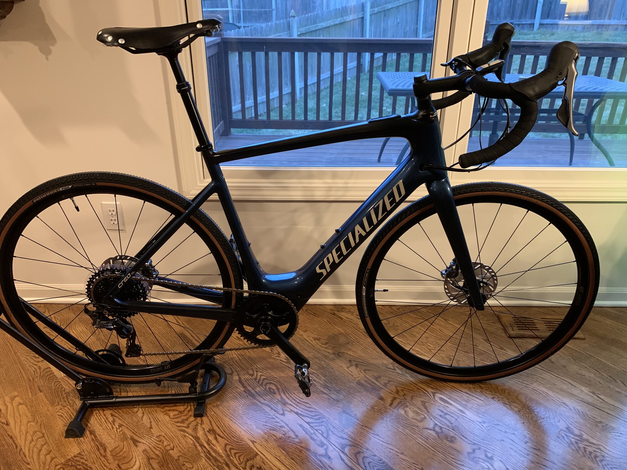

I officially became a member of the N + 1 club this weekend. I took delivery of a Creo Comp Carbon EVO in XL. I was able to test ride both the carbon and aluminum frame options and decided that the carbon was too sweet (and comfortable) to pass up. The LBS is part of a Midwest USA chain and had one in the box at their warehouse. It was built up by the LBS and the remote buttons and TCD were added. The LBS mechanic and I worked together to find my best spot for the buttons which was on the inside face of the drop bars just below the brake hoods. We looked at a few options based on input from another thread here. My thumbs are long enough to reach them when I'm riding up top. We moved the seat dropper lever up top to make room for the left button. I also switched out the saddle to a Selle Anotomica X2 with carbon rails. With that saddle and pedals, it weighs in at 32.4 lbs. Unfortunately because of the weather which has been cold and wet, I have not had a chance to ride it yet. Based on forecasts, I think it will be later this week before it is warm and dry enough. Come on dry weather. Oh well, at least our KC Chiefs are going to the Super Bowl...again!
I officially became a member of the N + 1 club this weekend. I took delivery of a Creo Comp Carbon EVO in XL. I was able to test ride both the carbon and aluminum frame options and decided that the carbon was too sweet (and comfortable) to pass up. The LBS is part of a Midwest USA chain and had one in the box at their warehouse. It was built up by the LBS and the remote buttons and TCD were added. The LBS mechanic and I worked together to find my best spot for the buttons which was on the inside face of the drop bars just below the brake hoods. We looked at a few options based on input from another thread here. My thumbs are long enough to reach them when I'm riding up top. We moved the seat dropper lever up top to make room for the left button. I also switched out the saddle to a Selle Anotomica X2 with carbon rails. With that saddle and pedals, it weighs in at 32.4 lbs. Unfortunately because of the weather which has been cold and wet, I have not had a chance to ride it yet. Based on forecasts, I think it will be later this week before it is warm and dry enough. Come on dry weather. Oh well, at least our KC Chiefs are going to the Super Bowl...again!View attachment 77547

Congrats JeffC,
That is one gorgeous bike!
I too am a firm believer in the n+1 rule. Too bad hubby is not. But he’s flexible.

Many great miles on your new Creo.
Beautiful Bike... you may want to get an indoor bike trainer to ride your bike all winter!

Gorgeous bike. You will not regret this investment. Should the TCD not be enough data, the Garmin connection (830, 1030) will allow you so many possibilities including top of hood quick choices. The Ebike app via Garmin (Jan Carpek) is pretty close to perfect in terms of battery life data on the long rides. I find the Range Extender to be an expensive luxury worth your resources. Especially on plus 50 mile excursions. Living in the midwest poses questions as to whether the 11-42 is the most astute cassette choice. My recent update of a 11-34 which makes so much more sense in rolling hill country with 12" inches of snow today in Nebraska, my hope is you can get out and pedal sooner than later!
Thanks for your thoughts. I have a range extender on order which will also be used on my Vado SL 5. No word yet on delivery. I will keep the gearing and TCD update options in mind after I get some miles on this bike. Stay warm, safe and healthy.
Great looking bike Jeff ( I would say that as I have the same model in the same colour, albeit in a different size) I have done 700 miles on mine since getting it in October, riding around The Peak District in England with plenty of 12/15% gradients and it has been excellent, One of the first things I did was remove the Dropper seatpost I found I never used it and the very slight play in it annoyed me. Apart from that it really is the most enjoyable bike I have ridden since my teenage years.
Yes we do have excellent taste don't we ;) The only thing I don't like about the paint job is what was done on the top face of the top tube. Glossy black at the ends and fade out to just the black carbon. The painter kind of missed & didn't do it smoothly in a spot. They should have just painted the entire face glossy black. Probably nobody will notice it but me. Yes, I'm not sure about that dropper seat post either. In the court of internet opinion, it seems to be mostly thumbs down. If I decide it needs to go it will be easy to rip out, especially where we put the dropper lever. Also, there are two slotted "holes" in the seat tube, just below the seat clamp. Holes in quotes because they are not countersunk with threading and don't go all the way through the tube. I'm not sure what they are for. I did notice that some flavors of the Creos have a taller seat clamp than mine which appear to cover them up. At first I thought my frame was flawed then talked myself off the cliff after looking at pictures on the Specialized site of other flavors of Creos with lighter paint colors. You can also see them on the green CC Evo that Court rode for his review. Anybody know why they are there? Can't wait to ride it. Light dusting of snow this morning with below freezing temps most of the day so I think not. Thanks for your kind thoughts. Stay safe and healthy.
And the dropper post is very heavy compared to a normal seat post...
I only felt the need for it in two tours with MTBs, were it was so steep, that I walked. But I missed more than a dropper post: Better brakes/bigger discs, supension fork, much wider tires. Then I really would appreciate also a dropper post...
Jeff how tall are you? I'm always suprised about the length of the seat posts when I see Creo photos here and often thought "In the U.S. they choose their bikes very very small...". My seat post looks much much lower in real life. But now I saw a photo a took from my bike and seat post looks almost as long as yours. Seems photos or the position of the photographer cause a lot of perspective distortion here...
