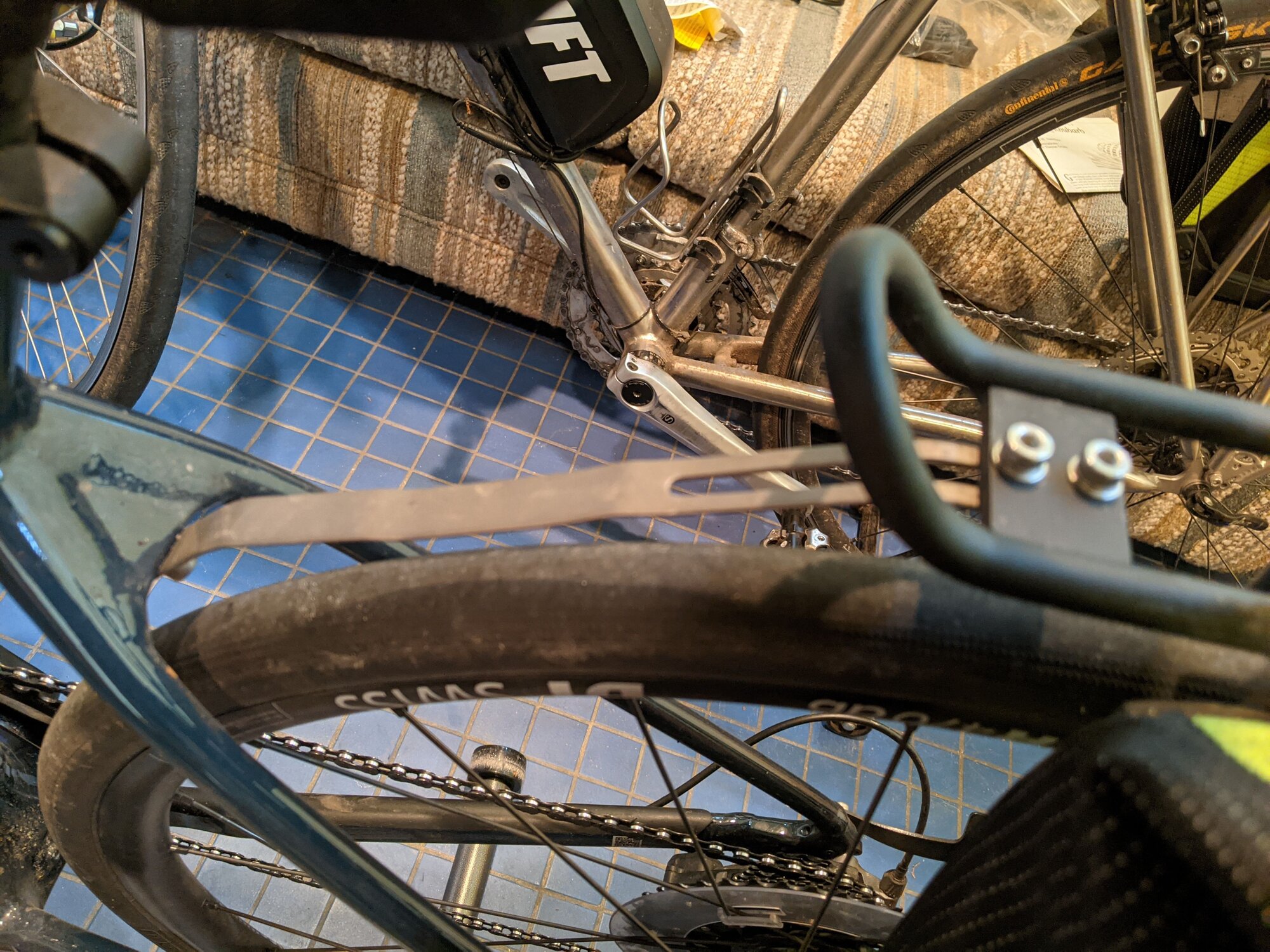

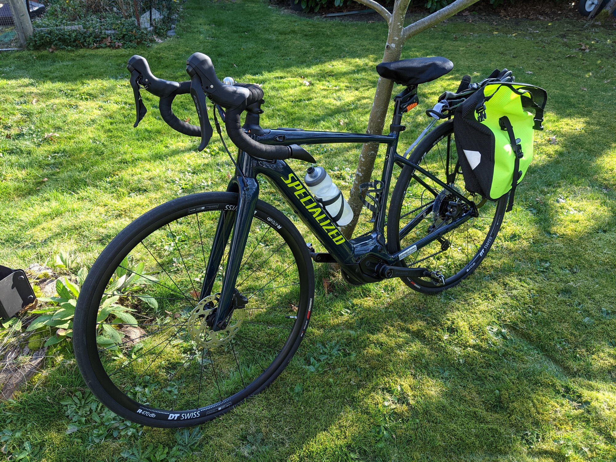

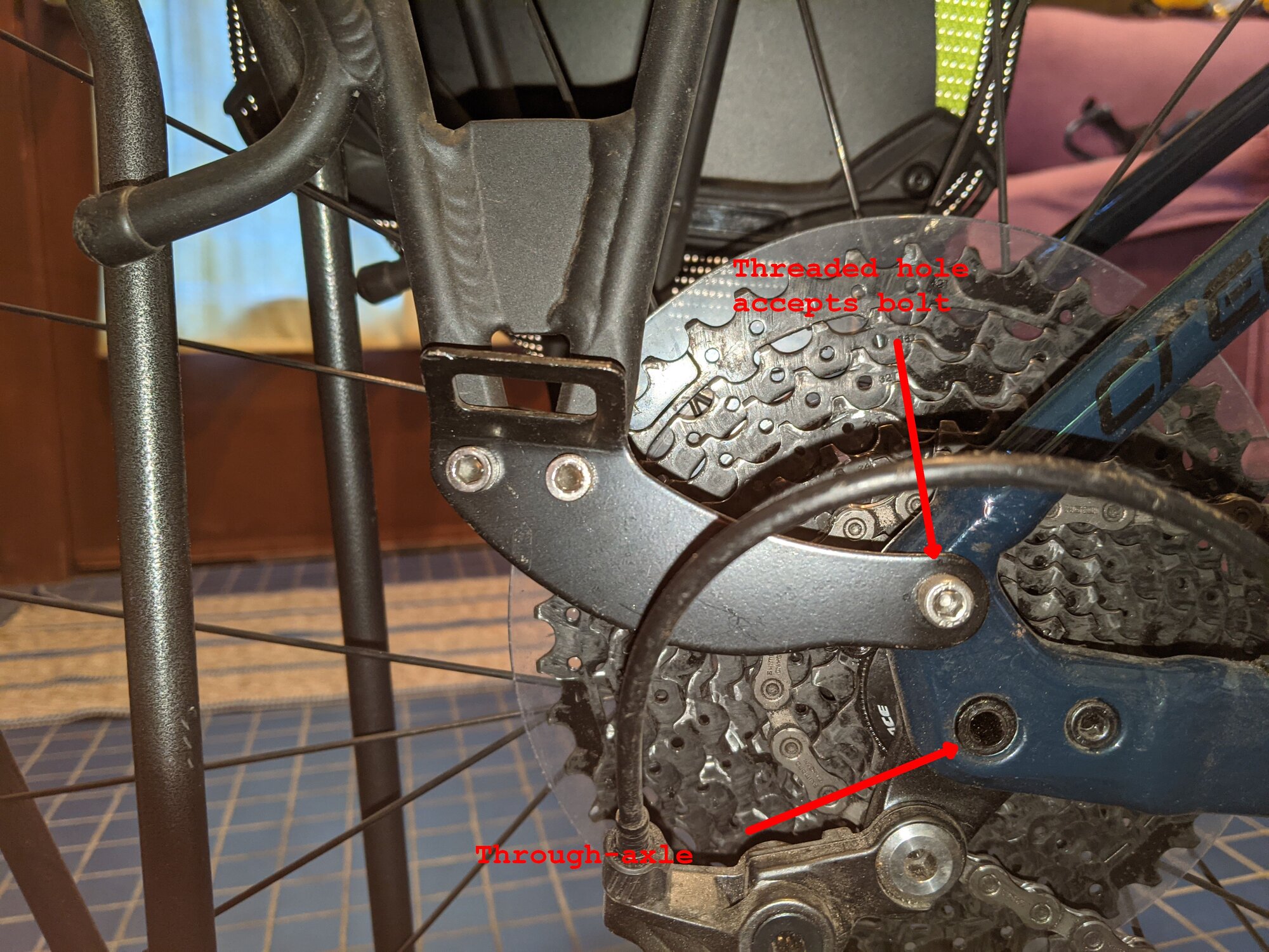

I have the Aluminum Creo and have an Axiom rack. The reason I went with this one was that some of the other racks would have interfered with the through-axle mechanism - meaning the rack would need to be removed to deal with a flat tire. I guess changing out the Specialized "faux quick release" handle through axle would work.
