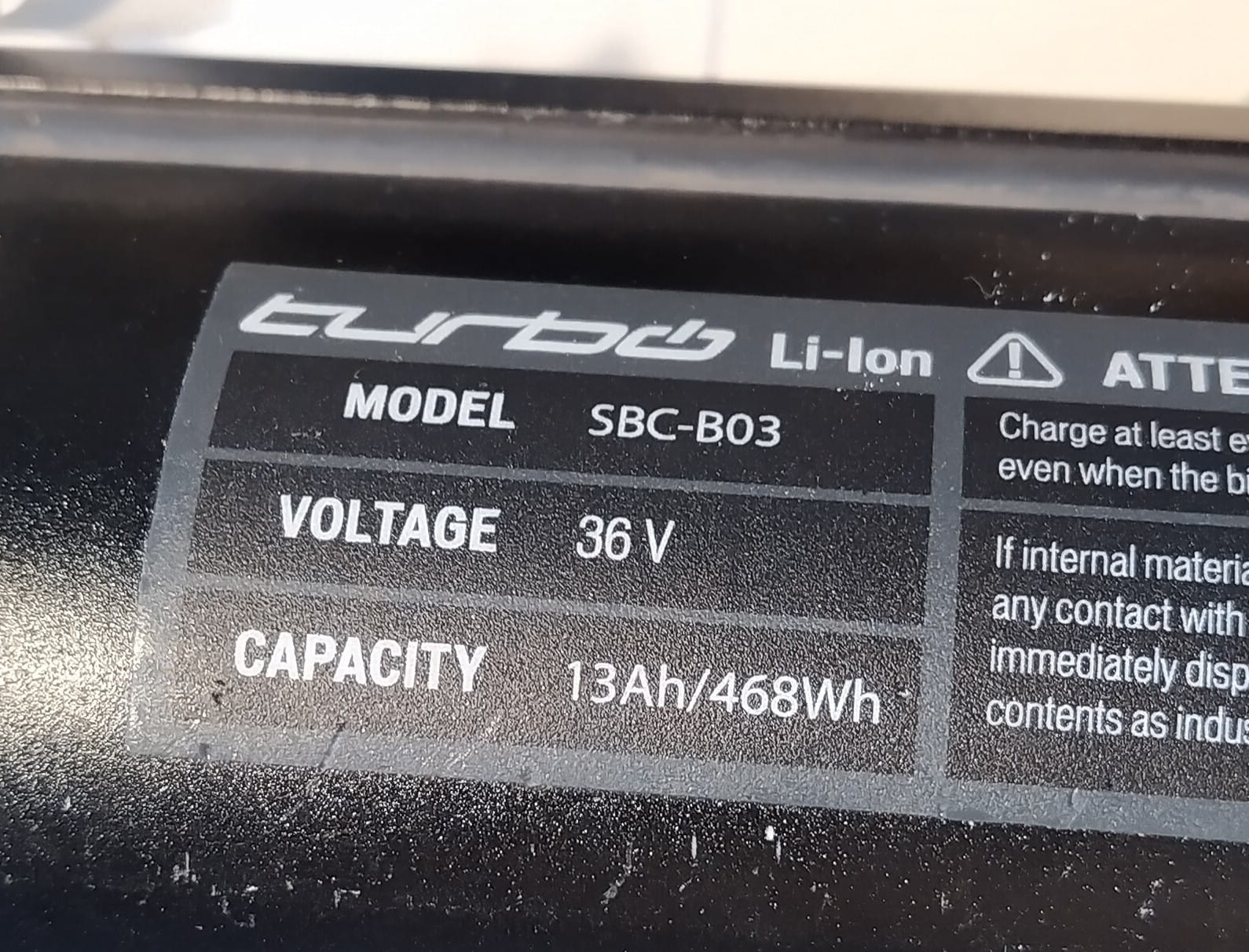

i bought a 2nd-hand turbo-x from 2015, battery has a problem. seems to be d motherboard (of BMS) if i understand it correctly. or is there another board in there? now d specialised-importer here in spain says only option is a new battery - price 1200$ !!!!!!
suffice to say i find this outrageous, for various reasons. so not an option for me. REPAIR is d answer, battery is still good.
question: where could i find another board, used or new, so i can exchange it for d broken one? or who knows how to repair it, probably it's a '50-cents-component' that needs replacing. but, needs to be identified; not my expertise, unfortunately :rolleyes:

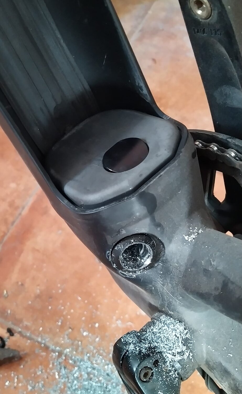

finally i gave up looking for d key and destroyed d lock; anybody knows how to lift this bottom-lid in order to install a new lock?

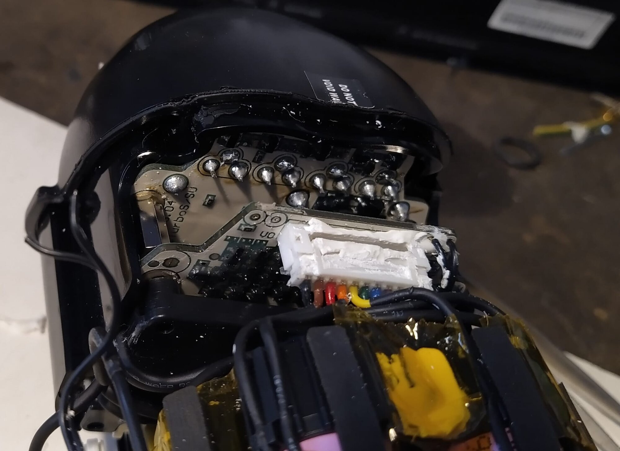

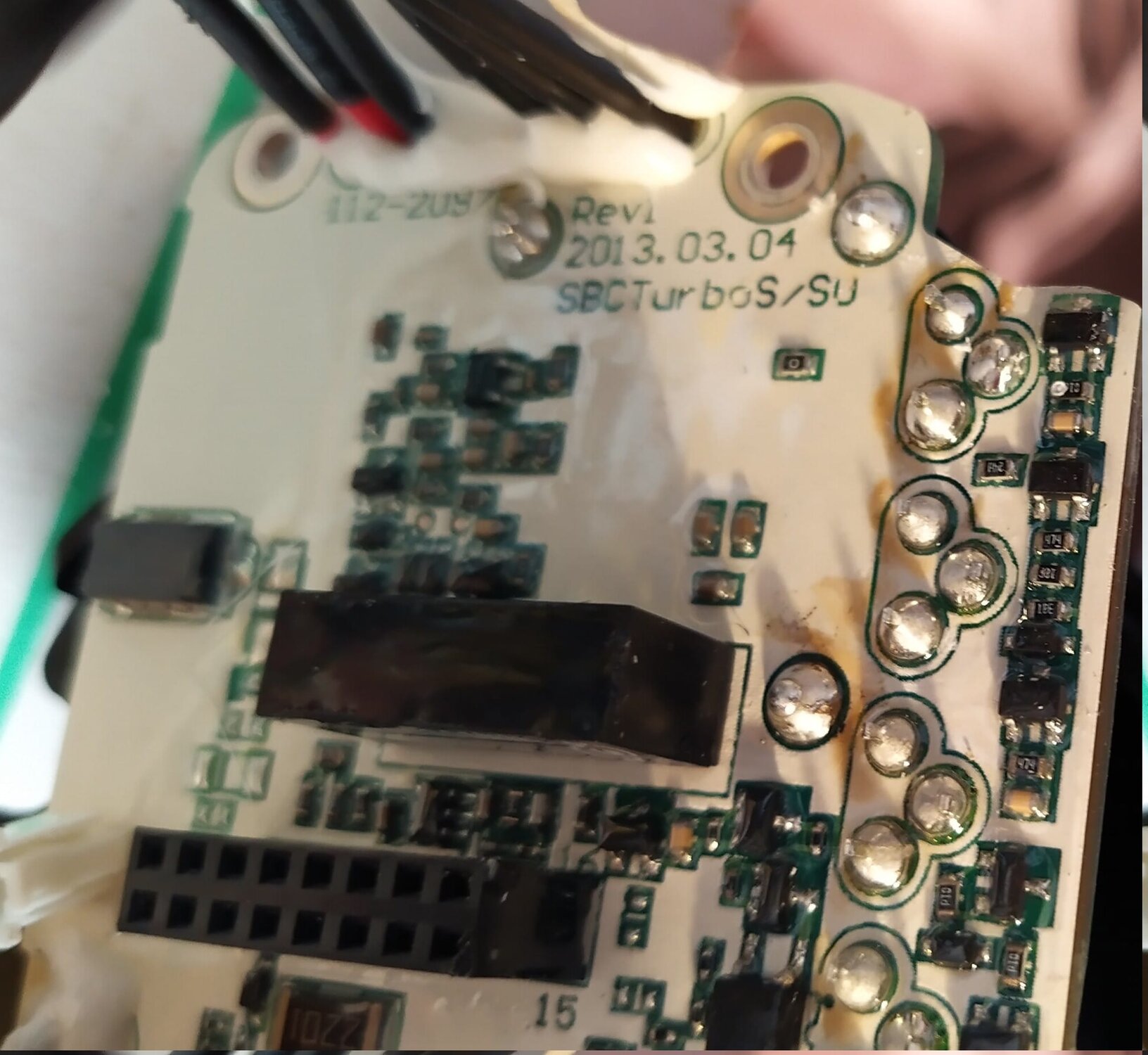

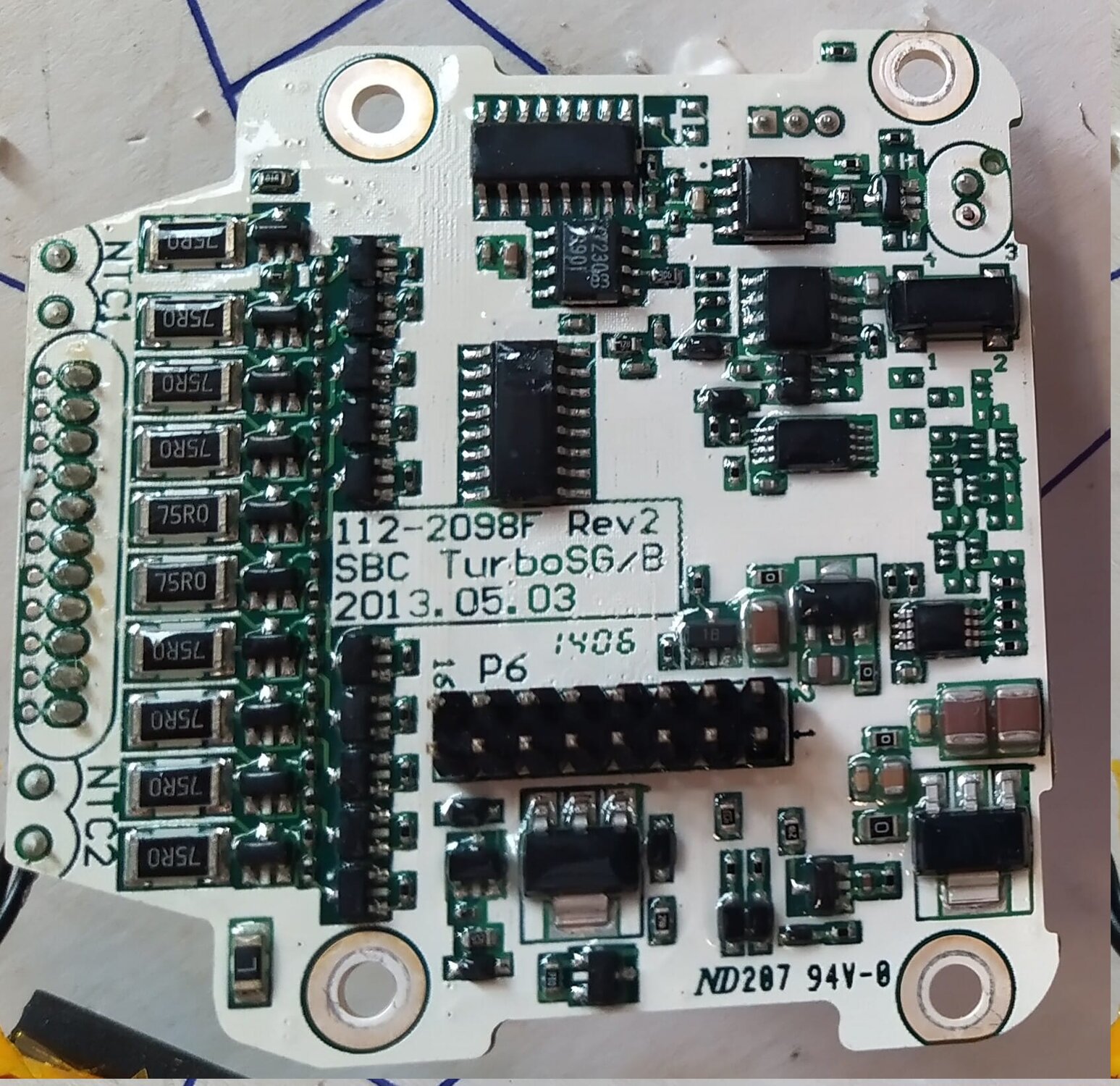

i opened d battery and discovered that if i separate d 1st board from d 2nd, and press d ON-button, battery-test runs and then stays ON. unlike before. i therefore think d 2nd board could have a defect. anybody has 1 in his junk-box? or knows where to find 1? 'specialized' don't have it :(

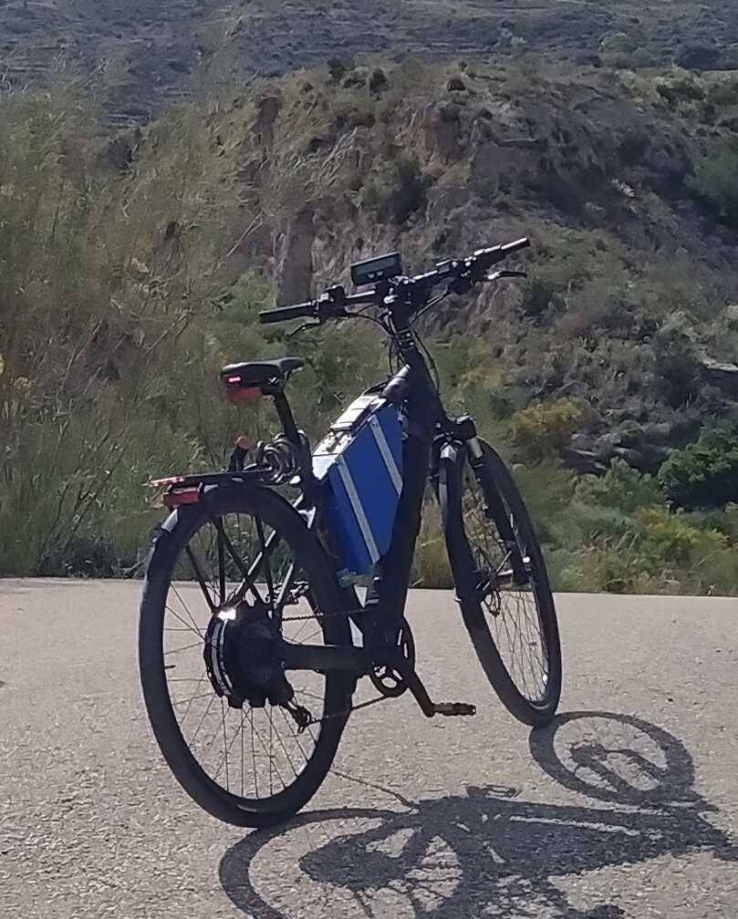

long story short: because no 'foreign' BMS would fit into the original battery box, I finally built a new, 3x larger battery (1.5kWh) and supplemented it with components from Grin and DALY-BMS. Bike now goes, with twist-throttle, 50km/h.
so far so good. a solid aluminum box will be built for the battery at some point. not a priority at the moment, more exciting projects are on the agenda.
Looks like you dragged it from the skip, if you ask me :)
must be referring to battery - well it's a prototype, if it passes d test of (some) time it will be replaced by aluminum. it's not even watertight yet. still thinking of where to better position BMS&controller, probably on either side. also sockets -USB, charging- will be installed, an easily accessible fuse. and probably a BMS bypass switch. lots of things to ponder ;)
oh and i couldn't get regen to work yet, anybody knowledgeable about GRIN-equipment?
