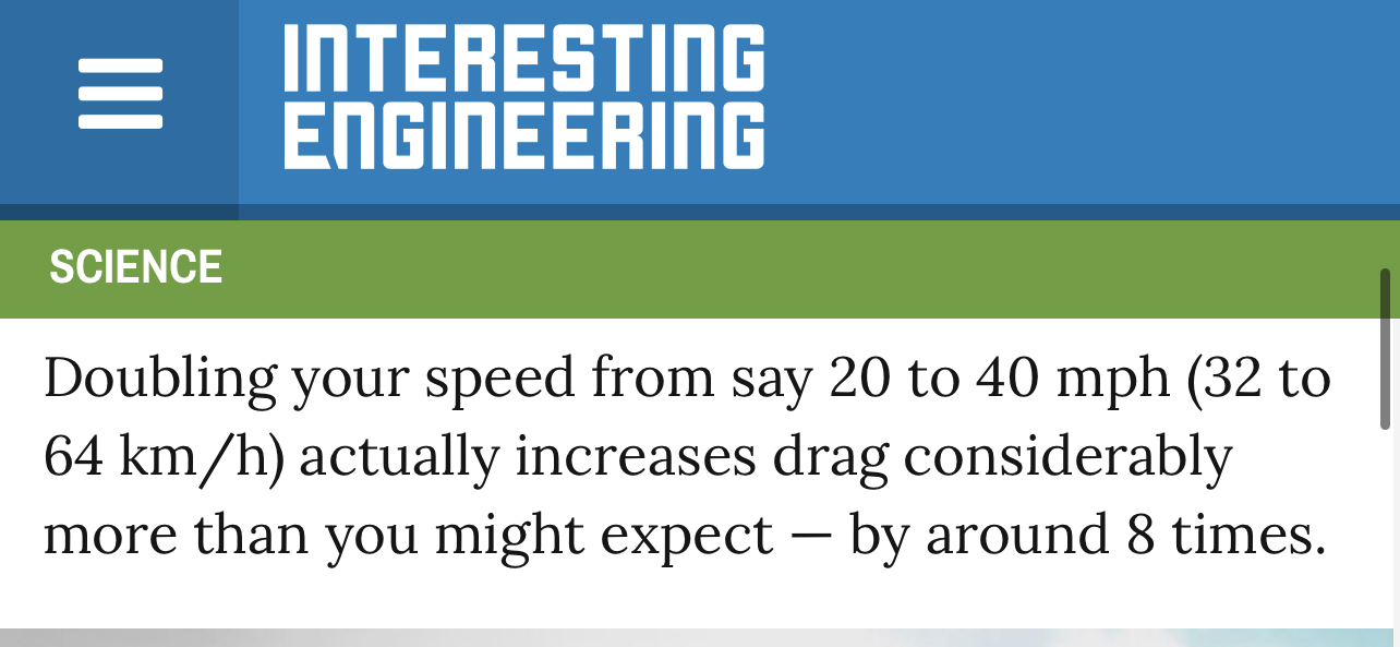

nope. cube. many sources for this - double speed, 8 times the drag. this is why it’s a fool’s errand to try and get a “bicycle” (as opposed to a motorcycle) to go very fast for long distances, particular an upright model with an upright rider. aero road bikes with skinny tires, deep profile wheels, streamlined helmets, riders in lycra etc help greatly reduce the drag, but the relationship to speed is still the same. you’re just multiplying a smaller number by 8 to double the speed lol.

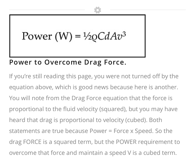

From your source....
As you can see from the equation, aerodynamic drag increases as the square of the velocity. This means that if you double your speed, you will need four times the energy to overcome the drag.
Maybe the 8x includes increases in other forces....friction?? Doubtful it's that much.

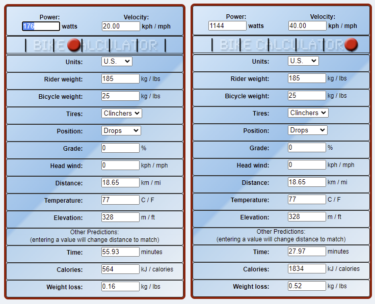

drag force is squared. force required to overcome the drag at twice the speed is cubed. (i agree the text from interesting engineering is unclear.)
one can also plug various speeds into bikecalculator.com to see the results of various combinations, confirming that it's approximately 8 times the energy to double the speed as drag becomes the primary factor. at lower speeds it's quite a bit less, and at high speeds still a bit less because the other factors - friction within the bike, rolling resistance, movement of the body and who knows what else, don't increase as fast. but the vast majority of the work is to overcome drag at those speeds. from 20 to 40 it's 6.5x.
Funny, I went to the same site and got similar results. If you input very extreme speed values you get closer to 8x, as friction becomes less material to total forces. In the real world, simply doubling speed is somewhat extreme, but this exercise makes you realize why road cyclist are hyper-sensitive to a 5mph wind.
Of course, if you travel twice as fast, you cover a given distance in half the time, so back to 4x Wh used by your legs/battery.
very true! and since it’s not quite 8x in practice, it’s probably not quite 4x either, so perhaps 3 times the power per mile to double the speed, but one needs a very high capacity battery and bike to sustain those sorts of power levels, and the proportional contribution of the human rider becomes increasingly small. for a 200w load even a casual rider can easily contribute half, but for a 800w load they’re only contributing 1/8th, so 100w needed from the battery goes to 700w, and we’re back to 7x the battery per mile :eek:
Air drag (force) is the square function of speed. Power to overcome the air drag is the cube function of speed.
You two guys were both right.

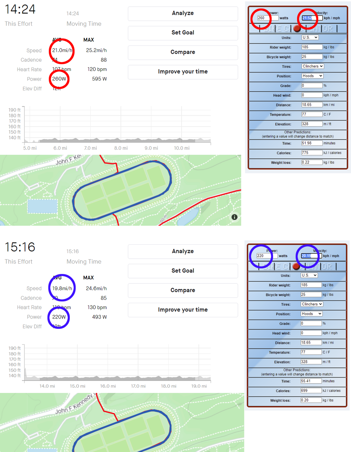

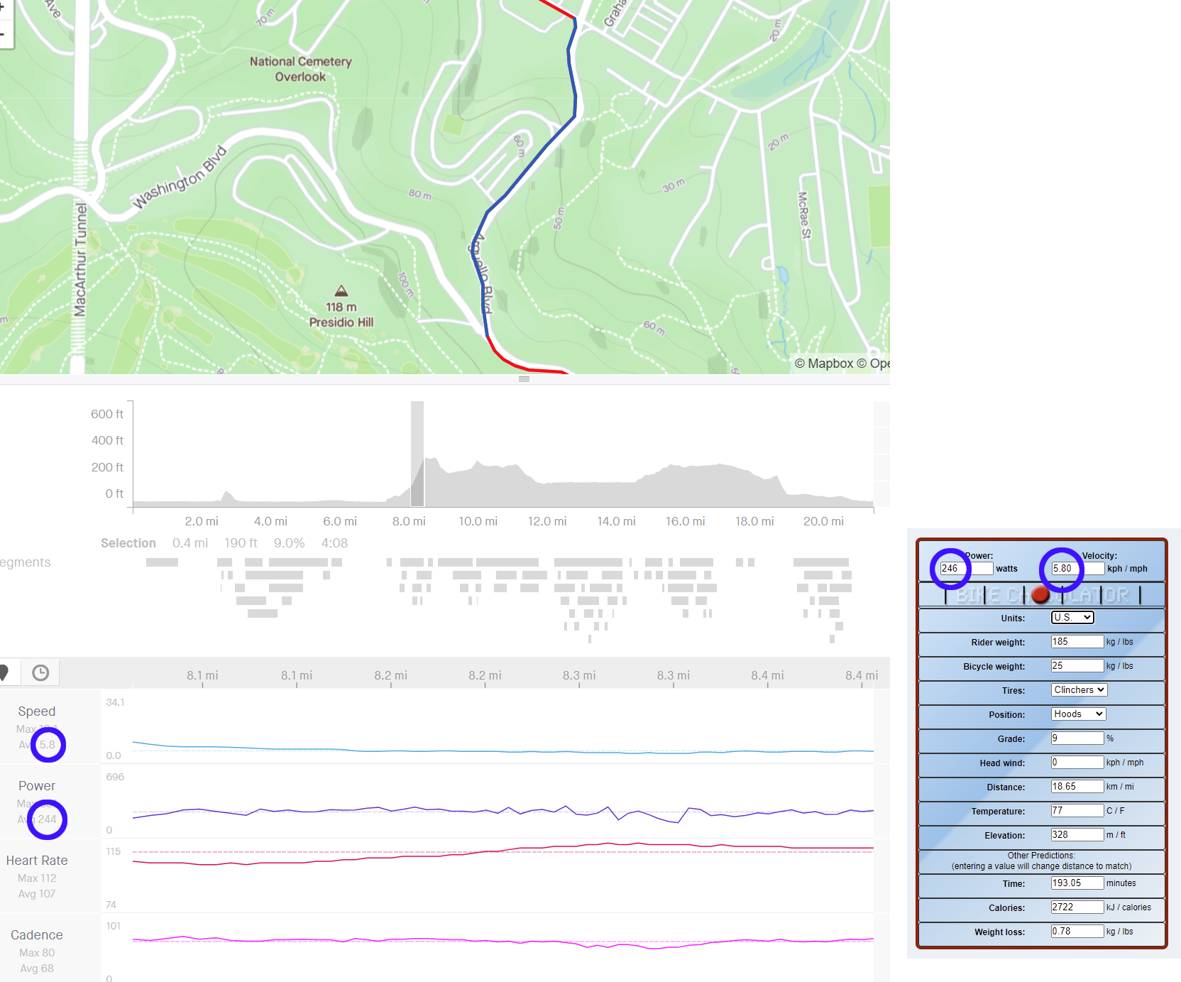

if anyone's head isn't spinning, here's an interesting question: how accurate are these formulas when compared to actual real world cycling?
surprisingly (to me) well it turns out. especially on the gravity (climbing) side. still very good when drag is the main factor.
here's a short climb in my neighborhood. bike calculator prediction based on my speed is that it would take 246 average watts of power to make the climb. actual value recorded by my creo? 244 watts average. a vanishingly small error, especially given a few pounds of variation and slightly inaccuracies in the grade measurements. in this case, i actually doublechecked them against a contour survey of the area and found it within 5%.
the difficulties in approximation get a little more difficult when the subject is drag rather than gravity. here are two 14-15 minute lapping sessions on a public cycle track in golden gate park. since it's a loop, wind is cancelled (although that pesky square/cube function will still penalize wind to some extent, as power used to accelerate faster still with a tailwind is diluted), and in any case it was not a very windy day.
here the prediction is for 21.5 mph and 20.2 mph for the two rides, respectively, and the actual values are 21.0 and 19.8, respectively, ,for an error of a little over 2 percent. given that GPS significantly undercounts distance on curves (bike travel in curves, not a straight line between points around a curve) i'd guess the actual error is more like a little over 1 percent, likely indicating that the power meter in the bike isn't perfect and i have more drag than the bike calculator assumes, which isn't surprising! my bike has 32mm tires and i don't wear lycra jerseys 😅
nonetheless, these three examples are all impressively close to real world measurements. for those who are interested in the subject, bikecalc makes it very easy to predict range and speed for your e-bike rides if you know your human contribution! (for all these rides, my creo's motor was off)

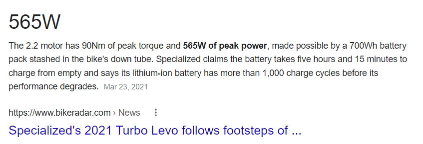

Sorry to hop on an older post. How does torque apply into this equation of understanding assist levels? Also curious around how nominal vs. peak power play into this? I feel like I read that the older Comos/Vados had 500 watts peak power but 250 nominal, the newer 2022 models only list 250, do those still have 500 watts peak?
Torque * rotational speed = power. Therefore the more power at given motor rpm the higher the torque. (We only do not know the rotational speed of the motor).
250 W is "continuous rated power for 30 minutes" that is the mechanical power that could be collected from the motor without overheating it. (It is more legal than a technical term). The Maximum Motor Power or Peak Power is far higher for so-called full power mid-drive e-bike motors. The peak power of Specialized full power motors depends on the motor version (therefore - the e-bike version). Rest assured the Specialized 2.2 motor found in version 5.0 of new Vado and Como pumps 565 W of mechanical Peak Power, with the maximum torque of 90 Nm.
Obviously less torque on the 2.0 motor found in the 4.0's but presumably same peak power?
