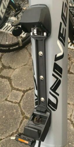

Hello guys. I would like to mount a second battery on my e-bike, and I have been looking for a kit to mount the second battery, but i didn't find one. Do you have any suggestions for one?
My e-bike is powered by bosch 3th generation, powerpack battery. I would like to mount something like in this image, but this mount is out of stock.

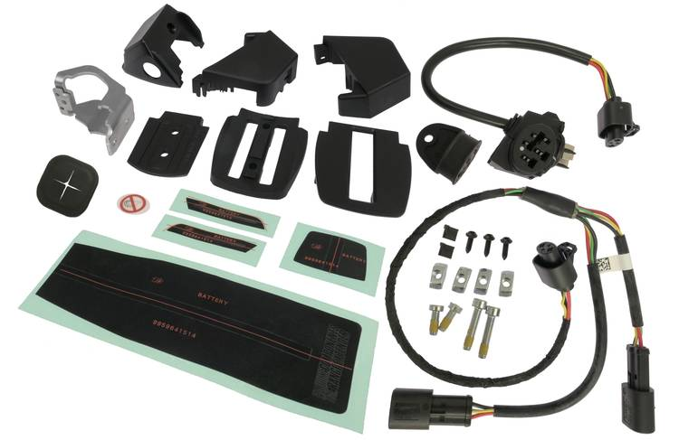

What bike do you have? Many brands have an extender kit available through dealers but they aren't generally sold directly. Here's the kit from Haibike (not available anywhere I can find right now):

My e-bike is powered by bosch 3th generation, powerpack battery. I would like to mount something like in this image, but this mount is out of stock.View attachment 85998

I think that's a powerpack mount, not powertube?
Hello. I just want to mount a second battery, it's not necessary to connect the both battery. I would like something like in the picture I put above. Something to mount instead of the water bottle. I possess this bike: Hercules Futura Gates F8
Without knowing what kind of bike and what kind of battery, it is impossible to offer relevant advice. What brand of bike? What model? How about a picture of your bike so we can see where it might fit properly?
If you have a Bosch power pack that would fit on the mount you showed us, the easiest solution is to pack along an extra battery and just swap it out as needed. The Orlieb E-mate is an excellent choice of ways to safely carry as spare on board.
