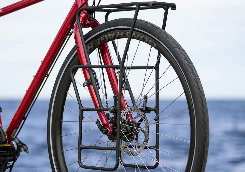

You may be right and I hope you are. There’s a hole in the middle above the front fork, mounts on each fork but none on the top of the fender. So 2 out of 3 I guess. Would be nice if it were the case though. I would love to put the identical Bontrager pizza rack that comes standard on the trek 920.

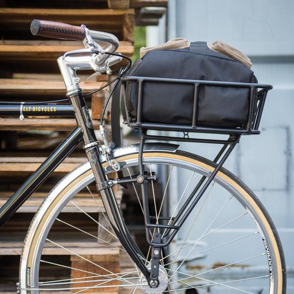

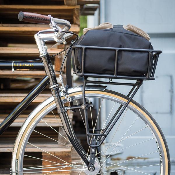

Not sure if this one would work but I like the idea of an old school front basket!🤓

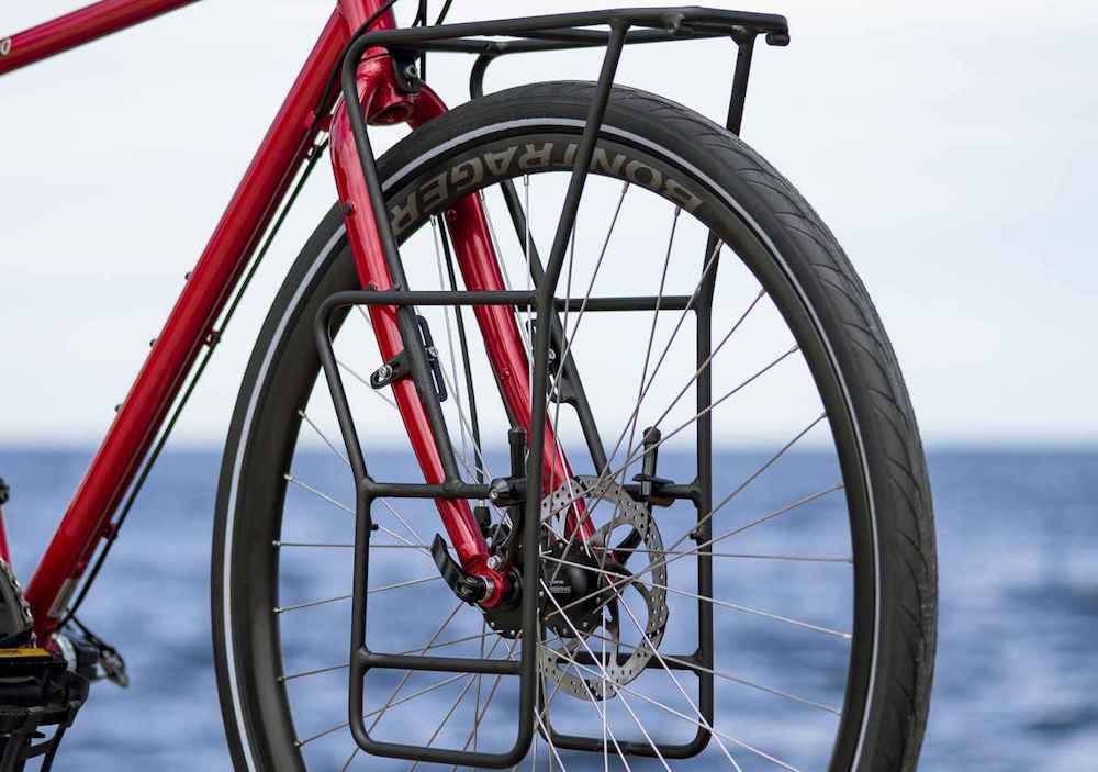

Or this one from Bontrager...
The Bontrager looks like it just might work. I have the pre drilled hole in the middle of the fork and this one only needs the one mount on each side of the fork arms.
I allant solid fork lacks the pre drilled hole in the fender and it seems this Bontrager doesn’t even need that according to the pic. Guess I’ll be calling Trek Samos tomorrow.

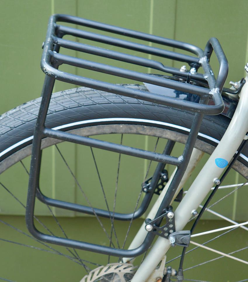

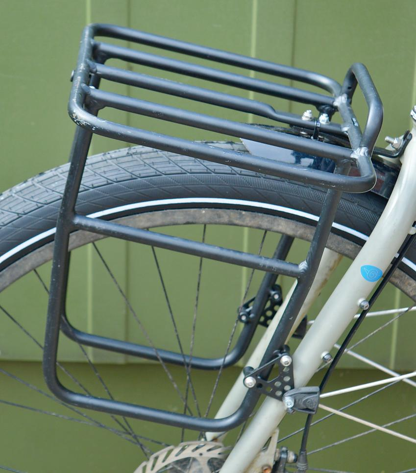

BTW, this one seems a bit “cleaner” and cheaper but has what looks like the right attachment points.
And that’s exactly the bike I was looking at recently that made the light bulb pop in my head. I was going to ask them about that too. My frame is a medium I just hope it’s not too long for my frame.
